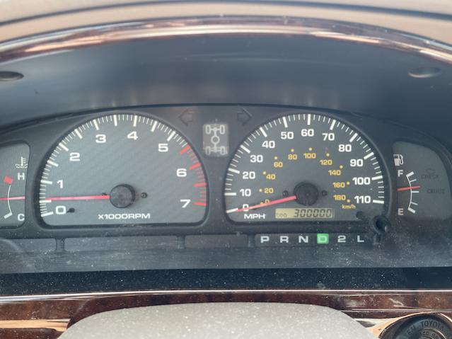

Gave her a bath, a full tank of 93 Octane, and a bottle of BG 44K Platinum after I hit a big milestone. Now if I could just figure out how to update my username to 300K ...
Congratulations on the odo roll and 300 Club
These trucks are actually built to run 87 octane. No real value to higher octane unless your running an SC/boost.
