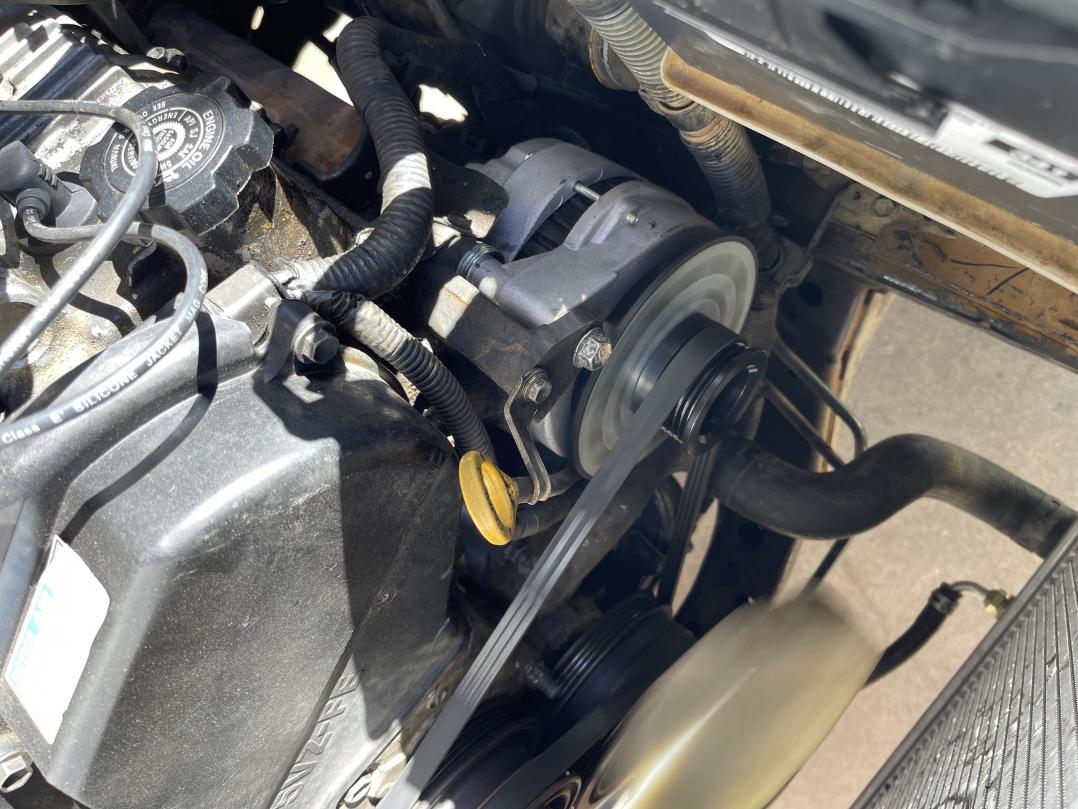

Got the 140A alternator installed today. Seems to work great, and no more squeaky alternator lol.
