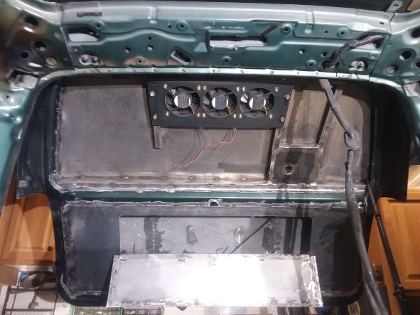

nothing mysterious, just pics of a 3rd gen build out...
Need more photos from further out showing exactly what we are looking at. Also some descriptions would be nice. Most of your photos have been a guessing game of what part we are even looking at or what on earth your plans are.
[MENTION=720569]Rushthezeppelin[/MENTION] If ur good @ bodywork u can come by lend a hand and c the current paperweight as it sits
0 experience with bodywork.... I might be interested in seeing what's going on with it at some point. Looks like I've got my own troubles though, just confirmed I have a rear axle seal leak >< I've got to track down someone with a press and the fancy tool for taking off the ABS tone ring...
