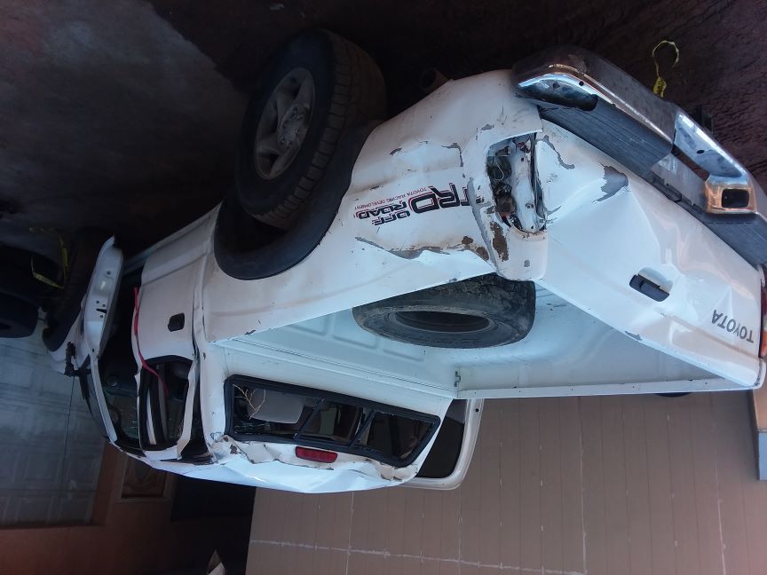

I just picked up my 98 SR5 today, it's got a 5100 shock/strut lift and TRD tires, it's been in a front end collision but I'm fixing it with help of my friend [MENTION=584845]RodrickHeffley[/MENTION]
Hoping to get a build thread up here soon
what're your plans with it?
Model reassignment operation, just haven't decide if putting a 4runner body onto the Tacoma frame (has some rust areas around the rear leaf to frame mount points) or going all the way and using a 4runner body and frame, is better. Tacoma is a 3.4L w/rear 4:10 locker.
