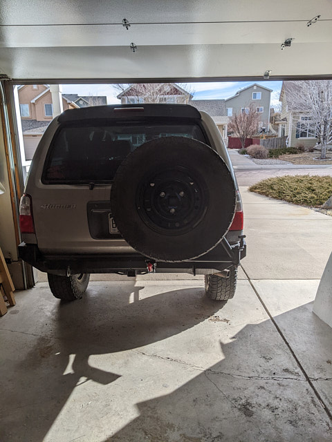

Finally put the tire carrier on
Just welded up my swingout tire carrier from SRQ Fab. I was fairly impressed with how it turned out and it was easy to put together. Anyone have any suggestions for relocating my license plate?

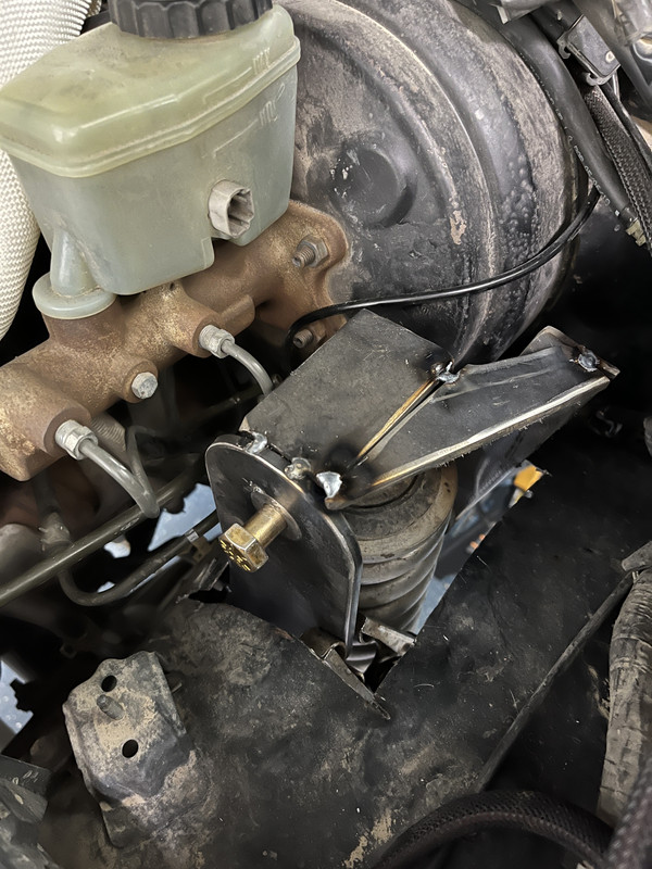

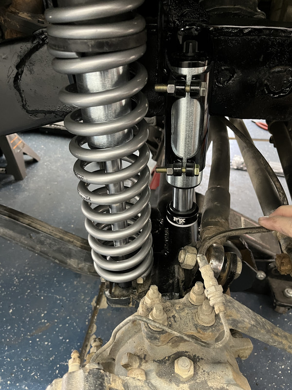

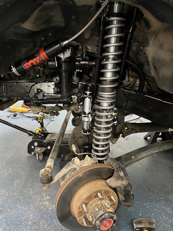

When I did my SAS I kept it really low and only used 10" coil overs. It worked for a lot of years but I was never happy with the ride on anything choppy.
So out with the 10s and in with 14" coilovers (200/300 coils). Also swapped out the OME 890 coils for some OME 861's in the rear.
Adding 2" front and rear plus removing the old solid bump stops with air bumps I now doubled my up travel.
New stuff:
Very tight fit around the booster:
