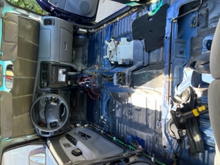

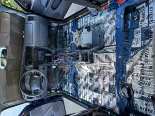

Finally got around to sound deadening my floors. Doors and rear cargo area have been done for a few months already.
