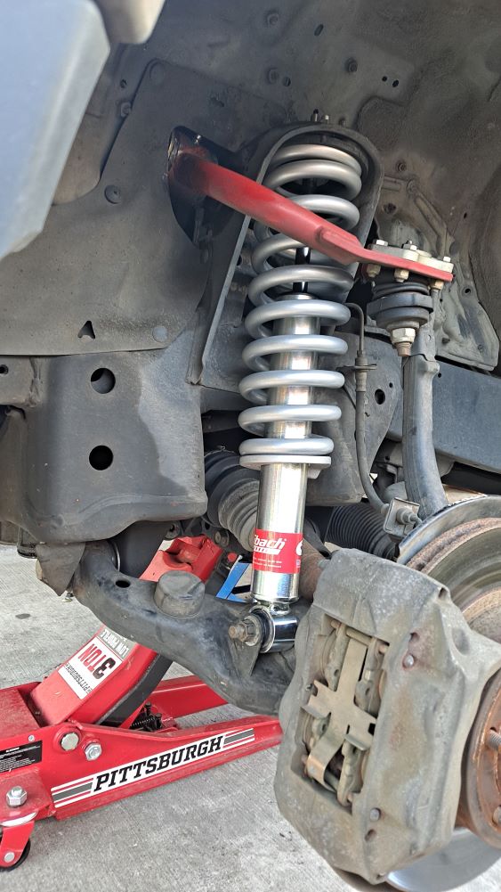

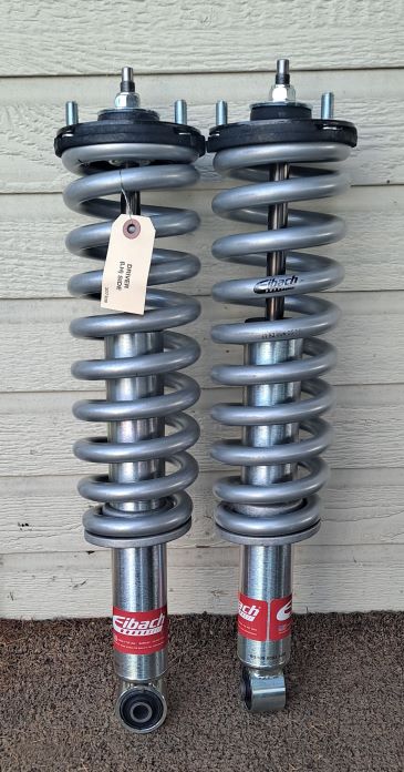

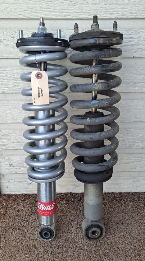

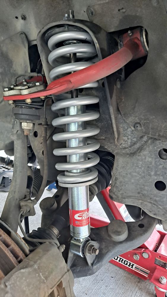

I bought a set of Eibach Pro-Truck Stage 1 coilovers from Wheeler's during the Labor Day sale. They arrived yesterday. I installed them today. I replaced the old Bilstein 5100/TRD Tundra setup that I had on there for 14+ years.

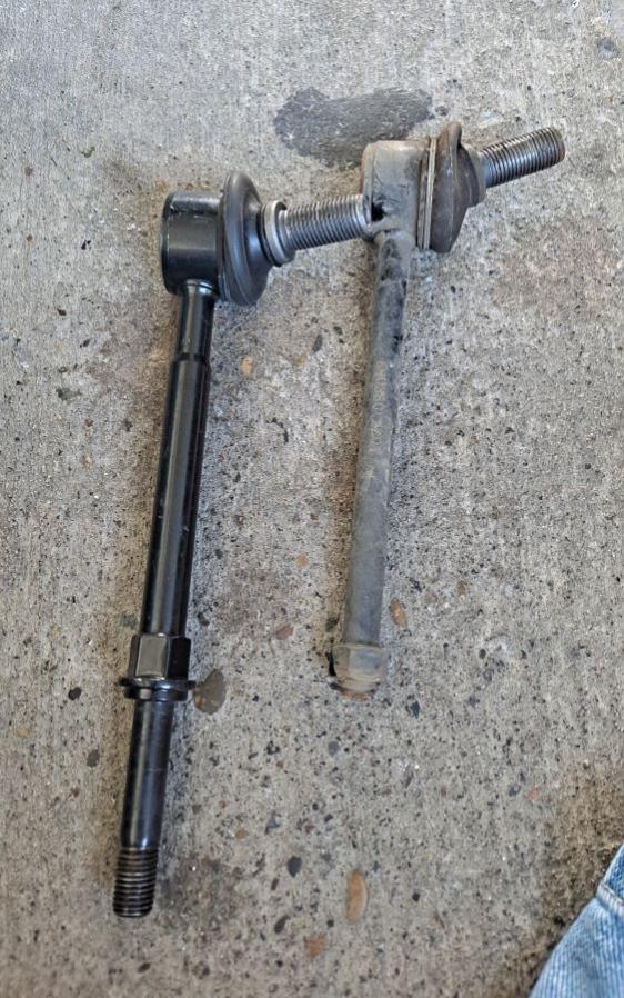

I also found a broken end link on the passenger side. I just replaced both links while I was at it. I had spares on hand.

How's the ride?
How's the ride?
I would say "planted". They soak up pot holes and manhole covers a lot better, plus there is a lot less brake dive now. The old setup was progressive springs with a digressive shock. The Eibachs are linear springs with progressive shocks.
So far so, so good. I'll take some pictures tomorrow.

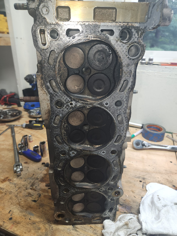

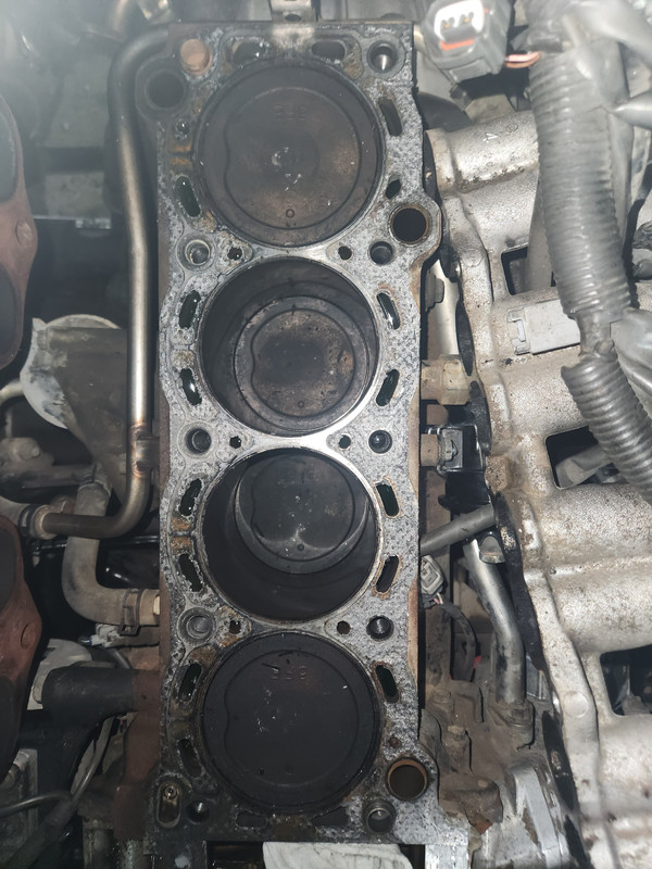

Got the head off today. As suspected, one of the exhaust valves in #2 NG. Going to the machine shop tomorrow.
Gasket looked good and the 2 bores I can see look good.
