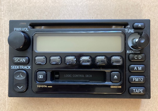

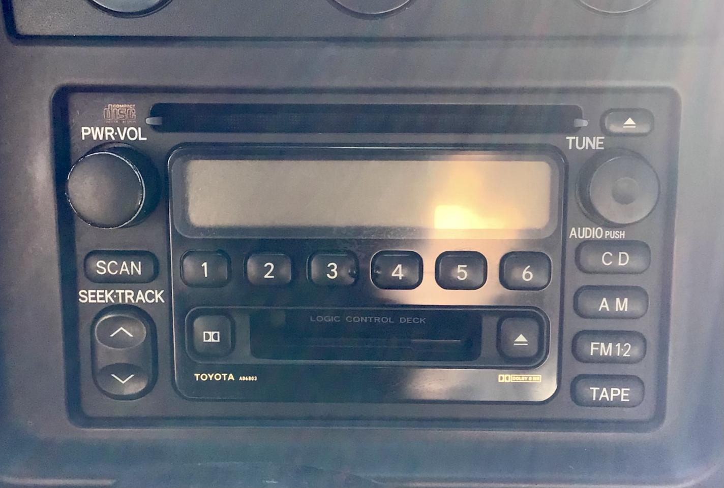

Stereo face plate swap
Changed the front control panel on the stock SR5 stereo unit.

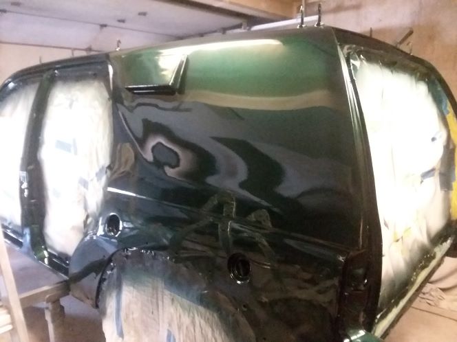

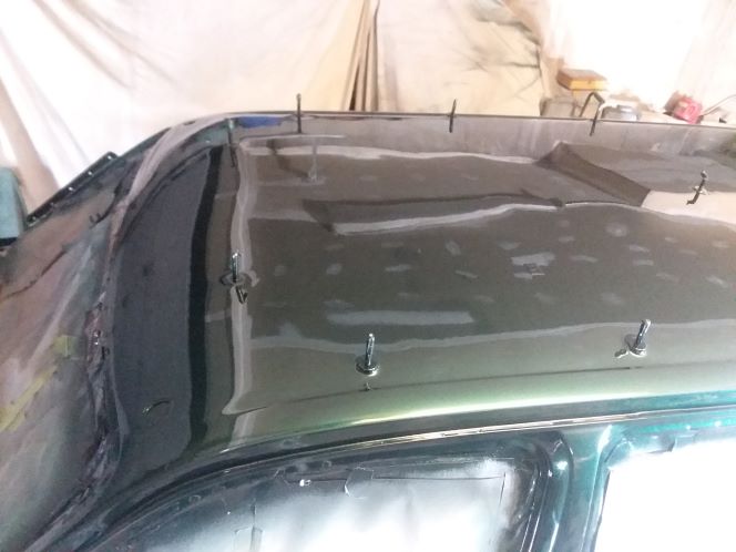

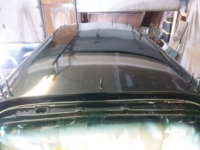

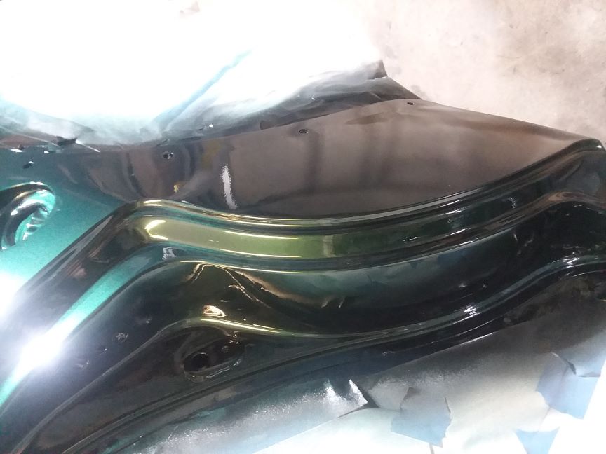

Have some runs and trash that requiring cutting and buffing but ok for a garage paint job and very little painting exp (will probably get pin stripped first day out), can't tell from the outside that it use to have a sunroof.
Yea yea I can see that the sheetrock hanger did correct spacing of screws for the ceiling. :)
Correcting paint I can live with no problem, paint's lipstick on a pig when you think about it.
Quarter pic metalwork telling no tales is a feat in itself.

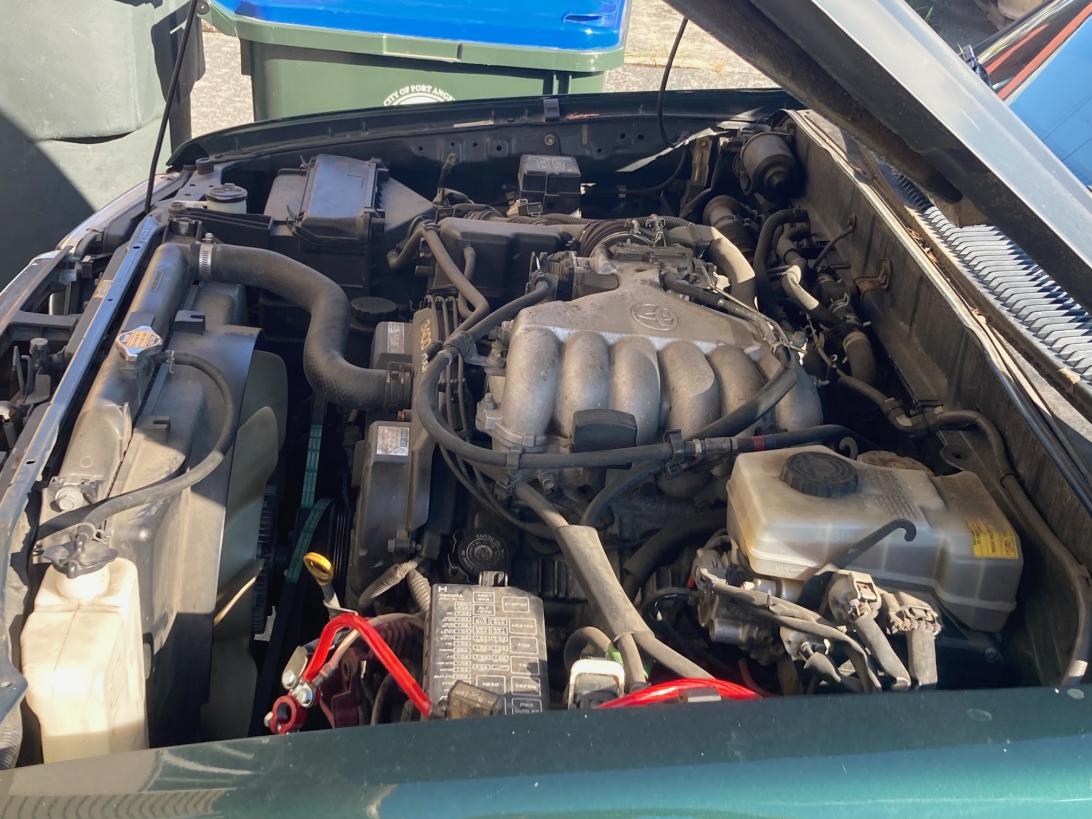

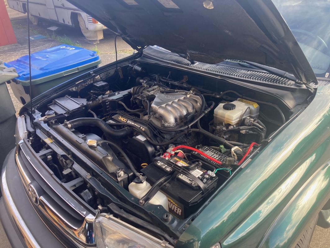

Replaced alternator, replaced spark plugs, did an engine detailing.
