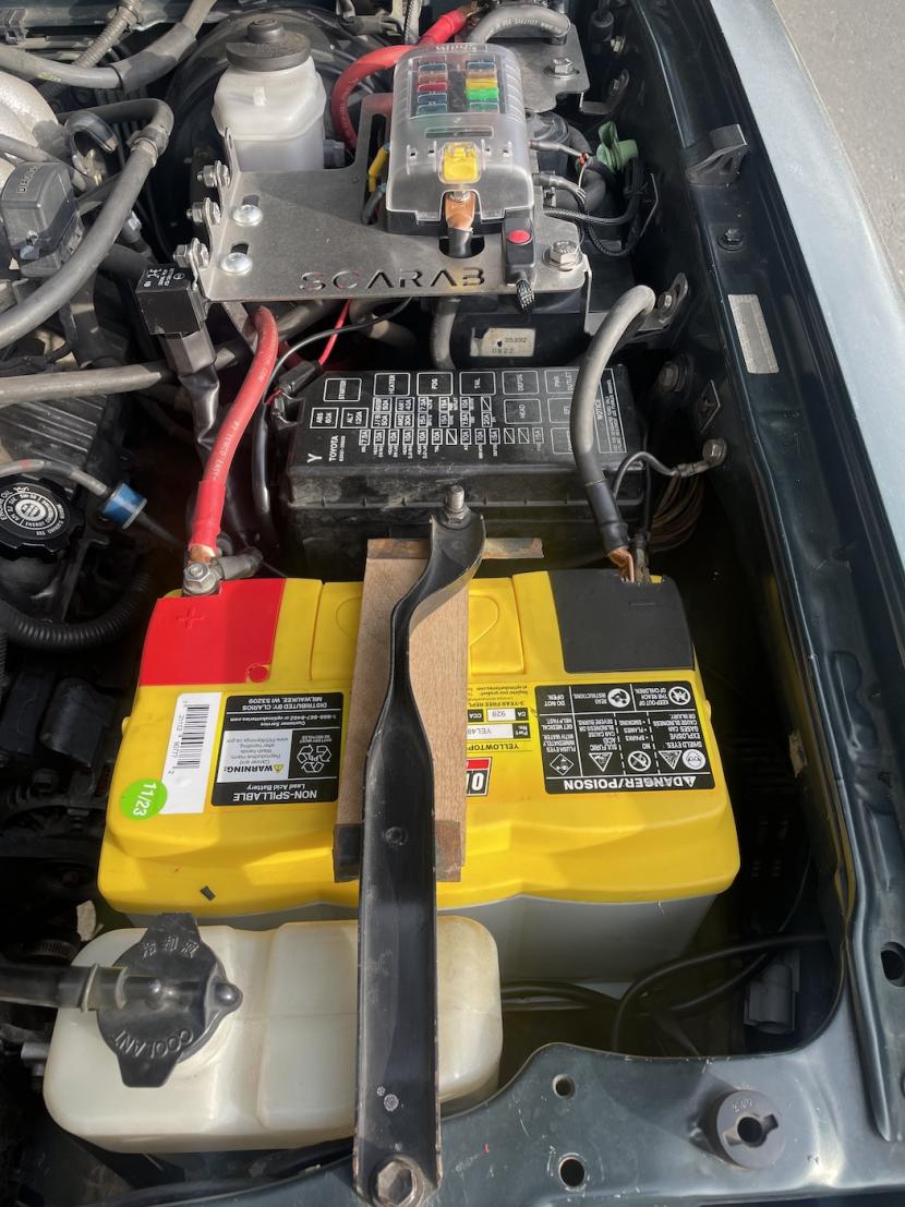

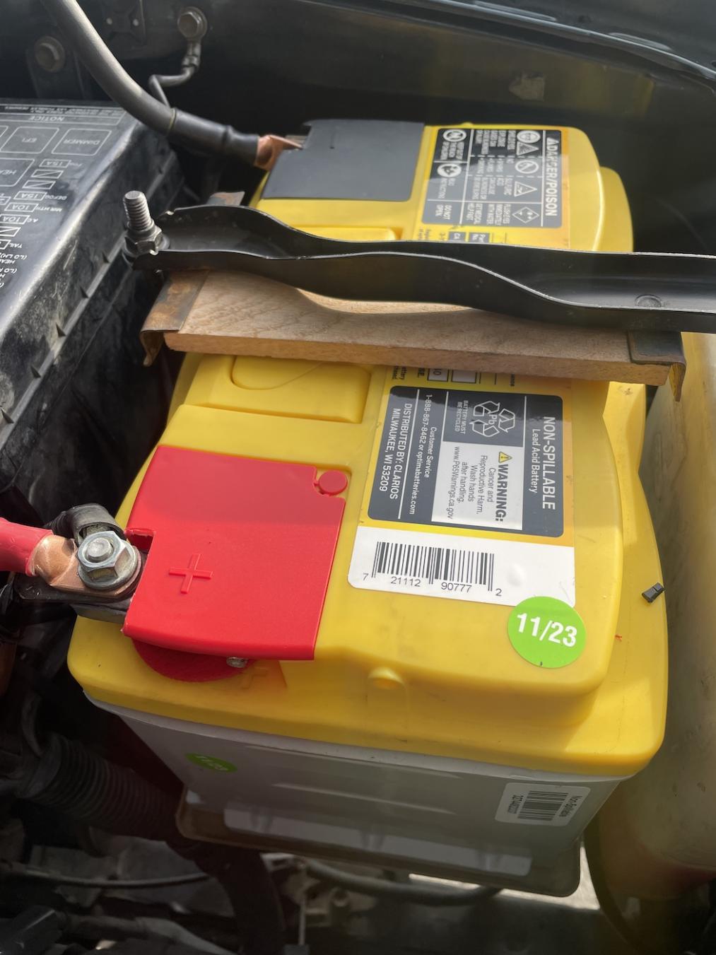

Nothing exciting, but the wife's battery died and to get her to her job I gave her the recent AAA battery from my rig. Her beatdown Lexus also fits a 24F. She proceeded to buy herself the wrong battery so I returned it added $100 for a "this battery does not fit your vehicle, sir" Group 48 (DH6) battery and let her keep mine. I know, I know...Optima this and that, but it's a helluva lot better than the AAA roadside replacement I was running. Fits pretty well - just a bit too short and not a compatible shape. I had a piece of wood in the back that made the hold-down hold down and I trimmed the ridge off the fender-side of what I believe was the original Toyota plastic battery tray and it fits with plenty to spare. For about $100 I'm OK with it. Not done wiring/tidying things but a lunch hour well spent.
800 CCA
928 CA
140 R
#group48battery #DH6battery

Are there issues with Optima batteries? I've heard they're decent and worth the money
I think they are perfectly good, well-made, and are heavily abused by numerous motorsports teams. There was grumbling several years back when the company was bought by Johnson Controls (renamed Clarios) and all battery production was moved to Monterrey, MX. Maybe there was a quality decline but nothing a punter like be would notice. Unfortunately, I am prone to 'upgrade' everything I get a chance to. I posted this mainly to let people know a Group 48 'fits' since I haven't read anything about them in the forums...

like the specs of that battery
might do that b4 next winter

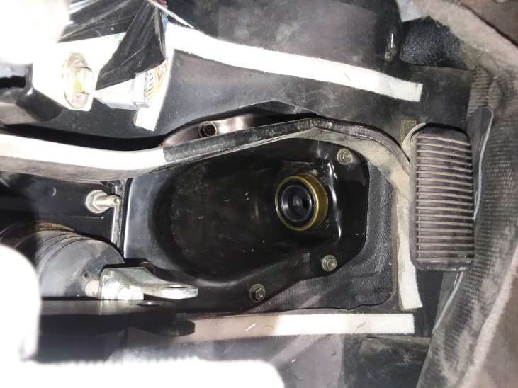

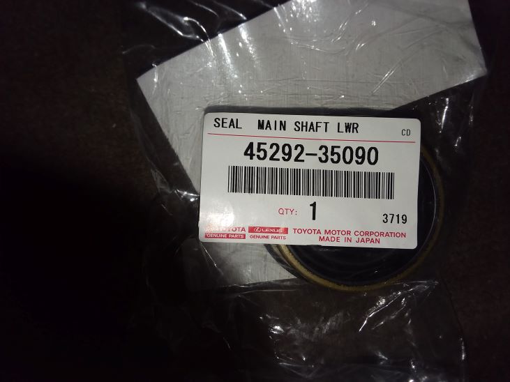

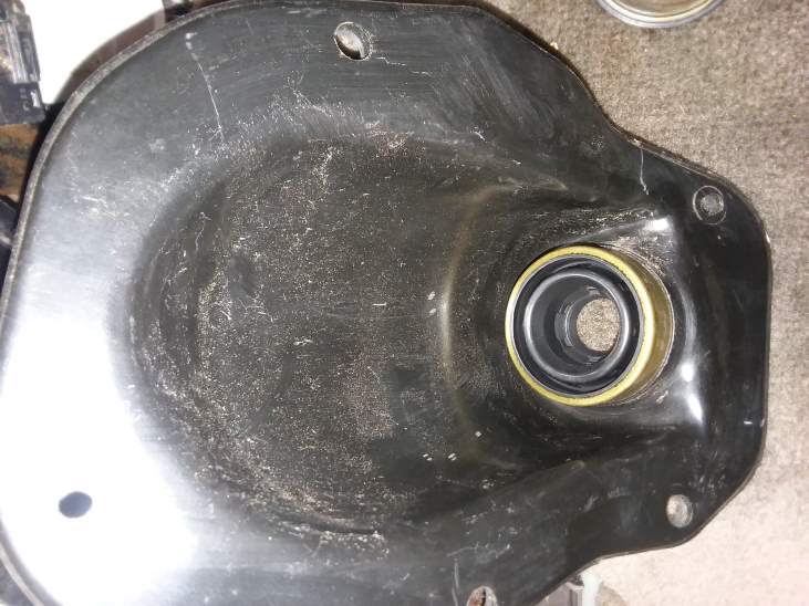

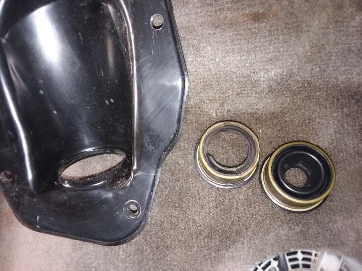

Nice! Wish that seal was still available for the 96.
I was able to borrow some stuff out of an '02, but not that. Was planning on using the u-joint too since I was messing around with it, but they're also different. The 96's turned out to be in good shape, better than the junkyard '02 u-joint.
