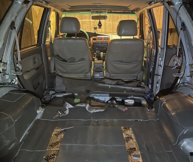

Sound deadening complete
Finally finished fully sound deadening the car. Removed all the interior and panels to installed the deadening materials. Used Kilmat, foam, and mass loaded vinyl for the interior floor. Just Kilmat and foam for the doors. This project was one of the most time consuming of all the mods I've done, but worth it for the ultimate build.

The doors and the trunk take the longest. Unlike the floor, you can't use full sheets at a time, with lots of cutting for the doors. For the doors, I used kilmat and foam inside the door and on the front when you remove the door panel. Lastly, I used foam on the back of the door panel itself. It took me around 3 hrs per door. I will get a pic for you to reference.
As for the MLV, I've had it the whole time, so I don't know what it would have been without it. I wanted to go all the way with the sound deadening, so it was a must. It was super easy and quick to install.

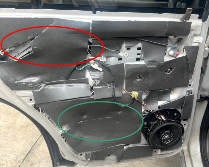

Here is a picture of the door.
In green is the access hole you'll use to put the sound-deadening inside the door. I covered it once the inside was completed; I also removed the clear plastic sheet that covered the front of the door. In red is an area where you need to be careful that the back of the kilmat does not touch the door mechanism. I had to go and fix this later.
I appreciate the detailed picture, it doesn't look too bad but I know it was time consuming.

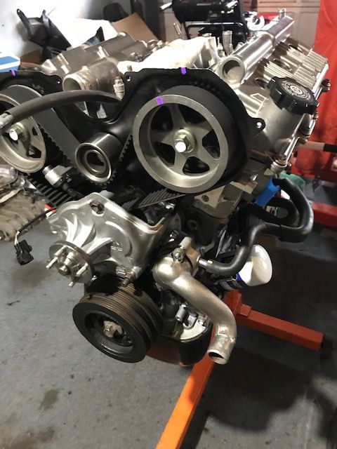

I maybe can post something everyday, as am in the process of a powertrain rebuild of a 99. It is turning out to be WAY MORE work than I bargained for!
This " hencho en Mexico" unit is waiting to be installed. Mated to a fresh trans. But first some "undercarriage restoration" ala TGF above. Maybe spring before that engine gets fired!
So clean and shiny :photo:
Where's the supercharger at?? :lol:

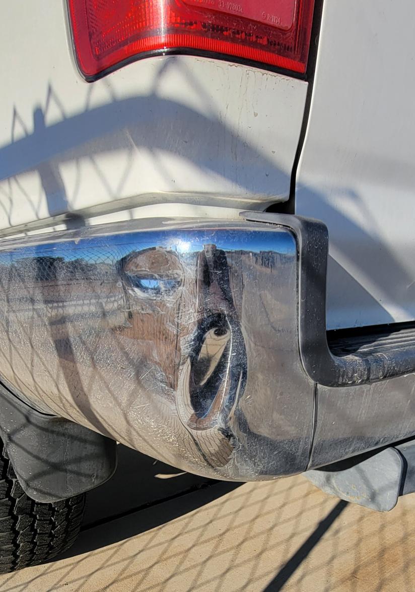

Yesterday, somebody in a parking lot got me 2 brand new bumper dents for Christmas. I didn't want them, I don't want to keep them, and I really wish I could give them back but, I didn't know I had been given that gift until 20 minutes later as I walked out of a different store and approached the 4runner from the rear this time.
The really great thing is I saw the lady who was parked next to me standing in front of her white SUV looking at her car and when I walked from the front and went between our vehicles to get in mine, we locked eyes for a second or two and she promptly jumped in hers and left. These aren't the only dents in my 4runner BUT, they are the only ones that have been acquired since I've owned it. I know its not a huge amount of damage and can be fixed pretty easily but, its the lack of accountability and principle of the whole thing. Its principalities in this.
Merry fuxking Christmas...
