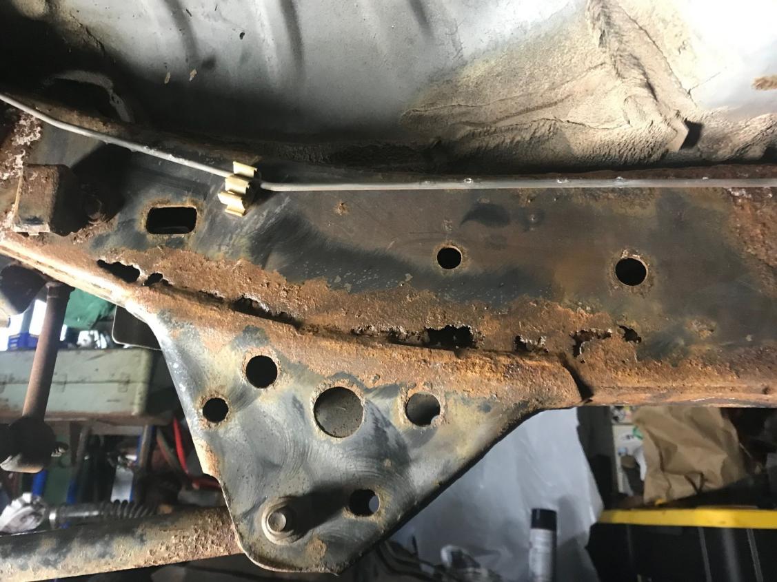

was thinking of replacing those during my '99 resto. Decided to forgo that as they looked ok, but now i may...is Amiyama the place to go? Anyway, have to open another phase of this resto up.....found this during needle scaling of the rear frame. I knew there was some "chooch" lurking behind that tank. My handy dandy POR15 rust sealant wont fix that!
I DID NOT expect this. Now instead of finishing frame prep for powertrain reinstall, i have to pull this baby back out to the shop where the 220v TIG machine lives. :( Son is a excellent welder fabricator thankfully. We will get it right. It will be a YEAR since i picked up the reman 5VZ until it fires up! DANG IT!

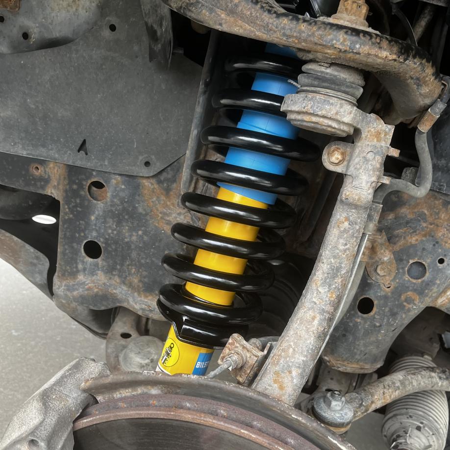

Installed some Bilstein 4600’s with moogs on the front and also new inner and outer tie rods saturday.
The front is definitely higher than the rear now even with the new shocks in the back so I have some 906’s on the way to even it out. Looking forward to finishing up this suspension work.

Not to be pedantic, but shocks (not a coilover like the front) have nothing to do with ride height. Springs hold the vehicle up, shocks control the mothion of the springs. Bushings also play a role in control, especially in the rear, but those are the basics. 906's should lift up the rear to a good height and deal with a load far better than the stock springs ever did.
The Moog front springs are taller than the OEM '99 talls - what he is experiencing is normal... especially if the rear springs are still stock.

so factory talls ( highlander) sit 1 inch higher than the non talls ( non highlander)
moog sells the stock height and also the talls
so are the stock moog taller than OEM talls, or the moog talls higher than oem talls

I don't know the specifics, but the post referenced has no model years, and other years are lower from the factory than '99, even the 'not-tall' '99's. (my '99 2WD was over 20" hub to fender lip with the factory suspension/weight, even after 15+ years)
The Moog PNs that float around here are generally for the "99 Tall" version, so that's my assumption as to what was purchased.

I just went through the same thing and had the same exact spot rust on mine as well. Can't see it because the gas tank covers up most of that side.
Make sure you blow out as much rust and debris in the frame as you can before repairing that area. Then when all is said and done, spray a lanolin coating on the frame like Fluid Film or Woolwax to prevent rust.
You can see it in this thread I posted: Gas Tank Replacement Journey
