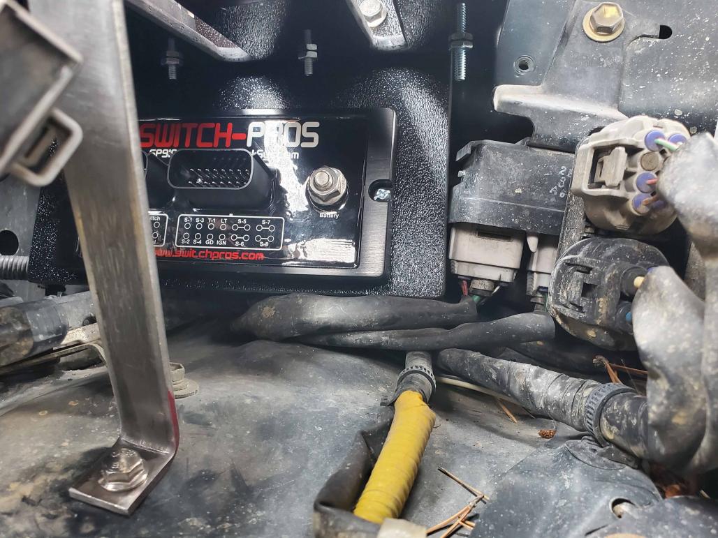

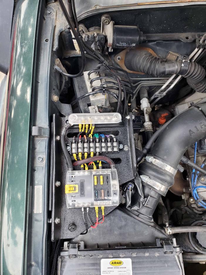

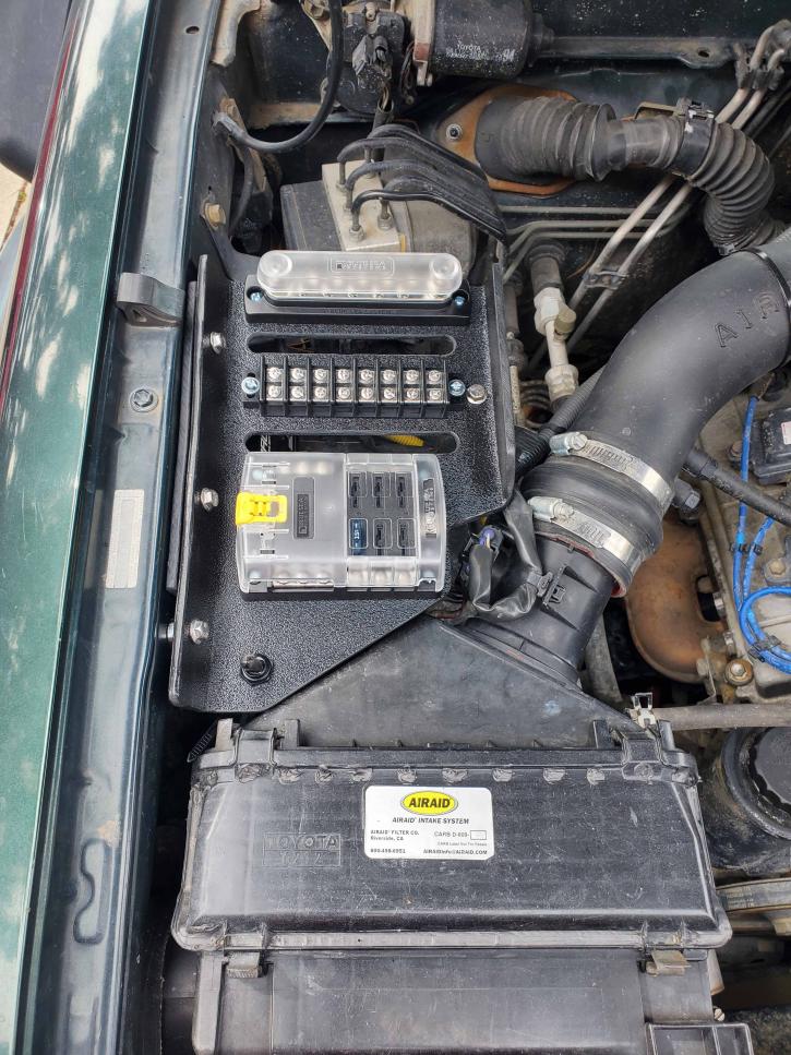

Been working on my switch pro mount and electrical panel for a few days. I ditched cruise control to give me more room as i dont use it. I had a spare cruise control module and cut off the male connector to seal the stock connector up. It's made from 1/4 inch abs, heated it up and bent to shape. No breakers, all main power fuses will be on the battery, which is a Odyssey 27f, just got to install it. Still have to finish wiring up the lights/winch/big 3 but work has been horrid at scheduling consistency. Also installed spc rear lower links, rago ditch light brackets. Still need to fab up a rear swingout. Also picked up a arcworx outboard shock relocation kit. Now to start saving up for new shocks/coilovers.

Dang, I wish I thought of that back before I wanted to sell the truck. Never once in my life have I used cruise control, to me it's a useless accessory
I will never use cruse on my 98 this is a great idea.

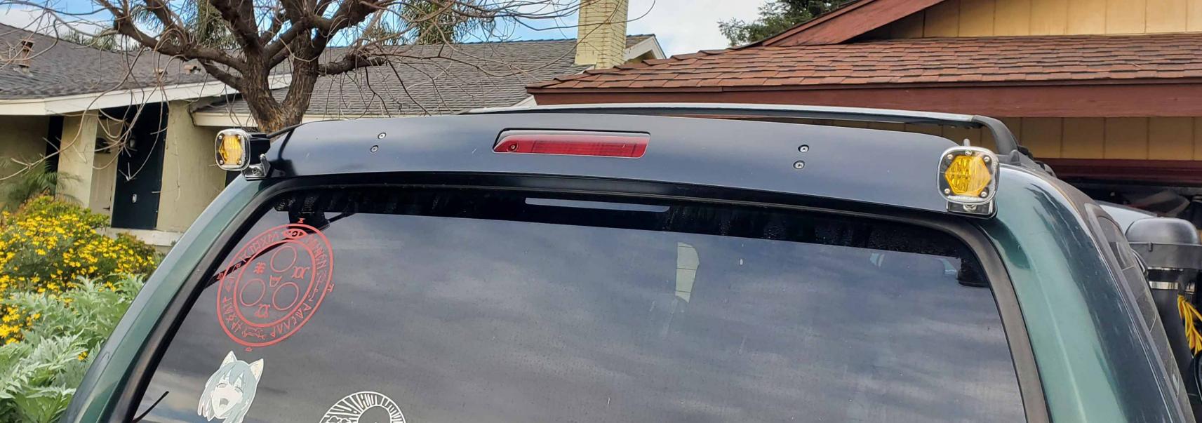

As for what I did the other day. I'm almost completely finished with the wiring and other electrical stuff. Due to work schedule, progress isn't steady. But I got all my lights wire up and checked ked. Got all the temp stuff I did years ago remove and moved over the the permanent set up finally. I dug out my freshly rebuilt 200a cs144 alternator. So next up is finish the fuel pump wiring and kill switch stuff. Winch and big 3 are left.

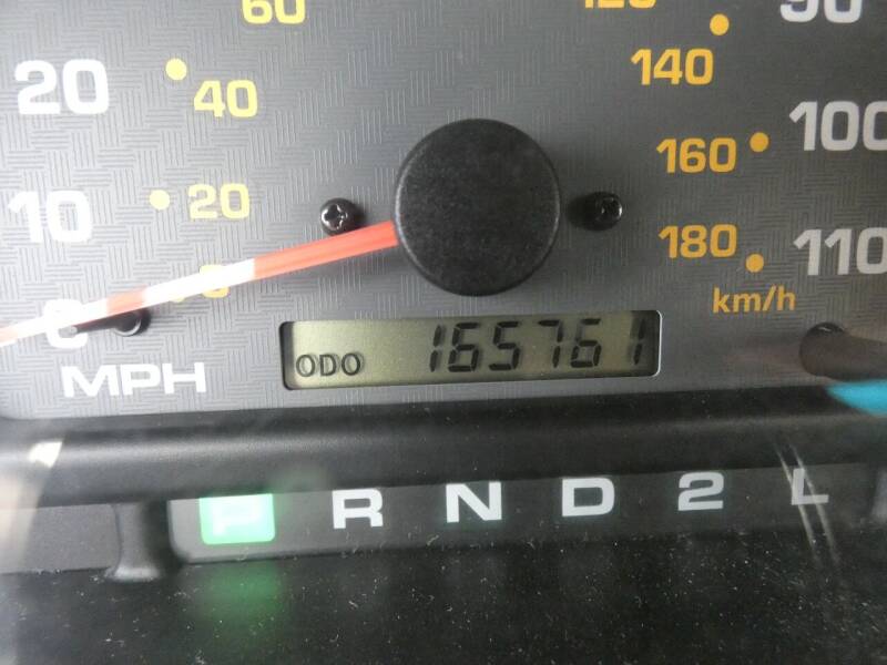

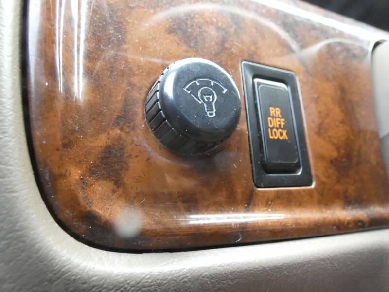

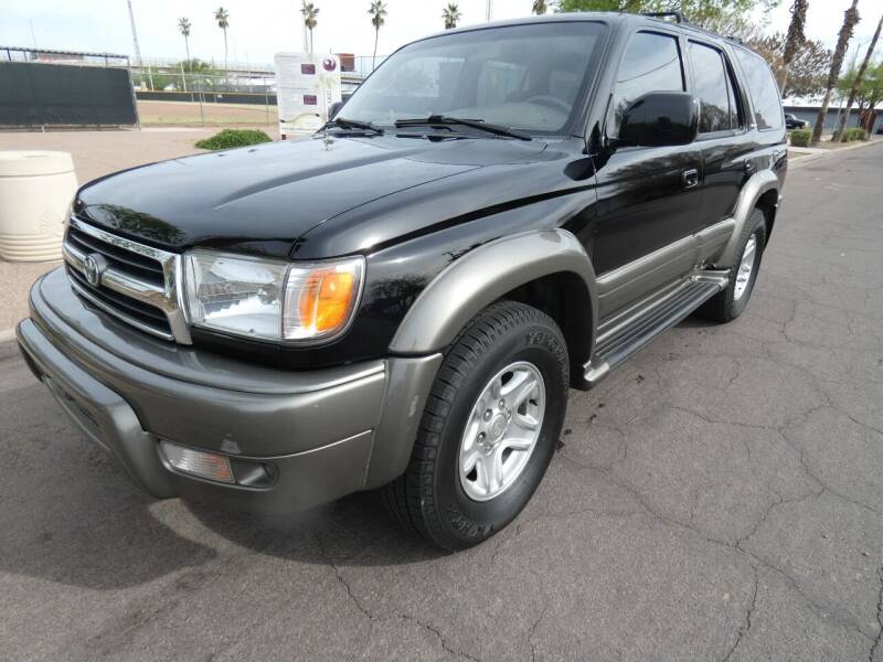

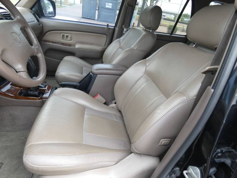

Say hello to my new friend.
2000 Limited, 165,761 AZ & CA miles. Clean, clean, clean. The pre-buy inspection showed no issues. I think she's a beauty! Now off to buy a new buffer to keep that black shiny.
