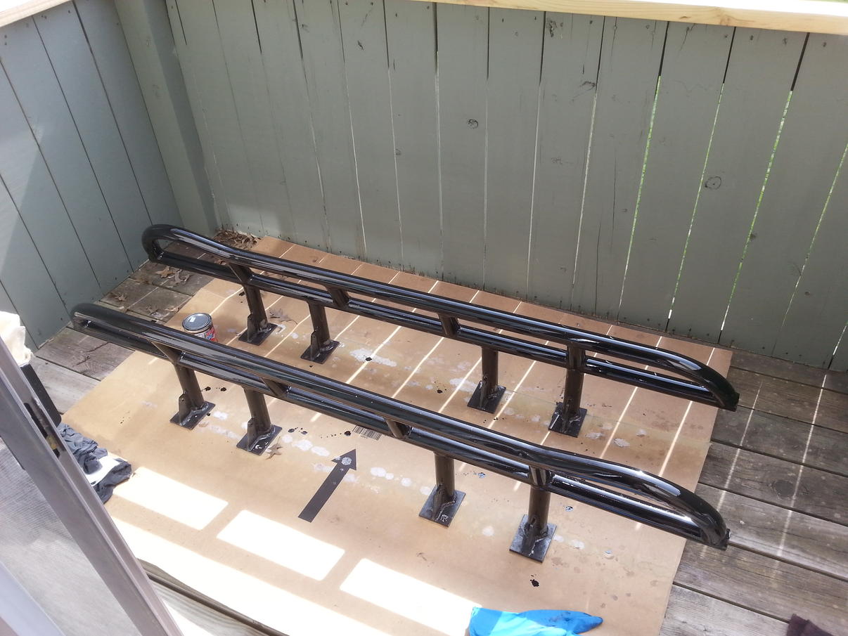

POR prepped and started painting my sliders. Messy. Still not done and now I can't finish due to Al Gore's winter storm he sent to punish us. Too cold for paint -

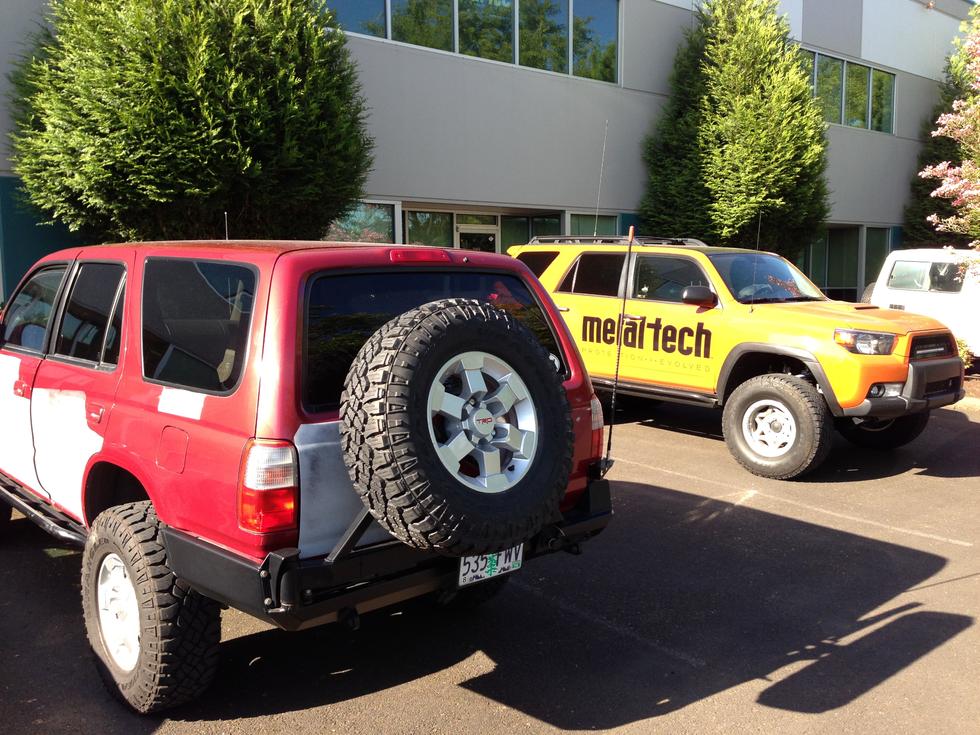

Drove mine over to Metal Tech off road to talk to them about doing some work for me.
Very nice guys.
