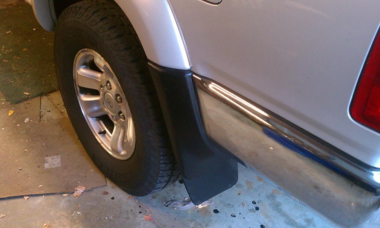

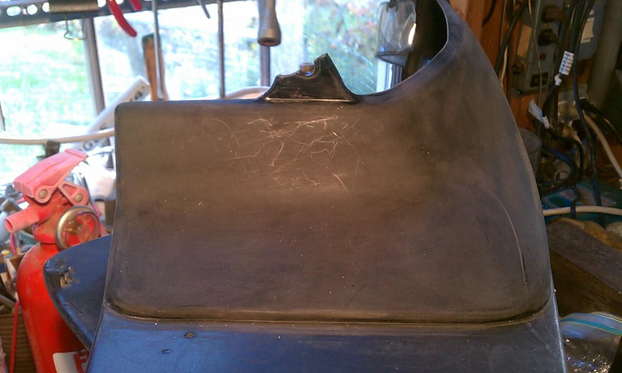

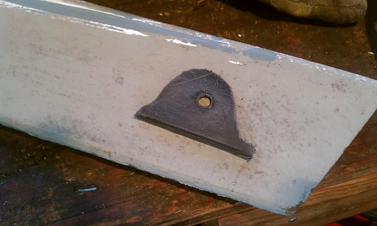

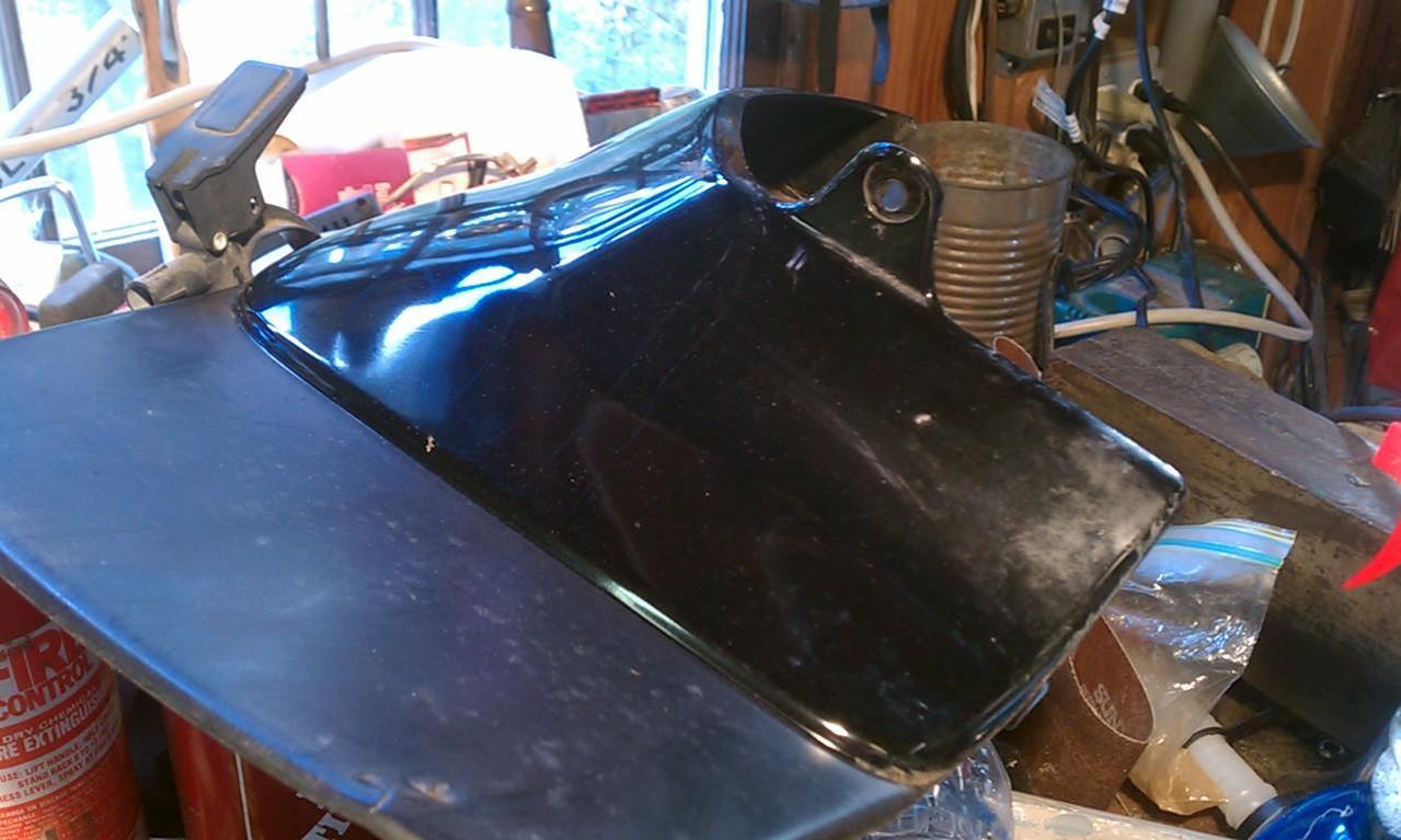

bought the mudflaps here a while back - they were glossy black & one of the mounting pieces was broken off. 200 grit/400 grit wet dry made them nice and matte. Hot glued on anuther piece works ok so far.

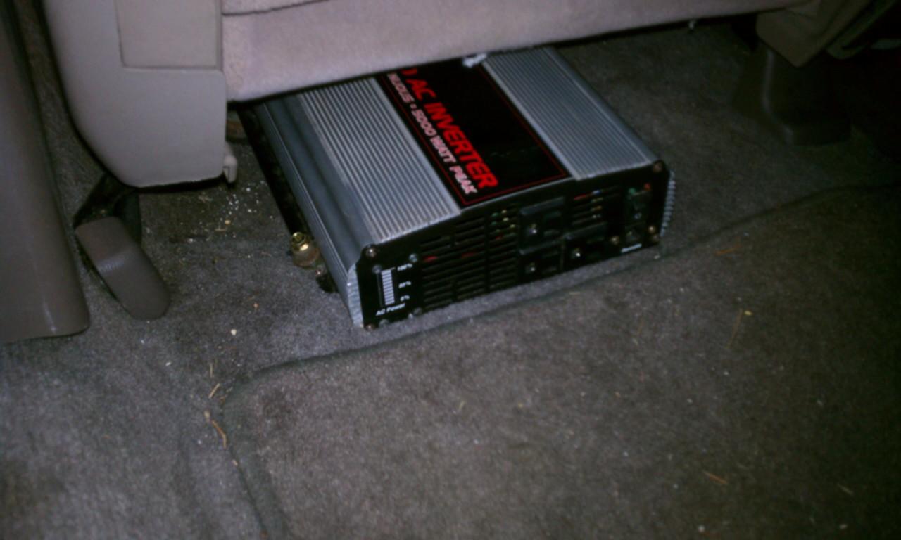

The inverter is great for drill & coffee maker : )

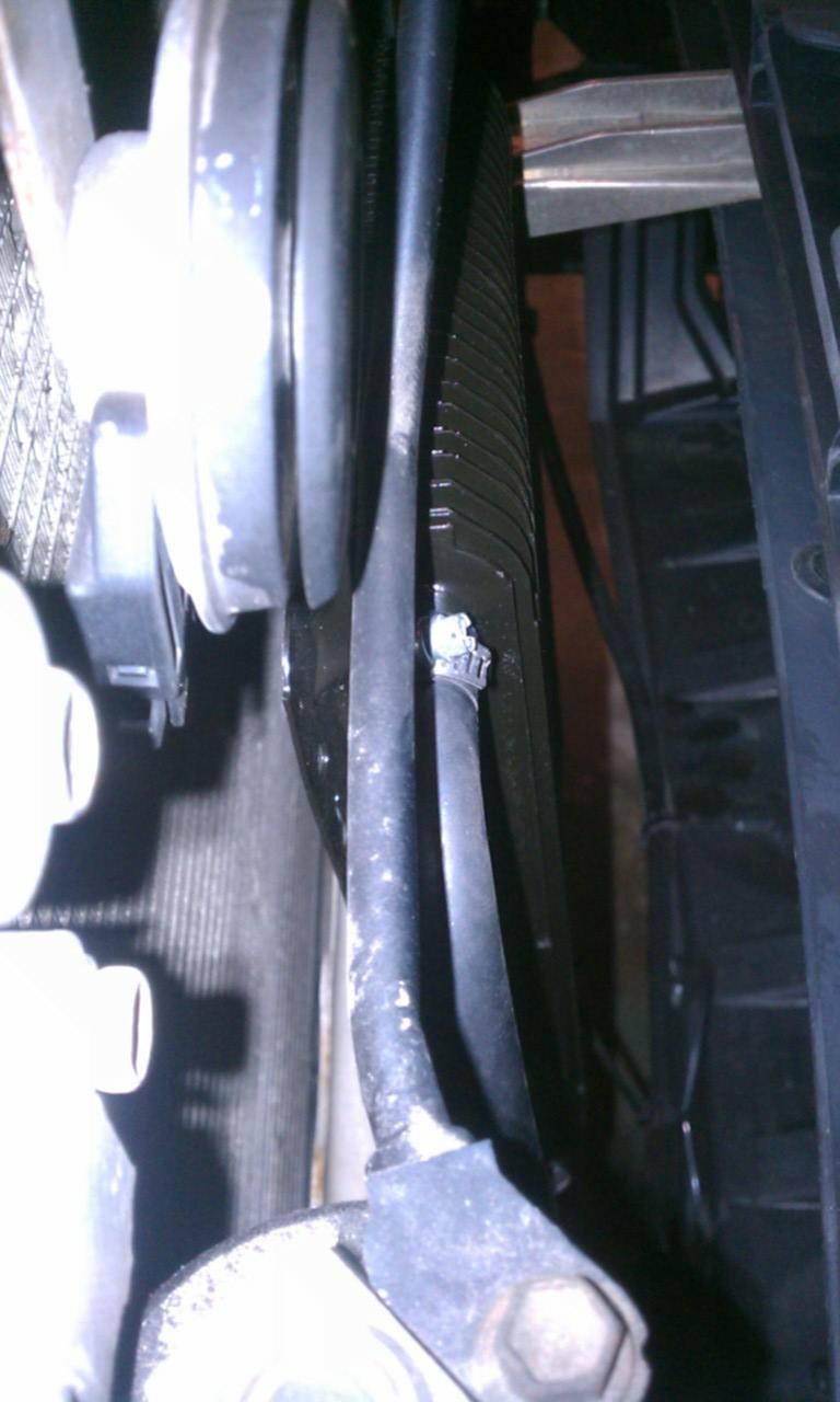

My PS pulley seemed to be catching, I was getting bad vibes at slow speeds. I had the Wife turn the wheel and I could see the pulley stop/hesitate. I figured it was from mud/debris from my recent off roading trip. I sprayed some Fluid Film in/around the pulley seems to have helped. I didn't see any signs of leaking fluid and level was good in res.
installed front mudflaps. removed green covers from climate control bulbs. looked for and found transfer case breather. Doesn't seem to be unscrewable like rear one, so not sure how I'll add extension tube. Scraped dried mud stuck on inside rear rims, see if it reduces a recent highway wobble shimmy.

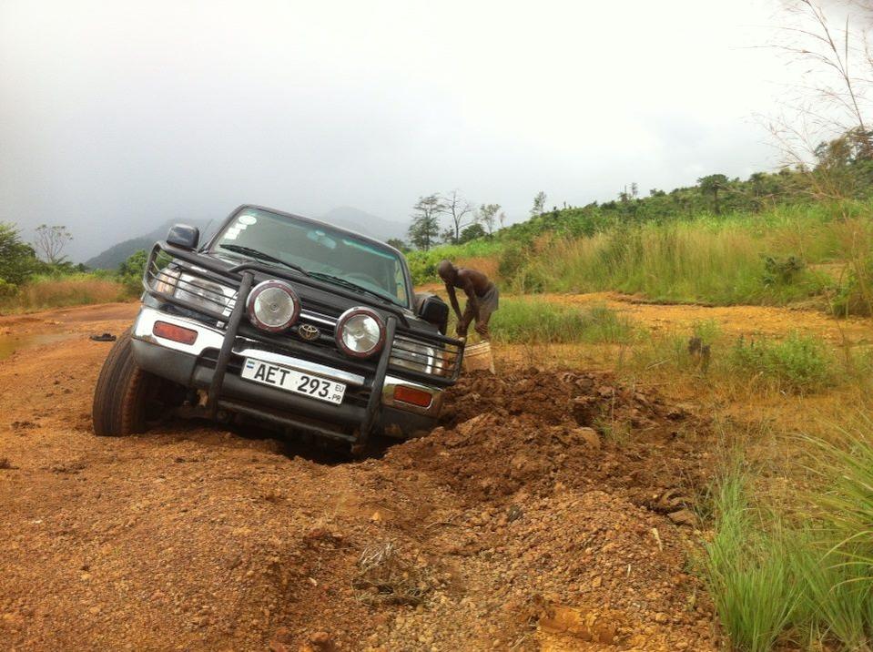

got stuck in a mud hole ....
after a lot of digging a passing Land Cruiser pulled me out

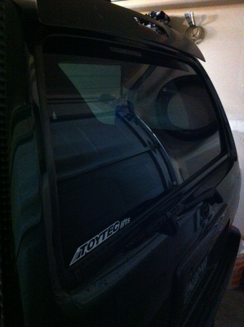

Removed my URD decal, replaced it with a decal from [MENTION=44448]ToyTec Lifts[/MENTION] . I am happy with this change.
I will take a better picture tomorrow.
