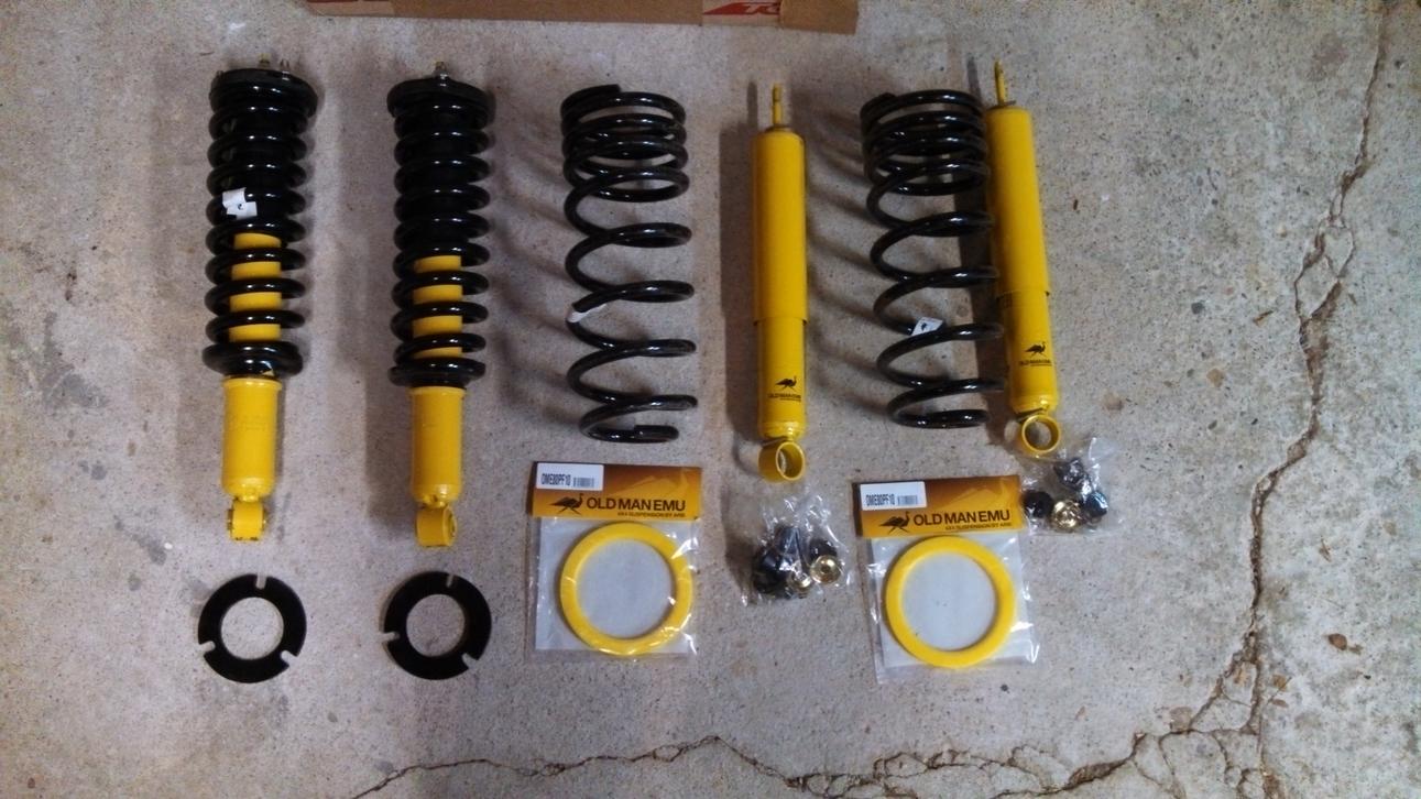

Finally bit the bullet.
Bought my lift. Bilsteins with eibach for the front and 890 for the rear
Also grabbed OEM LBJs and front and rear brakes. Tundra brake upgrade will have to wait for now
Installed my new suspension
After months of trying to make a decision, I finally went with the OME system.
Parts:
Front: 880 coils, 90004 Nitrochargers, 1/4" top plate spacers
Rear:906 coils, 60028 shocks, 10mm trim packers
Measurements Before:
Front: Axle center to top of wheel well: Drivers = 19-3/4", Pass = 20"
Ground to top of wheel well: Drivers = 34", Pass = 34-1/4"
Rear: Axle center to top of wheel well: Drivers = 20-1/4", Pass = 20-1/2"
Ground to top of wheel well: Drivers = 34-1/4", Pass = 34-1/2"
Measurements After:
Front: Axle center to top of wheel well: Drivers = 21-3/4", Pass = 21-1/2"
Ground to top of wheel well: Drivers = 36", Pass = 35-3/4"
Ground to top of wheel well: Drivers = 37", Pass = 37"

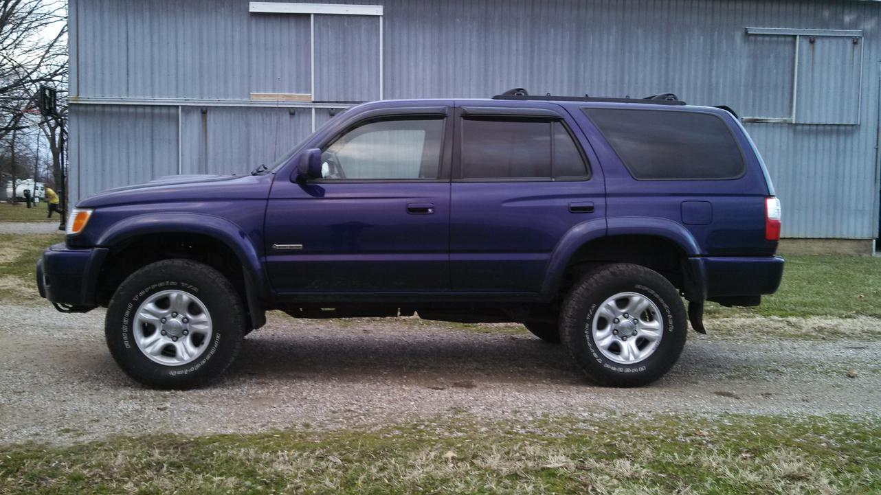

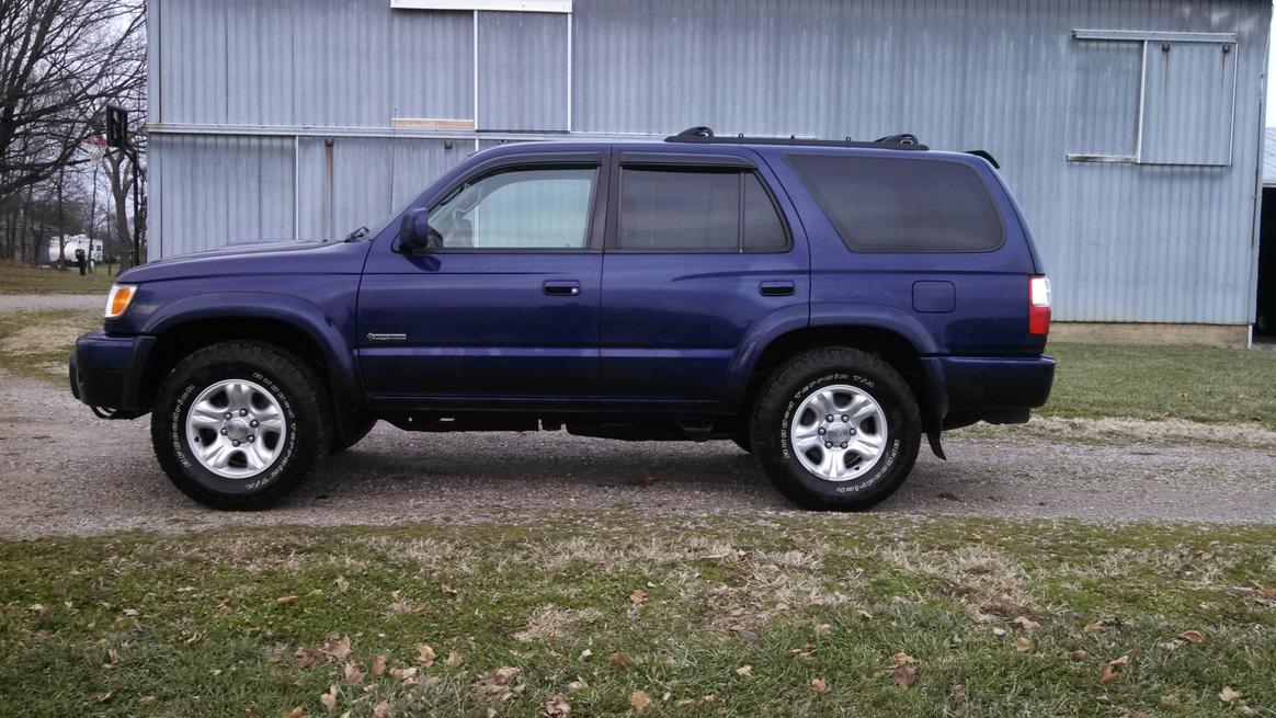

I haven't driven it much yet, but the ride is firm but feels planted. Thanks to everyone here that had shared their lift experiences - I spent many hours reading up on the various pieces/parts before pulling the trigger on the OME.
Picture of the goodies, before, and after:
