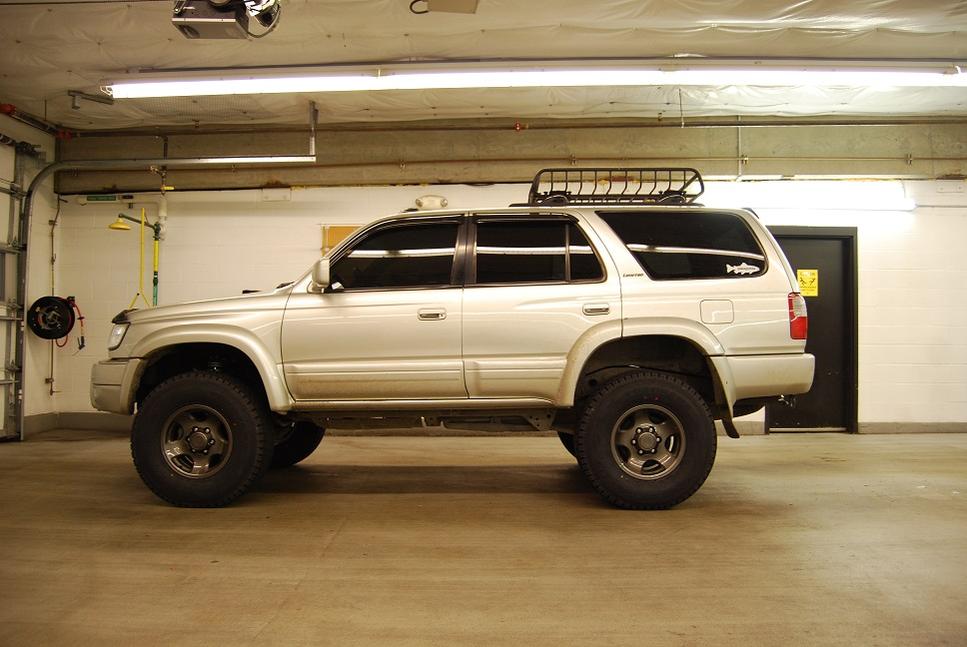

And i got bored so i de-badged the back. All i needed was a blow dryer, some floss, and some goo gone
Before:
After:
Looks much cleaner to me. I love it! Still a little trace residue but that should wax out!
EDIT: And I removed the stickers :)

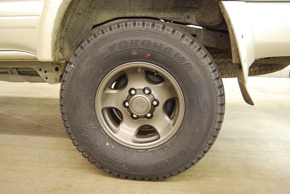

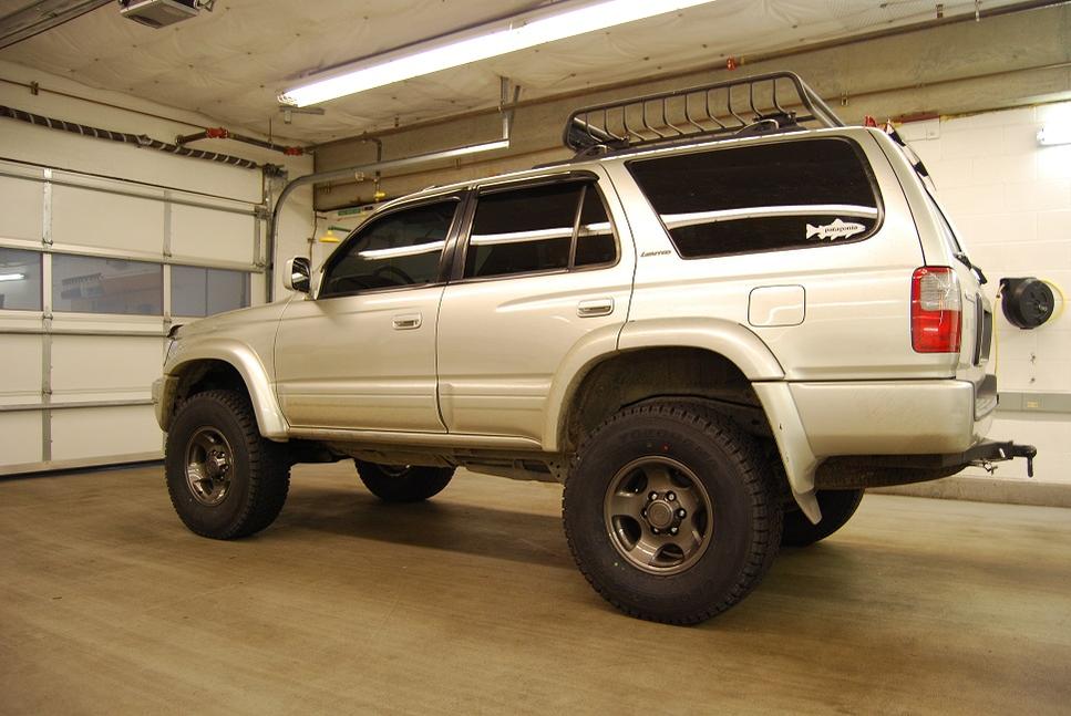

Installed winter wheels/tires. Gunmetal LC wheels shod with 285 Yokohama Geolander I/T G072 tires.:smow:

I've got the same tires!
After reading all positive reviews on the tires, I'm not overly impressed. Good on soft snow, bad on ice and slush. Even deeper snow. First set of snow tires and I'm wondering what the rave is about?
This is the first time I've ran them so I'm not sure what to expect. I've ran Blizzak DMV1s before and those were amazing. But, they don't make them in the size I wanted so I decided to give these a go. They will for sure be better than my KM2s, that's all I know. Those are only good when they are aired down to 8psi :ohwell:

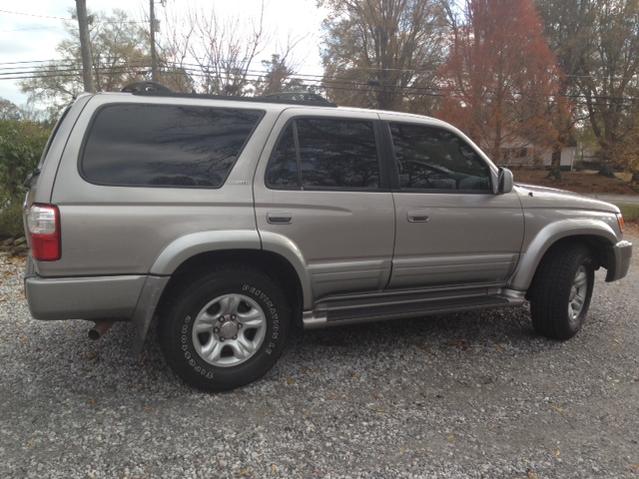

Got the windows tinted. 5% on back glass from pass door back. 20% on front and a 5% strip on front windshield.
