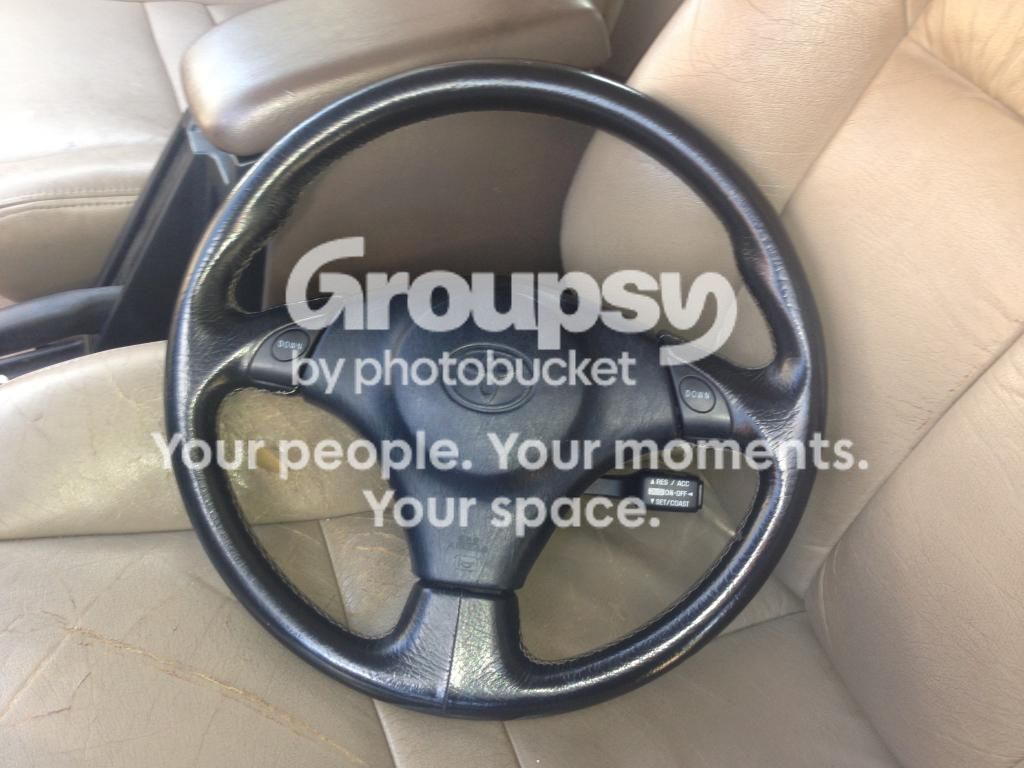

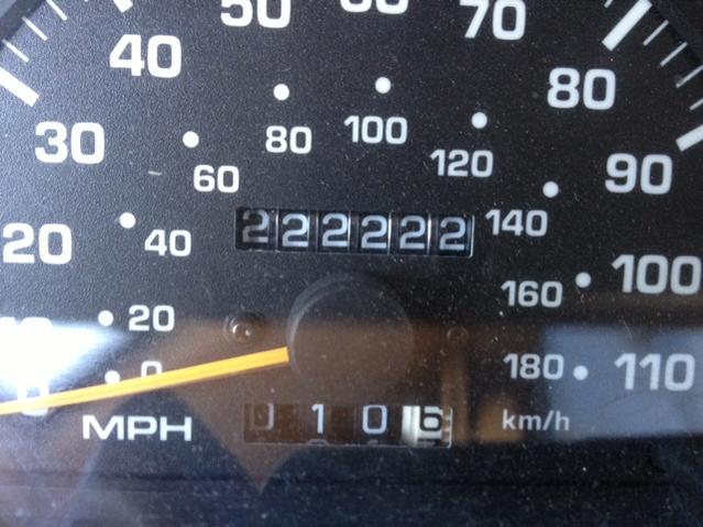

Still working on getting the cruise control to work but I can confirm the 3 spoke toyota steering wheels will connect to the 98+ clockspring and the airbag works!! I plan on doing a complete diy thread once I have the cruise control working..
It reminds me of a is300 steering wheel
It basically is.. The rav4 98-00, supra 98+, trd 98+, celica 00-05, corolla 03-05 and is300 are the same wheel minus the trim and airbag design for the is300. The is300 and some celica have a really nice leather wrap. The rav4 wheel I have posted is the same material and the automatic shifter knob.. Hard plastic.
I had originally bought a is300 steering wheel but the rav4 airbag didnt really fit the is300 steering wheel correctly.. Im not to happy with it compared the is300 wheel but I came across a really good deal so it makes up for it for now..
