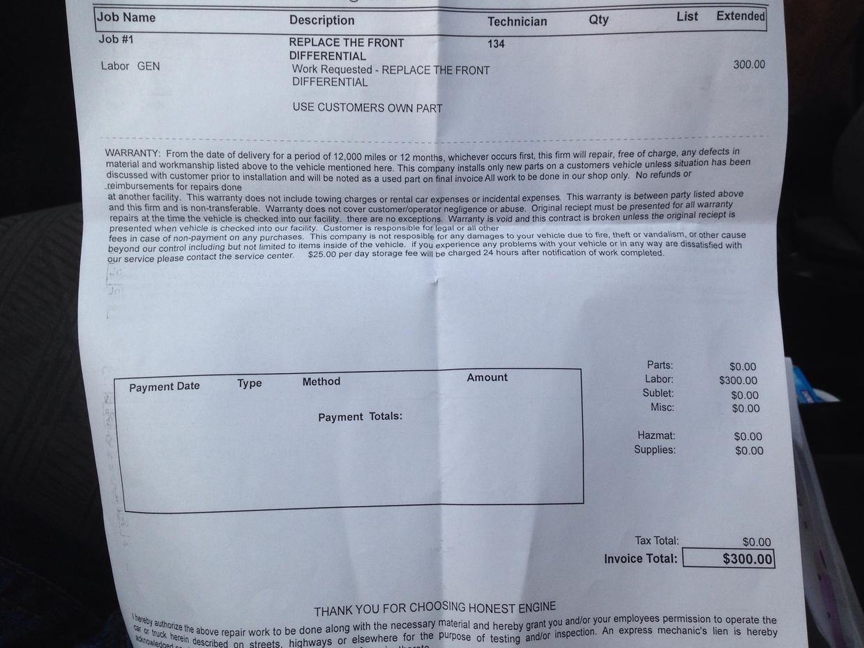

Getting the transfer case out/in is the worst. It gets stuck between the bell housing and the steering knuckle at the steering box. The output flange where the driveline bolts up is almost impossible to get past there. Had to use a pry bar to flex out the motor mounts to make it slide by. Just paid $300 today to have it put in while I was working, didn't wanna dick around with it again.
Talk about easily defeated! I have done multiple solo installs/removals with the vehicle just up on jackstands. I will admit, it can be a 8itch/challenge depending on how you look at it.

Where were you [MENTION=89223]xcmtb83[/MENTION] when I was doing my diff then? I would of loved to see you make it look easy. And I did it the first time with my runner on jackstands also, didn't want to do it the second time because I was given the wrong gears. I did it the first time and was more than happy to pay to have it done again and save me the hassle. If there are any trade secrets you have, please fill me in. I definitely would of appreciated the help.

I never said I could make it look easy. It's just I would never pay $300 for someone to install one for me. $300 is a lot of money to me.
You gear comment is confusing...
I have no trade secrets, just brute force and ignorance.
