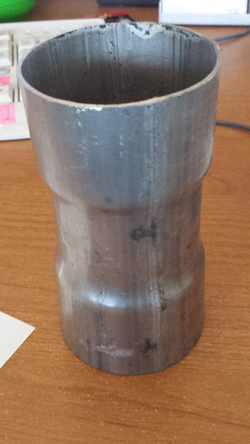

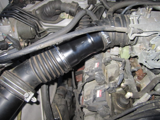

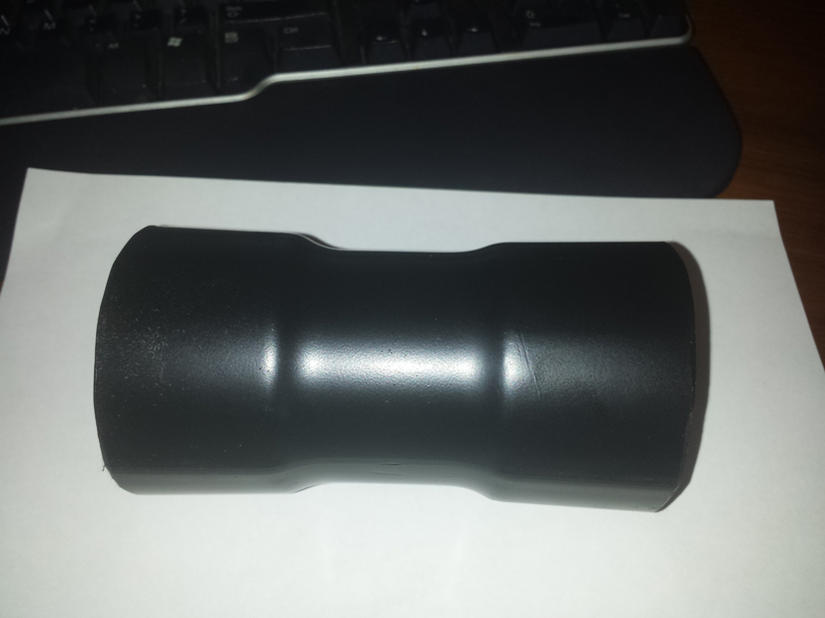

Found a small muffler shop in town run by a nice guy who cut and expanded a piece of exhaust pipe for me. Smoothed out the rough edges, threw on a couple coats of high temp paint and was good to go...
...except the OD was a little closer to 2.85" than 2.75" and took a little more elbow grease to install than I anticipated. No biggie, just turned a 20 min job into an hour but you live and learn. But to anyone thinking of doing this, I really recommend keeping it under 2.75. The worst was getting the hose clamps at each end back on. I literally didn't have .5 mm to spare:doh:

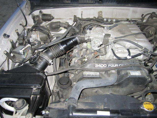

Got a Y fitting and some new hose from AAP (didn't make a T oddly) and took it for a spin. So far I am loving it! Sounds great and does get up to speed easier and smoother.

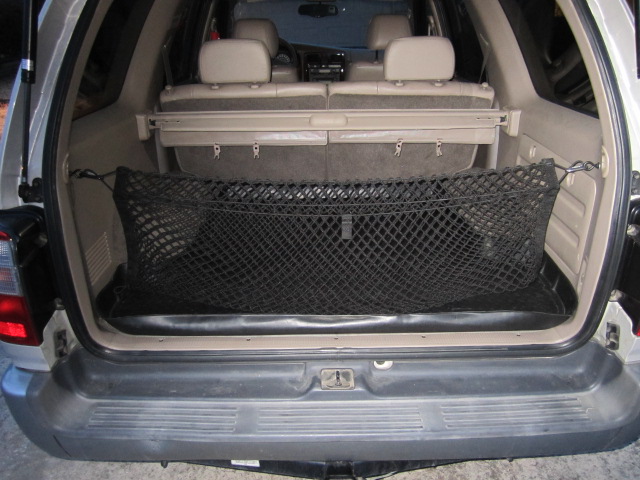

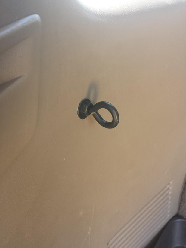

While I was out I picked up a couple eye bolts to give my cargo net something to hold. Another long overdue tweak!
[MENTION=65101]BrianSD_42[/MENTION] thanks, yeah it's just a 1.5" bolt with a washer and nut on each side of the interior panel. Pretty strong for what it is; messed with it quite a bit and didn't give.

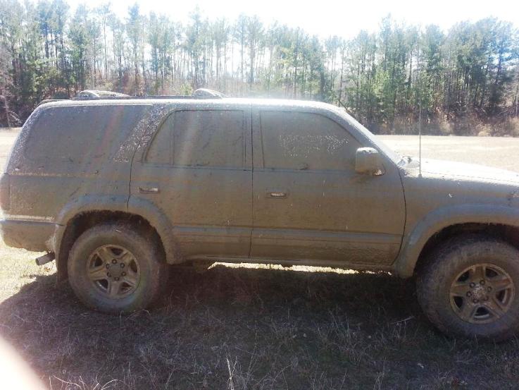

Christ, that had to be fun to wash. Mud is not worth all that cleaning.
It wasnt too bad with a pressure washer. Trust me I did not mean for it to be that bad.. that was the outcome of my brilliant idea of taking a short cut to a lake I was wanting to fish. Took me about 20 minutes to get out of the pea soup I sank in. :lookout:
