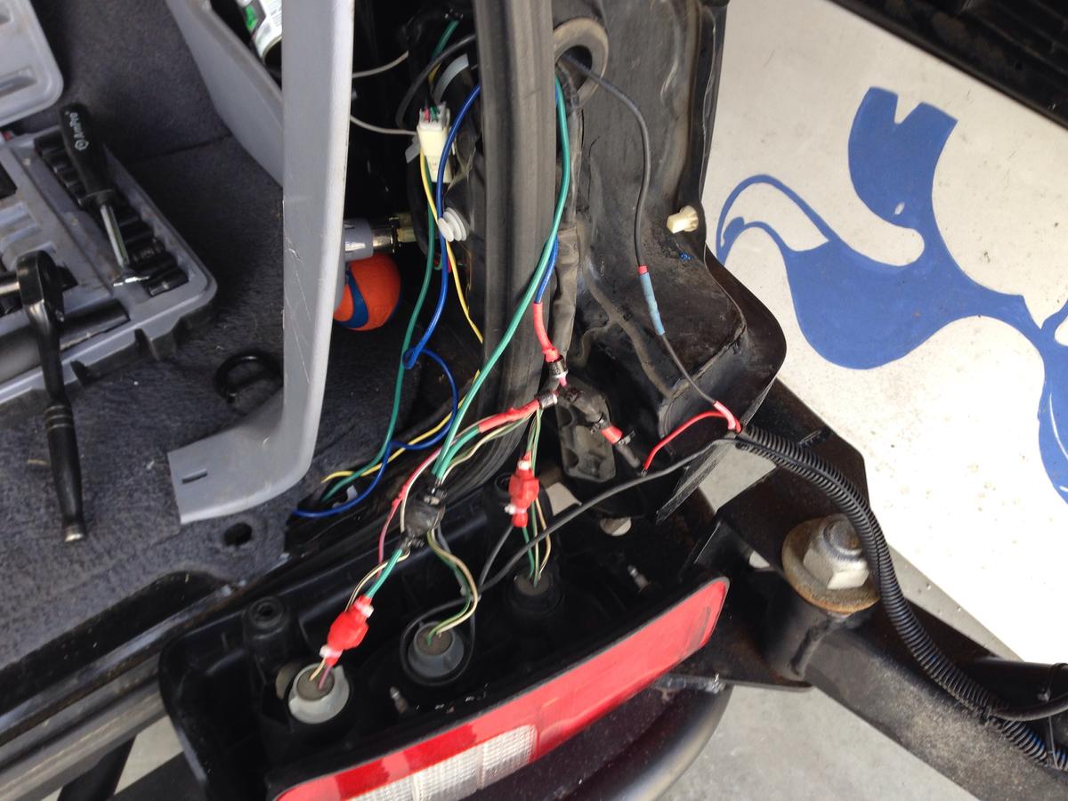

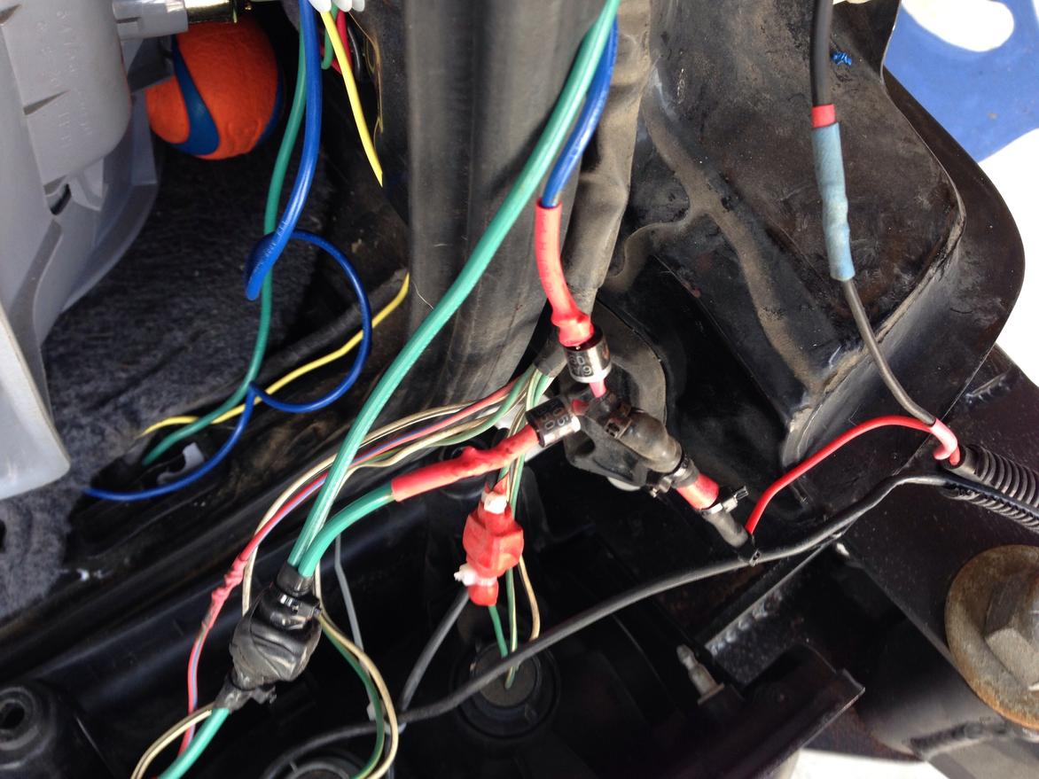

Diodes
FUN WITH DIODES. Wired the swing away work light to have power from two sources: powered by reverse light circuit, then direct from the acc circuit via a switch on the dash. Wired in two diodes to prevent back flow of electricity to the other circuit.
