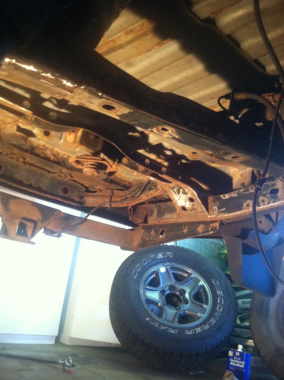

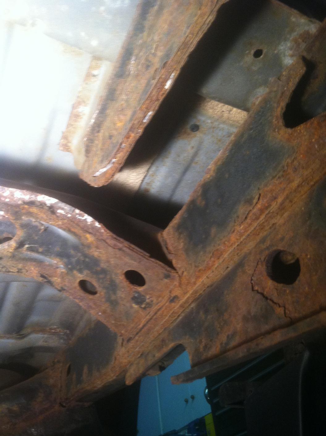

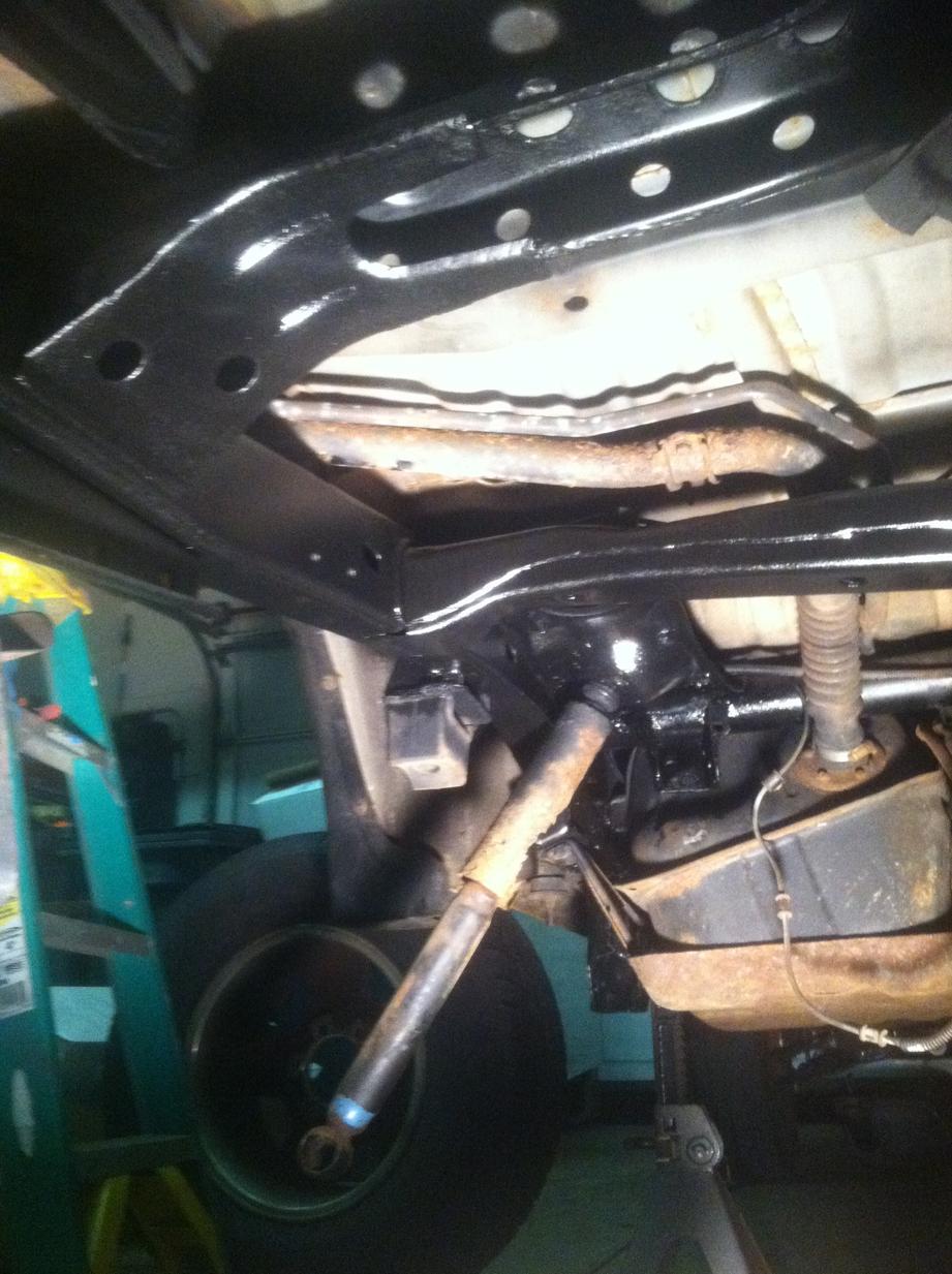

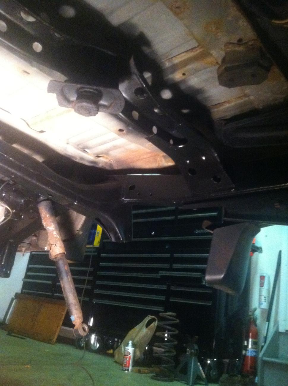

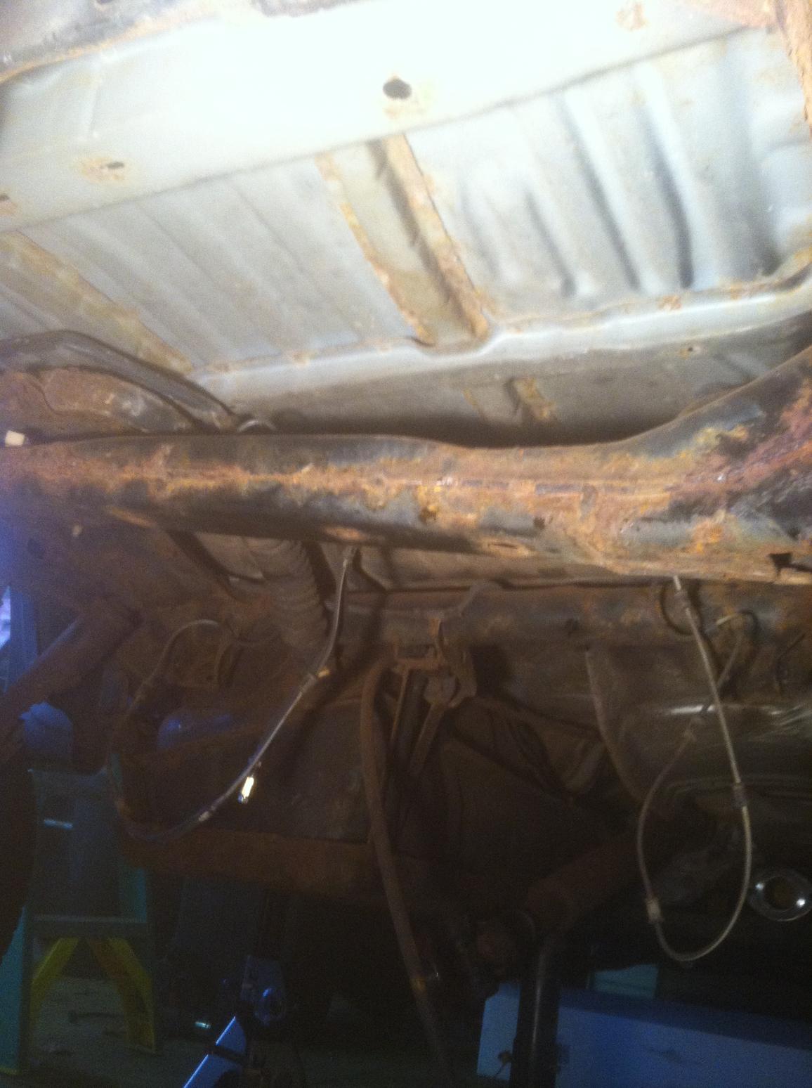

While waiting for the new axle to come in, I decided to do something about my very rusty frame.
Used the angle grinder, wire brush and chisel to get the big rust off.
Then used Rustoleum Rust Reformer spray, then brushed Rustoleum bed liner on top of that. Hoping for the best!
Before: It was really bad..

Scuffed down:
Finished product: (Really need some new shocks)

That frame looked crispy. It looks good now. Keep in mind that boxed frames rust from the inside as well. You should inject the inside of your frame with Fluidfilm or old motor oil if you want a cheap alternative. It requires no prep and lasts long.
Thank you! You read my mind, once I get the axle hooked up and the rest of the frame done, I am going to be doing just that. How does Fluidfilm, Eastwood's internal frame coating, and just motor oil all compare?
I would think Fluidfilm is best in terms of appearance, motor oil is more of a cheap-o alternate that works similarly. I cringe when I see that internal frame coating. It is meant for new frames, not ones that have seen salt for 15 years. You can never fully clean the inside of that boxed frame. When you use that coating you could be painting over dirt that cannot be seen. That is worse than leaving it in my opinion.
