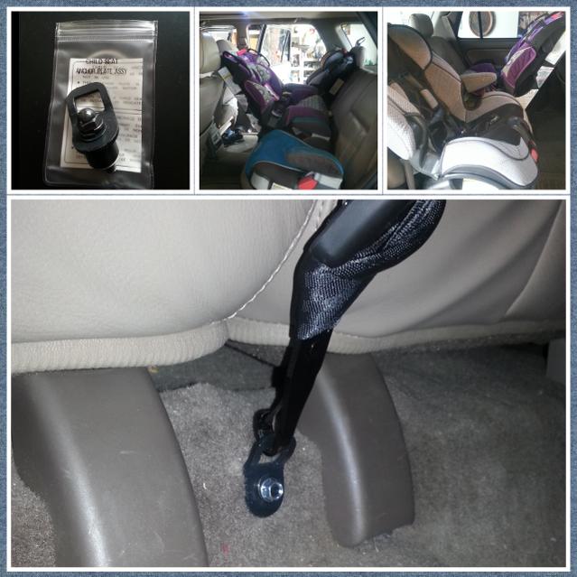

car seat anchor installed-
Well i did this yesterday but whatever-:p
We had nowhere to anchor the safety straps, so I found this kit on ebay for around $10 & it worked out great!
