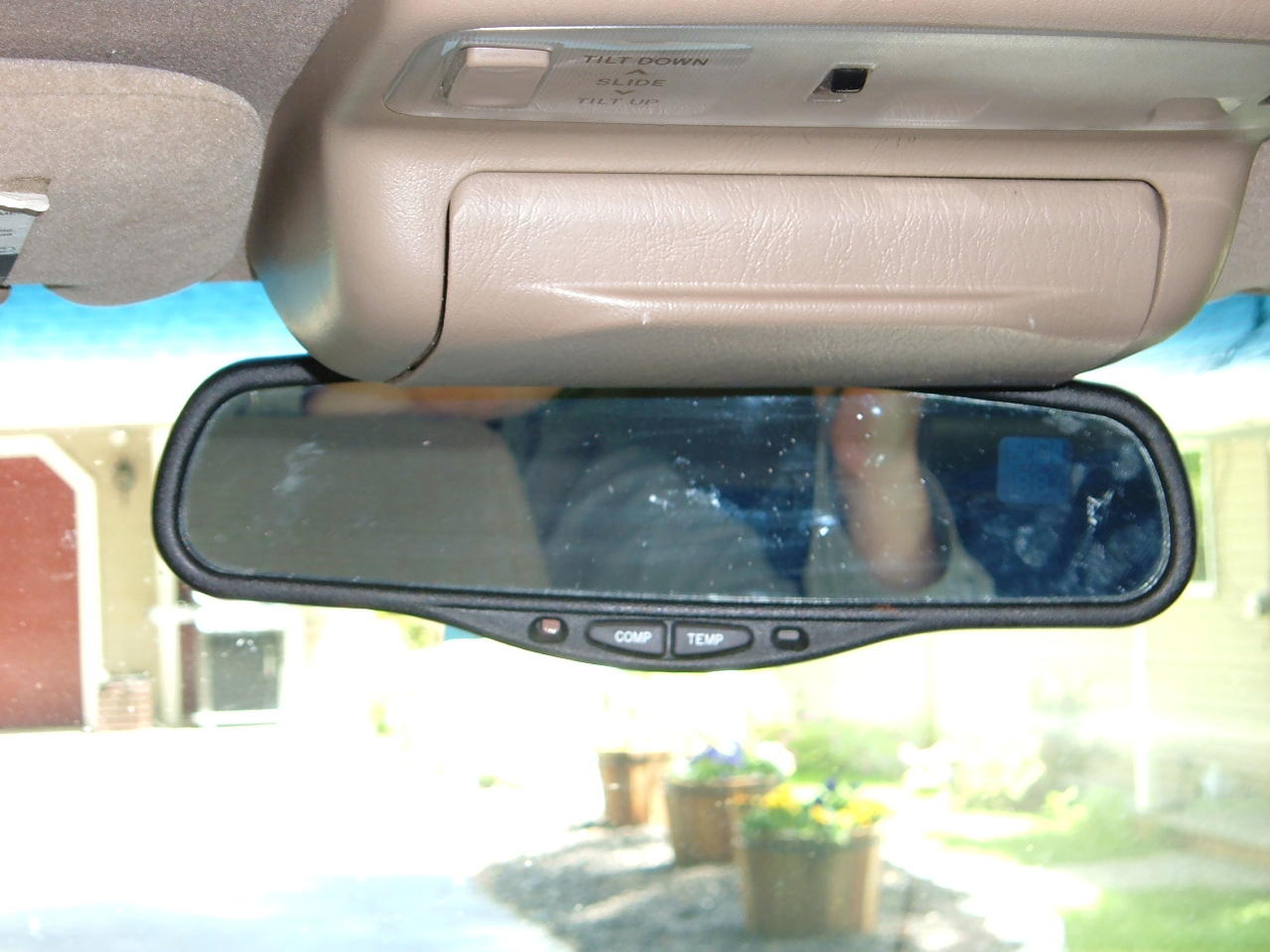

do you have any pictures of the finished install? i've been thinking about putting one in for numerous years, thank you good sir!
Not the best picture. This link http://www.toyota-4runner.org/3rd-g...-mirror-compass-thermometer-installation.html
has everything you need to know with pictures. My fuse box was oriented different and I used a mini fuse tap on the wiper fuse to get power. My roof console was a little different, so I had to ground it using a screw that held in the old mirror. Having the compass and temp is great but I think the auto dim might be the best feature.
