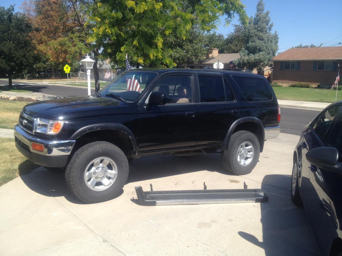

Just took the Running boards off the Stallion!!

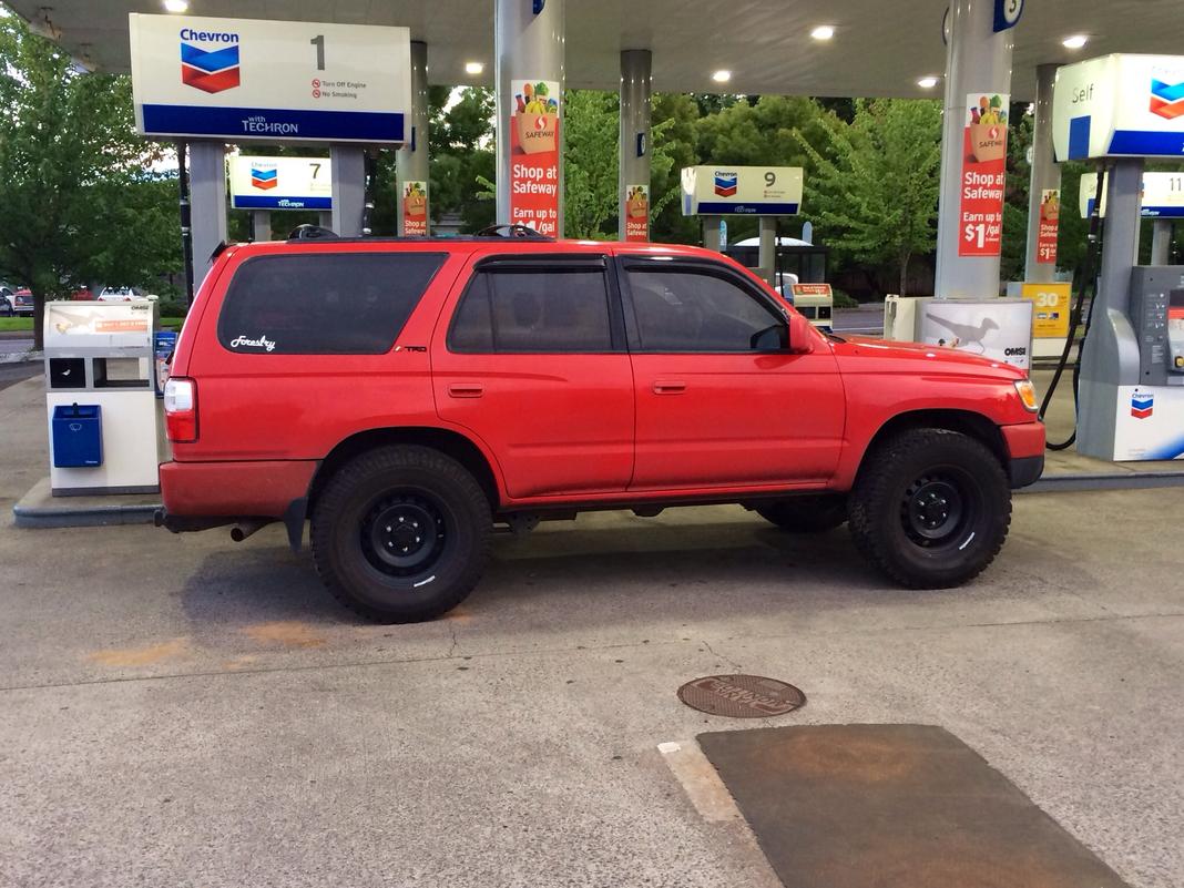

But in the last month... I got new 17" FJ cruiser wheels + used 285/70/17 bfg ATs (85% tread) for $596 at les schwab, woooo :bolt:

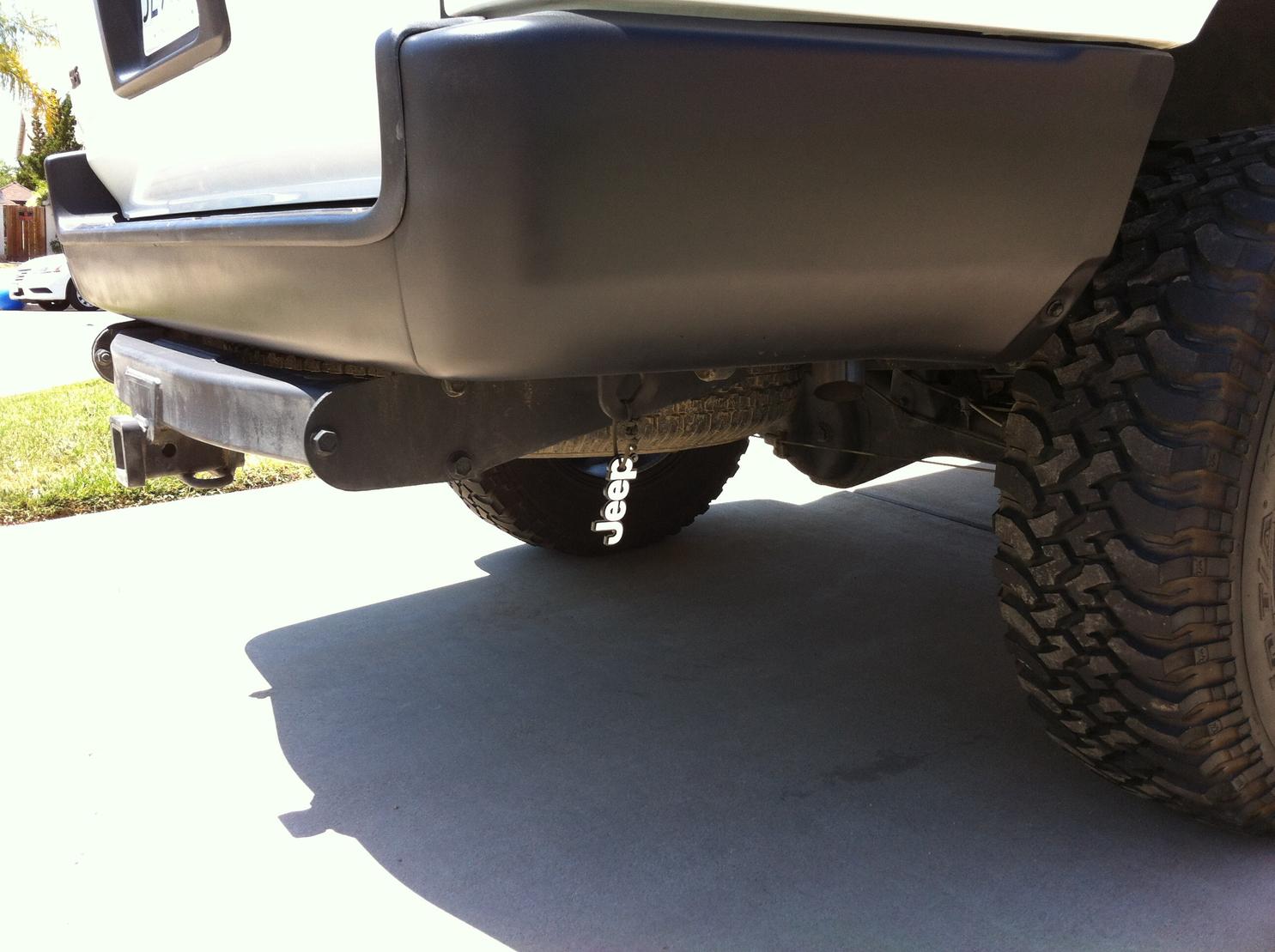

And I color matched (sorta) my bumpers. #nochrome
