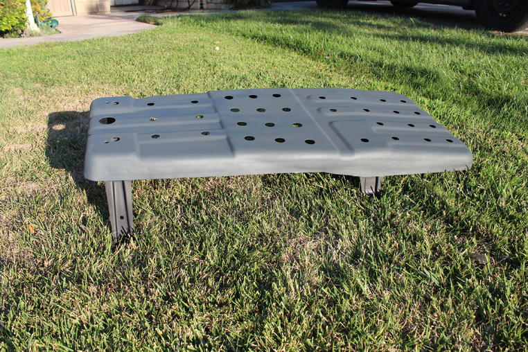

Spray painted the gas tank skid to slim the look of the "belly."

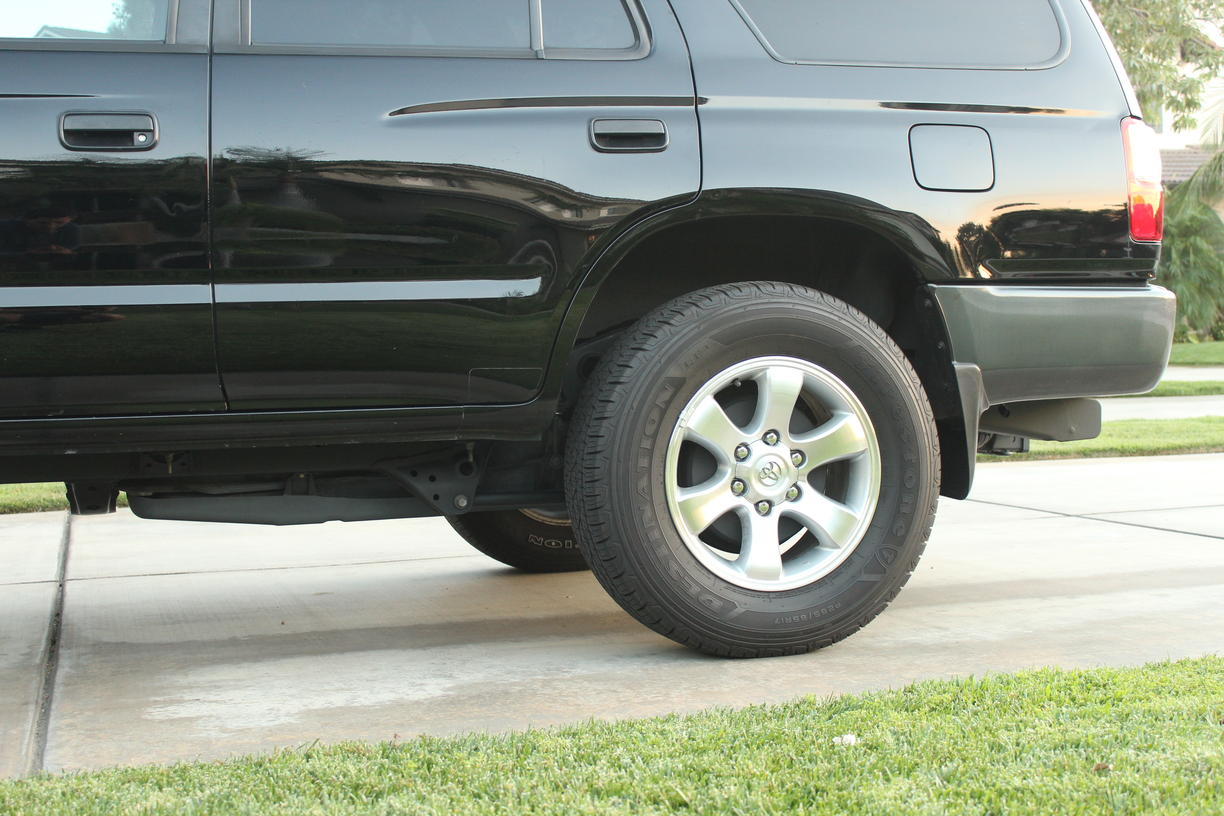

A look at my links did it a couple days ago
That bumper is beautiful. I like it better than mine... looks lighter as well.

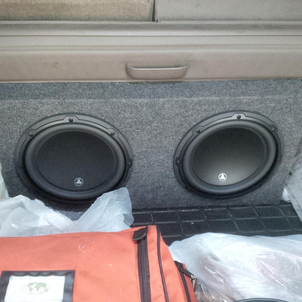

Replaced the subs yesterday.
That there is some real fine looking scenery.! I could get lost there with my Nikon and lenses.

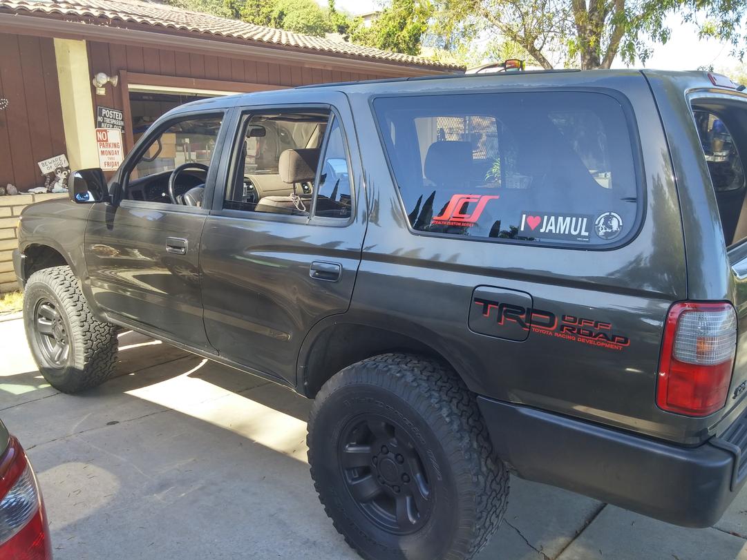

95 yota,
Love the color of that Runner... Not the color you see often.
