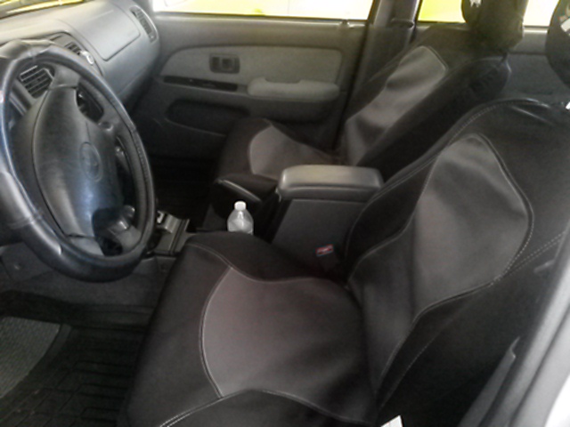

11. New front seat covers (Costco)
12. Broncos decal, steering wheel cover and headrest covers (self)
13. removed front seats and cleaned them well (self)
14. Shampooed carpet and headliner (self)

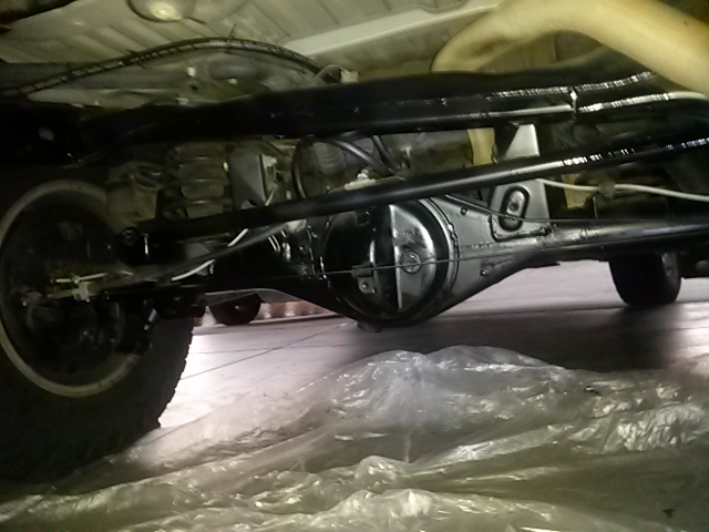

Painted frame, rear diff/axle housing and hitch with rustoleum paint.
Nice! Forgot to mention last night that I slopped JB weld along the top of my rear diff cover because it developed a leak months ago. There was scaly rust all along the top of it (again, beach driving will ultimately be the death of this truck).
I also have pretty extensive frame rot at the inside edges of the rails in the gas tank and muffler areas. The upper and lower surfaces of the rails still look good so I'm not going to worry too much about it. I will probably only get another couple years at most out of this truck. I would like to see the odo hit 300K though. (220K now)

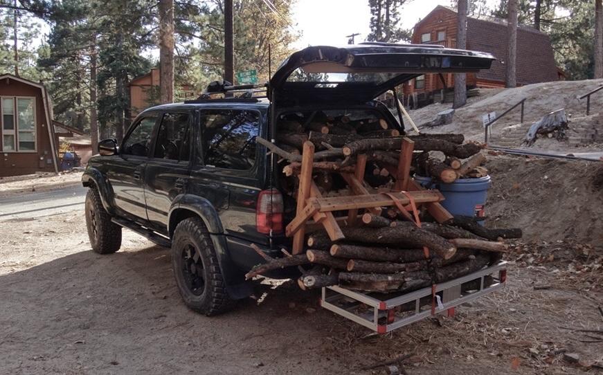

Grabbed a few pices of firewood for the cold weekend.
I hate doing this to my beautiful Runner, but it's a workhorse and that's why I bought it in the first place. The inside is protected with moving blankets so not too big of deal.
It's actually pretty fun driving out in the forest with a saw and harvesting wood for the cabin - helps save on heating bills big time too.
