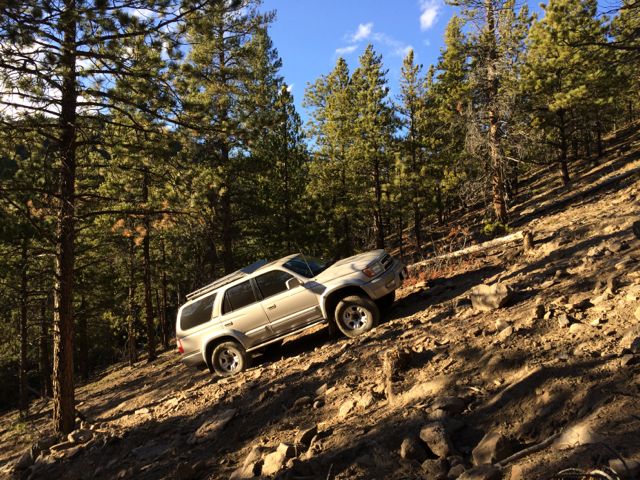

30 deg slope. loose dirt/rocks. steep. elocker.

^^^^ Nice looks like the moutains where i live.

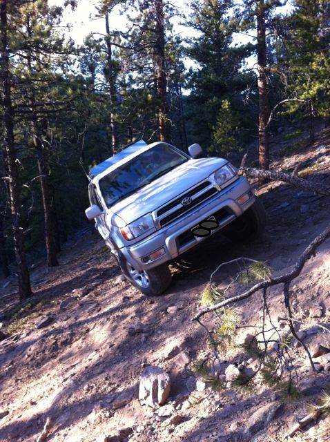

2 hour loop named Slaughterhouse Gulch. About 1 hour from Denver. Fair number of hunters camping right now.
I am so impressed with my 4R. It's a little off road beast. Push button wheeling. Yee haw.
Backing up to turn around was the sketchiest part for me:

Im in arizona but the moutains and forest look like areas north of me. Yeah the 4runner is a go anywhere off road beast. I am new to wheeling and got into a rock slide i went down it just fine but getting up tricky and my stock sr5 got up and out out of it. Im has the j shifter but i prefer not having all time 4wd and e locker would be nice though.

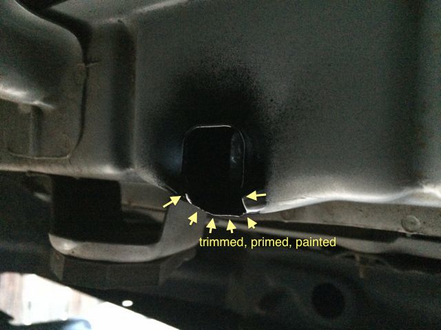

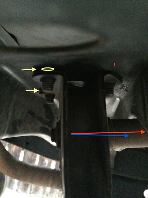

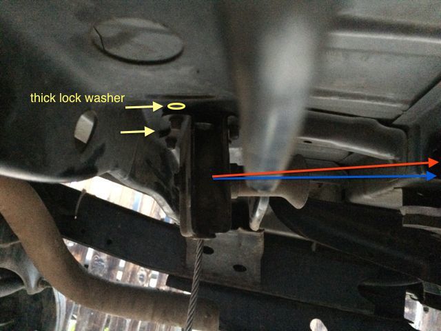

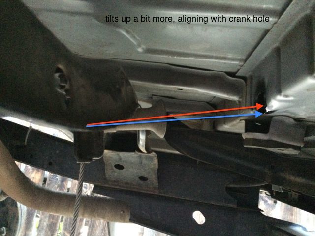

enlarged spare tire crank hole
greased sunroof tracks and cables.
1" body lift requires slight mod to allow crank handle to fit through access hole and into spare tire pulley.
enlarge inner hole
add spacers between crossbeam and pulley mount
this cants the pulley assembly up slightly
