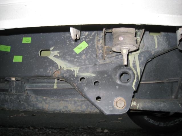

Emptied two cans of Eastwood Frame Coater. Felt like spraying pea soup into the frame:
Two cans was just enough to do a single coat. The box calls for two coats, so I might reprise this later. This spring, the exterior of the fame will be getting a coat of KBS RustSeal to complement the interior coating.

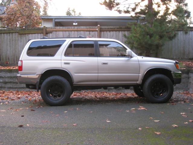

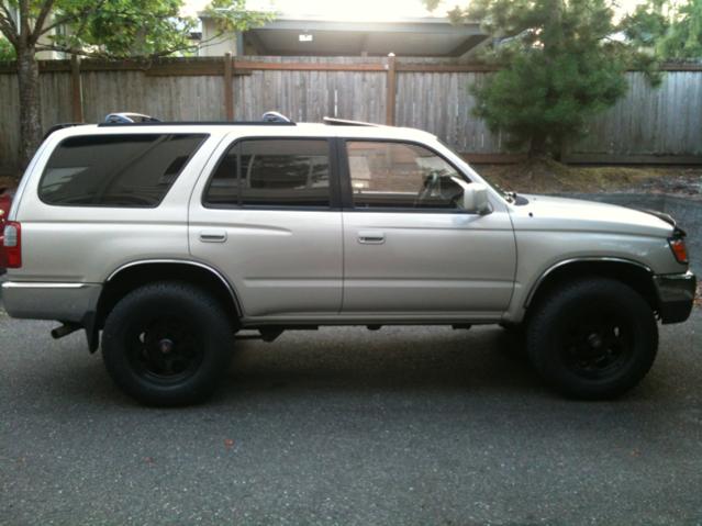

And finally got around to an "after" pic for my Tundra / 906 lift while I was out there.
Before (stock suspension with 265/70/R17 Cooper AT3's):
After (Tundra Coil Front + OME 906 Rear, Bilstein 5100's both ends):
Ended up being 2" of lift and 0.5" of rake, pretty much exactly what I wanted. No more rubbing, and rides great.

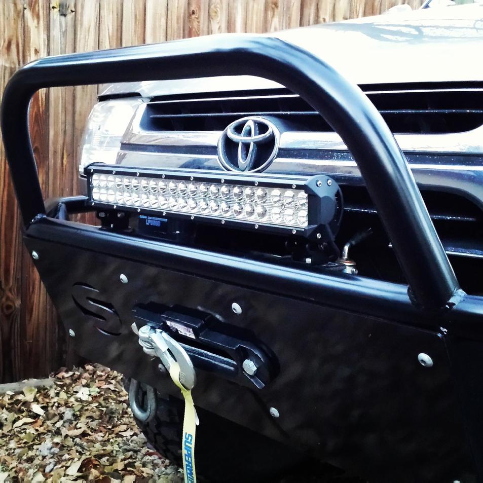

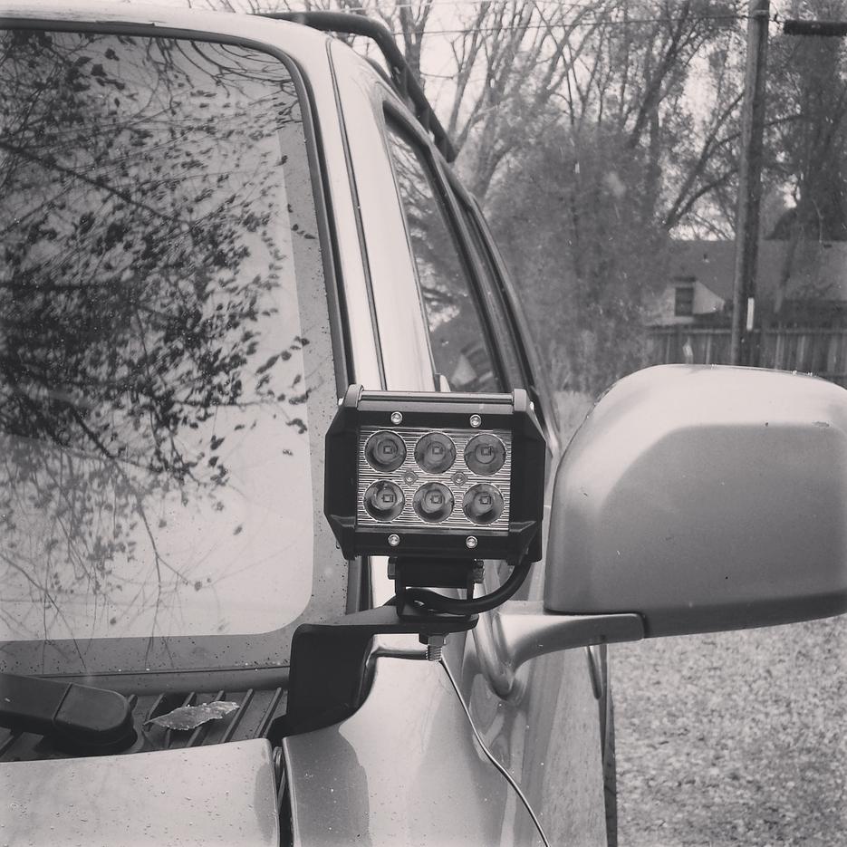

Got sick of my Hella spots, so got some Cree 2x3s on CBI ditch light mounts (which I still need to wire) and a 20" Cree bar for the bumper that is already exceeding my expectations! Absolutely awesome for the money! Super bright. Time will tell with long term weatherproofing/quality

Got sick of my Hella spots, so got some Cree 2x3s on CBI ditch light mounts (which I still need to wire) and a 20" Cree bar for the bumper that is absolutely exceeding my expectations! Absolutely awesome for the money! Super bright. Time will tell with weatherproofing/quality
Love the ditch mount lights. That's next for me too
