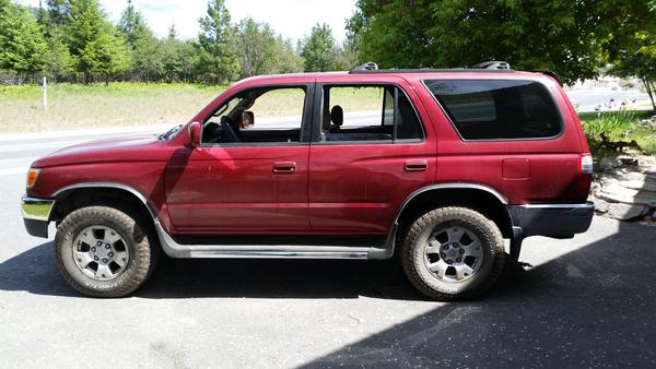

Today i sprayed on a bug guard and primed my wheels to get ready for paint.

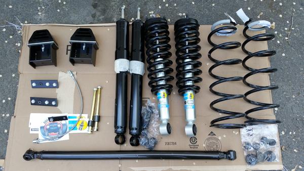

Got the rear end of my SS 1.2 installed this weekend. Yes, I am slow :p
I had hoped to get all 4 done, but quickly realized Saturday that wasn't gonna happen.
My '98's ass was sagging bad. It added ~5-6" of lift :biggrin2:
I knew it was gonna be a lot of lift when I was done. When I put the frame on the jackstands, the wheels had been off the ground. The drums were only ~4" off the ground when I was done. I jacked up the axle on each side to get the wheels back on. When I was done, the truck was almost off the jackstands!
Wore out my uni-bit trying to open up the upper shock mounts, so I'll go back in there and add the centering washer later. Everything else went as good as expected.
You learn the most when you take things apart a couple extra times, so I learned a LOT about how my rear suspension works. :lol:
It didn't help that I didn't realize there were directions for my kit until I had already spent a few hours taking things off. Since I had already started, I just sorta jumped around the directions. Not a good plan when the time comes for reassemly.
Tip: There is a reason he puts the steps in the order they are in.
In case you have the same idea I did, no it will not be easier to put the struts in before the springs because you can use that hole to reach your hand in. :doh: Springs, then struts kids.
I have pictures!
The goodies

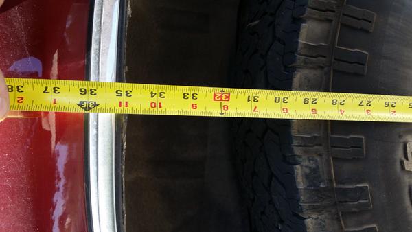

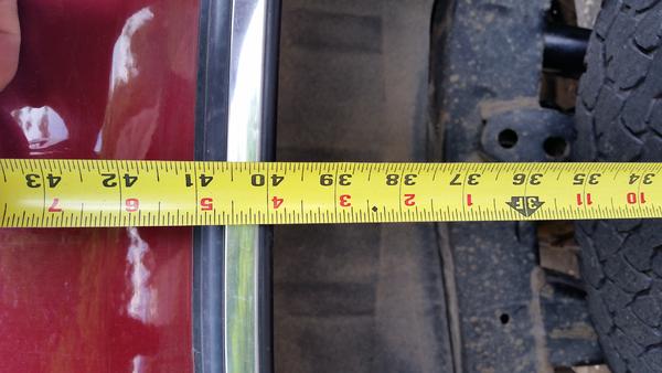

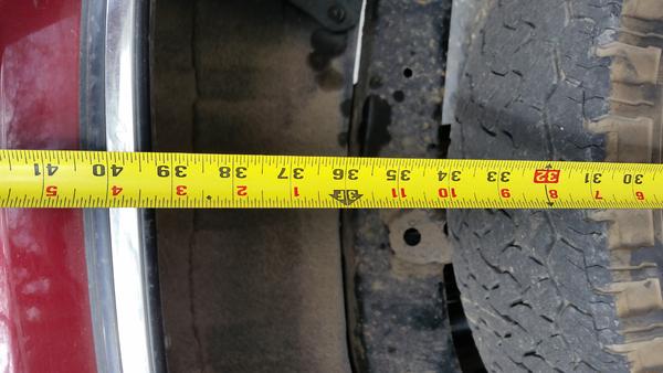

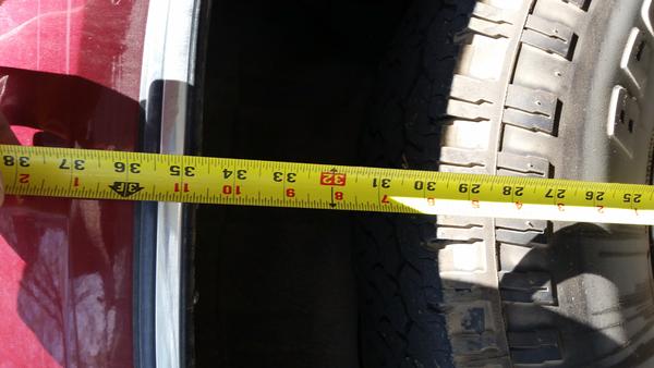

The truck before, including fender heights.
hayduke-albums-1998+4runner+sr5+4wd+automatic+w-diff+lock-picture33176-my-98-before-suspension.jpg
Driver's Rear Before
hayduke-albums-1998+4runner+sr5+4wd+automatic+w-diff+lock-picture33179-drivers-rear-before-suspension.jpg
Passenger's side before
hayduke-albums-1998+4runner+sr5+4wd+automatic+w-diff+lock-picture33180-passenger-rear-before-suspension.jpg

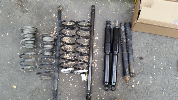

New parts vs Old parts
hayduke-albums-1998+4runner+sr5+4wd+automatic+w-diff+lock-picture33181-old-stock-toyota-vs-new-ss-1-2.jpg

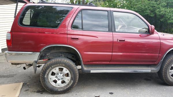

After including heights
hayduke-albums-1998+4runner+sr5+4wd+automatic+w-diff+lock-picture33182-after-ss-1-2-rear-install.jpg
Rear After
hayduke-albums-1998+4runner+sr5+4wd+automatic+w-diff+lock-picture33183-drivers-rear-after-ss-1-2.jpg
Passenger After
hayduke-albums-1998+4runner+sr5+4wd+automatic+w-diff+lock-picture33184-passenger-rear-after-ss-1-2-install.jpg
huh now that I am reviewing these pics, the passenger side is higher. Gonna have to figure out what I did wrong :Cry:
