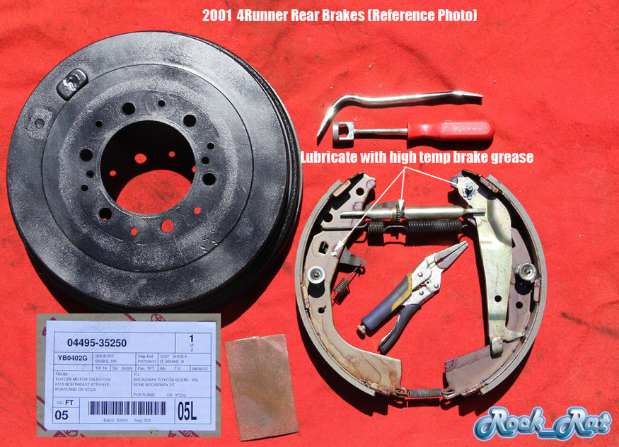

2001 4Runner Rear Brakes Photo
Rear brakes...easy stuff. No leaks so left the cylinders alone. Drums looked great. No need to turn them. Little emery cloth and GTG.
Just added a cpl of pics for those doing a google search for 2001 4Runner Rear Brakes and need a photo for reference. There's a ton of how-to stuff out there.
  • Time - Two hours (No bleeding or replacing wheel cylinders)
  • Parts - Brake kleen, emery cloth, high temp brake grease (small amount)
  • Tools - Needle nose vise grips, brake spoon, washer compressor tool, pliers
You can replace the shoe hold down springs, pins and cups if you want. You can also hone the wheel cylinders if the boots are torn and the cylinders are leaking, You can also have the drums checked to see if they're true and turned if they have any grooves in them. Mine looked OK so I left the wheel cylinders alone and used emery cloth to scuff up the drums. My motto, "if ain't broke, then don't mess with it".
Lubricate with high temp brake grease (non-petroleum based)
  • The Adjuster
  • Adjuster level pivot pin
  • Parking brake lever pivot pin
  • Brake shoe contact points on backing plate
TIME SAVER PRE-ASSEMBLE!!
To install, PRE-ASSEMBLE both shoes FIRST on your bench with the parking brake lever, automatic adjusting lever, adjuster and return spring. Once it's pre-assembled, just maneuver it over the axle and install the shoe hold down springs. Simple as that. Finish up by installing the short cable and the anchor spring.
Adjust shoes so the drums are snug as they're being installed. Back off a bit. Drive in reverse quite a few times to get the adjuster to make the necessary adjustments. When comfortable, take it for a road test.
Disclaimer: Read the FSM and/or the Haynes Manual

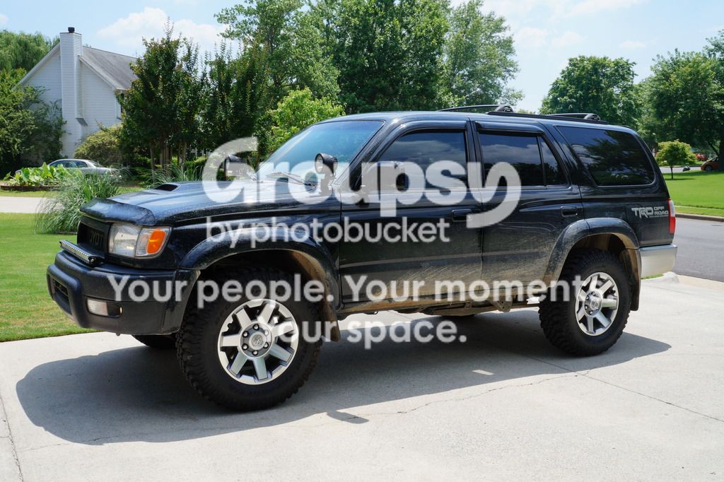

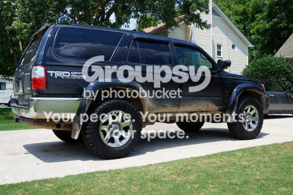

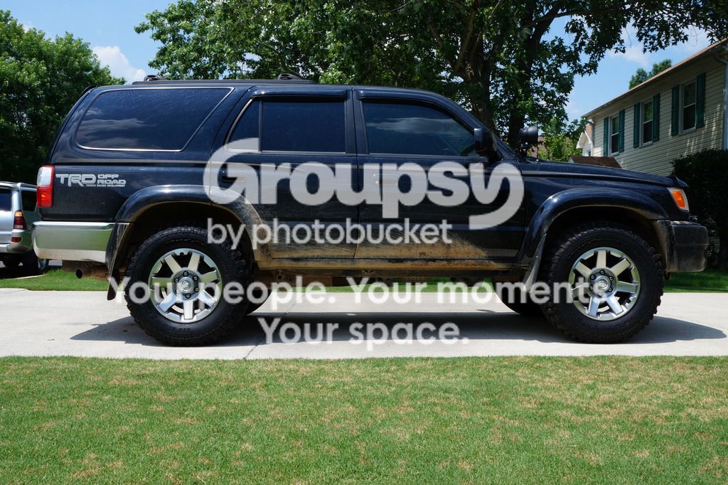

I got my new wheels and tires mounted yesterday. I'm super happy with the new look. New 2015 Trail Edition wheels, with a brand new set of 255/75/17 BFG KM Mud Terrain tires. I had to trim some very minor stuff to get these to fit stock. No rubbing now after trimming the mudflap and front flare. Thanks [MENTION=115276]Dirty Brigade[/MENTION] for selling me the wheels! If you ever want to go wheeling let me know, I'd like to hit some of the off road parks in the area sometime.

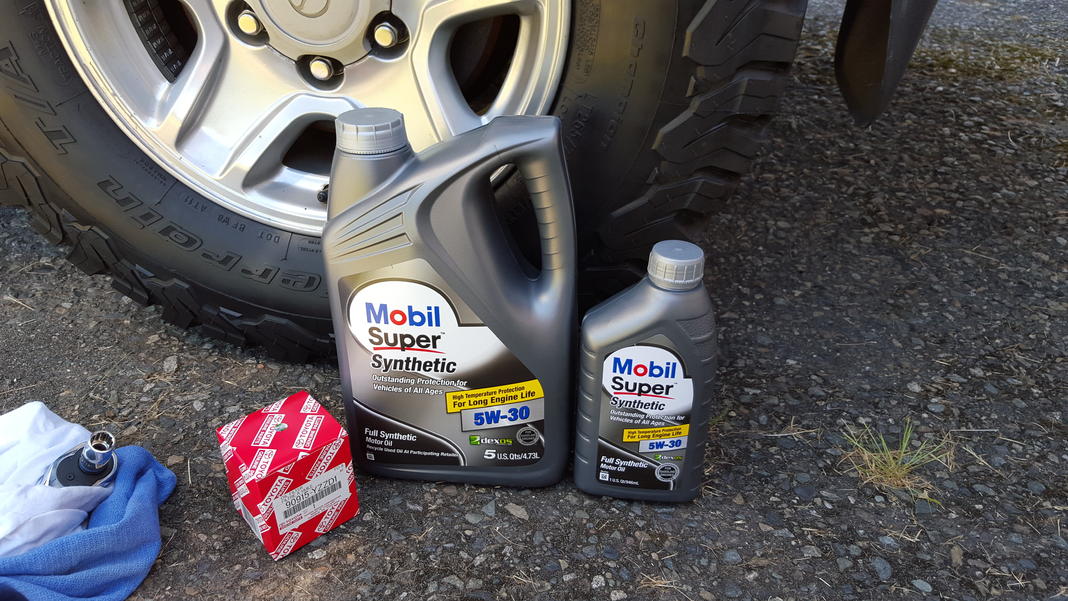

LOL. First ever DIY oil change. I think I might have done it the most difficult way possible. I watched a clip suggesting to take off the skid plates to better access the drain plug and filter without dripping a lot of oil all over everything. Hell, it took me a bit just to locate the filter in its devil's hole. That, and after draining my oil I realized that I didn't have a drain plug washer/gasket. Luckily, my O'Reillys is just a couple of blocks away. So jumped on my bike and picked one of those up.
It will be easier next time.

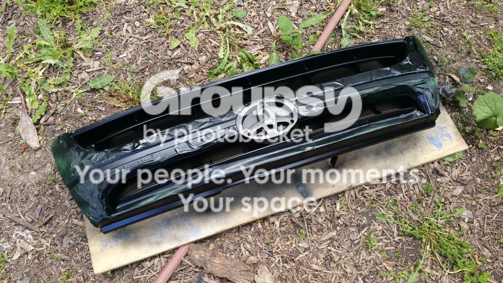

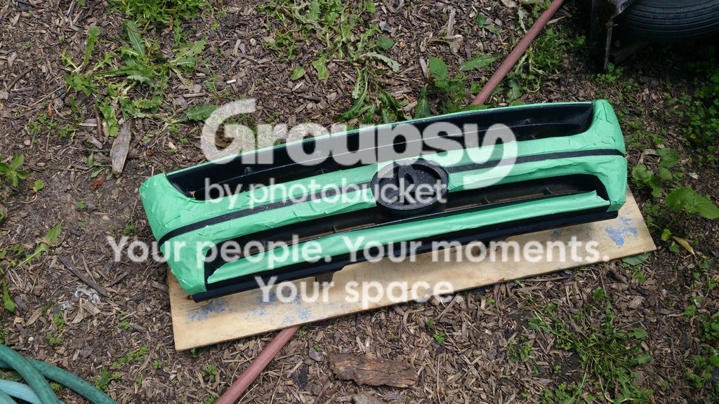

I had my grille off for the transmission install, so I decided to repaint the black parts. I taped it up then used a satin primer/black combo paint.

LOL! I started out thinking there was plenty of room under my rig for this modest task. It didn't take long for me to change my mind. It felt like I was working in the cramped turret of an M1-Abrams. The PO had really torqued the oil drain plug down. Without having ramps, or jacking the vehicle up, I had to switch to a breaker bar to free the pesky bolt. Working in cramped quarters was not ideal, but I got er done.
Thanks on the oil compliment. The PO had been running that, and I thought it was a good selection so I stuck with it.
Next project is the transfer cooler. Hopefully that goes a little smoother.
Those wheels aren't normally my favorite choice for a 3rd gen, but they look damn good with the black. :thumb:
Thanks man! They look sick in person with the M/T's. Good looking tires make a huge difference in appearance. I've been staring at the truck non stop since I put them on and I had they guys at firestone drooling over the truck when I took it in for an alignment today.
