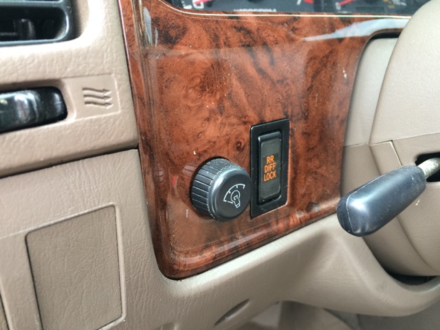

It's stupid...
I only inserted the switch and the cpu, but it makes me feel like I am like 80% done.
Still have to find and buy the rear end w/ 4.10 elocker, re-do the rear axle seals, re-paint it, remove the old one, install the new one, hard wire it.
But seeing this switch makes me grin...

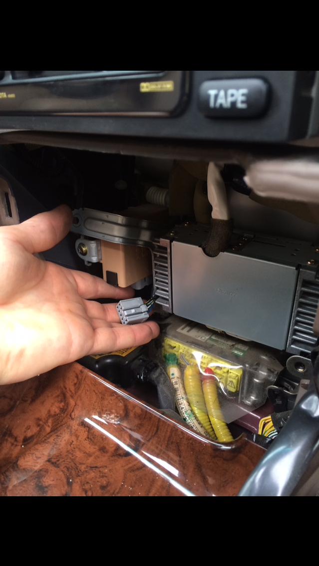

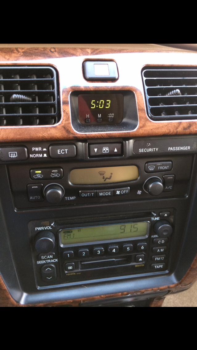

Disconnected my super noisy antenna motor by removing the connector from the relay. Much easier than going through the fender well, IMHO. Also got my clock working while I had the dash apart. All four of the contact springs were compressed. I re-stretched them a bit. Soldering will be the permanent solution when I take it the lab. Good stuff! Now to enjoy my weekend. Currently sitting at 9,500 feet surrounded by the mountains :biggrin2:
