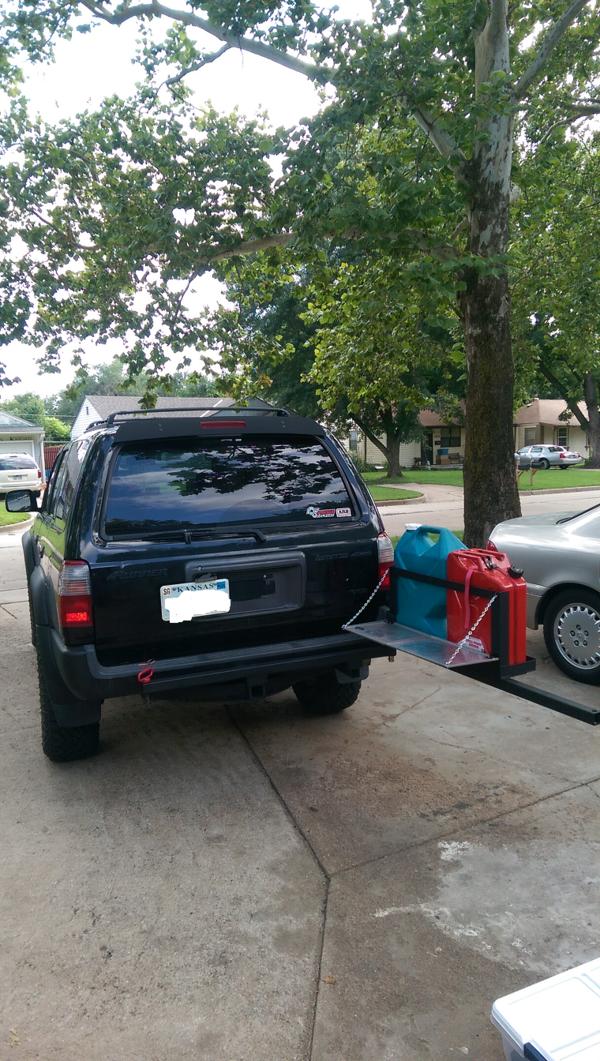

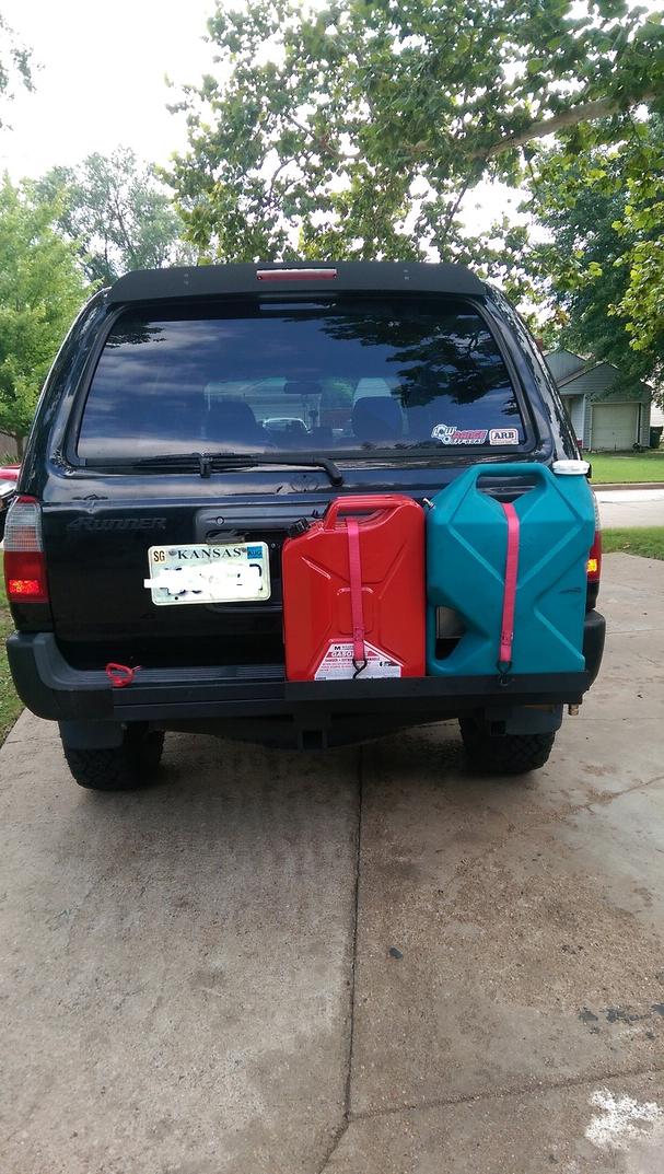

swingout
finally made a rear swingout just for jerrycans.
