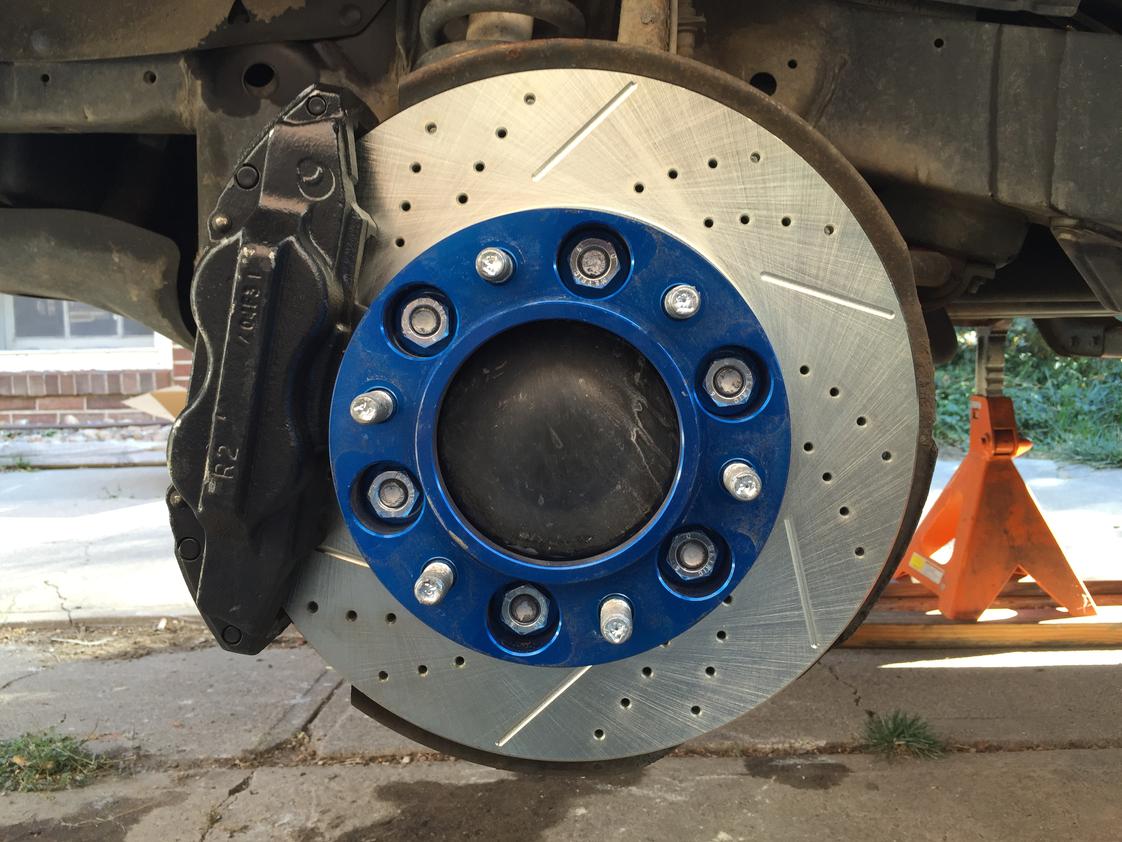

Little better now lol. Stoptech rotors and pads with the 13WL calipers from an '03 Sequoia. They feel great so far.

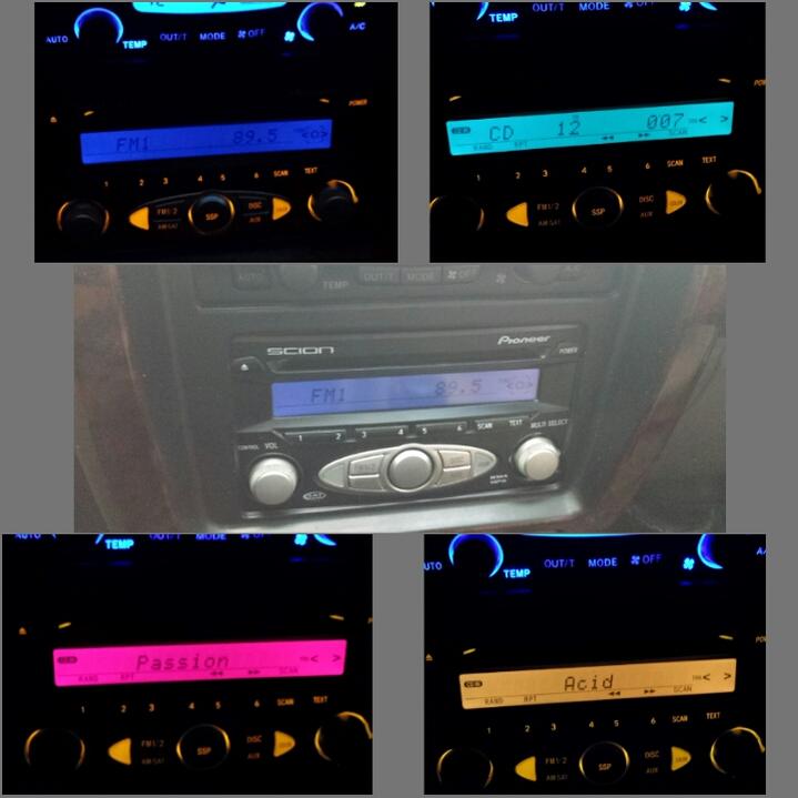

Junkyard finds
Went looking for Tundra calipers, came away with pair of limited rear mudflaps I'm going to attempt to trim and make fit the front and this Pioneer T1806 HU out of a 2005 Scion Xb. Still repairing the aux and ipod ports i had to cut out but the radio sounds great and love the color changing screen. Essentially plugnplay save for some light trimming on the back of the dash.

What do you mean by repairing the aux and iPod ports? I'm considering swapping out my pioneer FHX820BS for something simple and more OEM. I may go this route so I'm curious what you needed to modify.

When I removed the HU from the donor Xb, I wasn't able to get the entire length of wire to the aux and ipod jacks (they are located near the e-brake). Basically I could pull the wires out save for the area within the actual dash. I didn't have the right tools and I was sweaty and tired, so I cut what I could reach out, which was about 1.5 feet from both ends (HU side and plug side). Yesterday I soldered the two ends back together of the aux jack and it works/sounds fine (no buzzing). I may skip repairing the ipod cord as I found this Scion Pioneer Radio Apple iPod Interface Cable SC12235 | eBay
So if you don't do a hatchet job on the wires on the stuff you find, then disregard that part of my post. The only thing you will have to slightly modify for the HU to fit is a little dremel trimming around the back of the dash piece, two small areas on each side of the HU face (that would otherwise interfere with two insertion points for the dash piece) and two little notches for the power and eject buttons which are wider than the double din opening of our trucks. Other than that, just remove the old deck and plug the new one in: easy!
