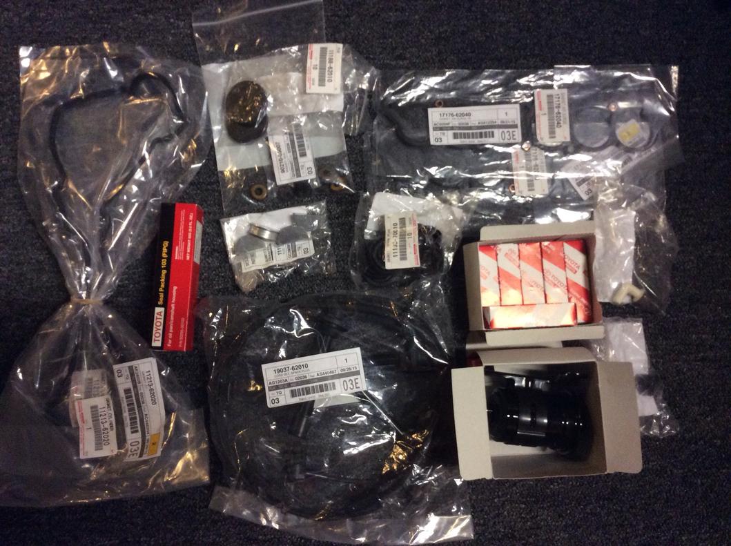

Looks like I have my weekend planned courtesy of Camelback Toyota :happy:
Can anyone see anything I've forgotten to order?
Total valve cover oil leak fix
-2 plenum gaskets
-2 valve cover gaskets
-2 cam end plugs
-4 half moons
-6 spark plug tube grommets
-16 valve cover bolt washers
-tube of FIPG
Tune up and general maintenance
-6 Denso spark plugs (I ordered for my 2000 and they sent SK20HR11 Iridium)
-spark plug wire set
-PVC valve
-PVC valve grommet
-fuel filter

They sent you the right plugs according to Toyota. Those are awesome plugs.

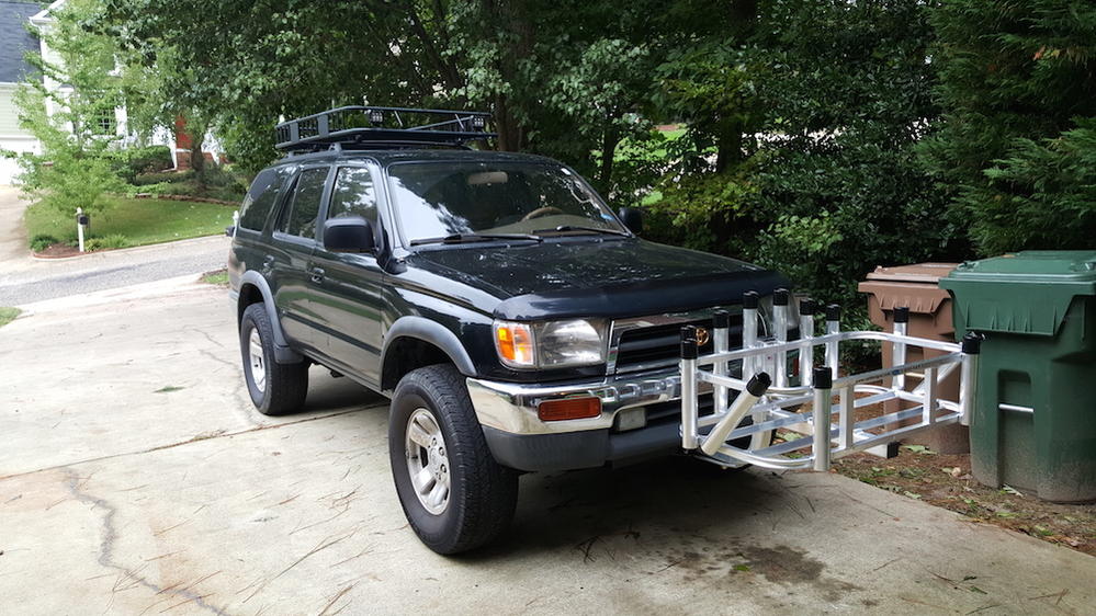

Got my front hitch receiver installed and my fishing cooler rack put on! Ready for the OBX next week!

I bought this one from Warn.
http://www.amazon.com/gp/product/B000CQDPWC?psc=1&redirect=true&ref_=oh_aui_detailpage_o04_s01
Bolt up where the tow hooks were, then drilled a hole on either side. The fit is perfect on my 96. The one complaint I have is that the hitch pin hole is too close to the cross member, so my locking pin wouldn't fit. Still need to figure that one out...

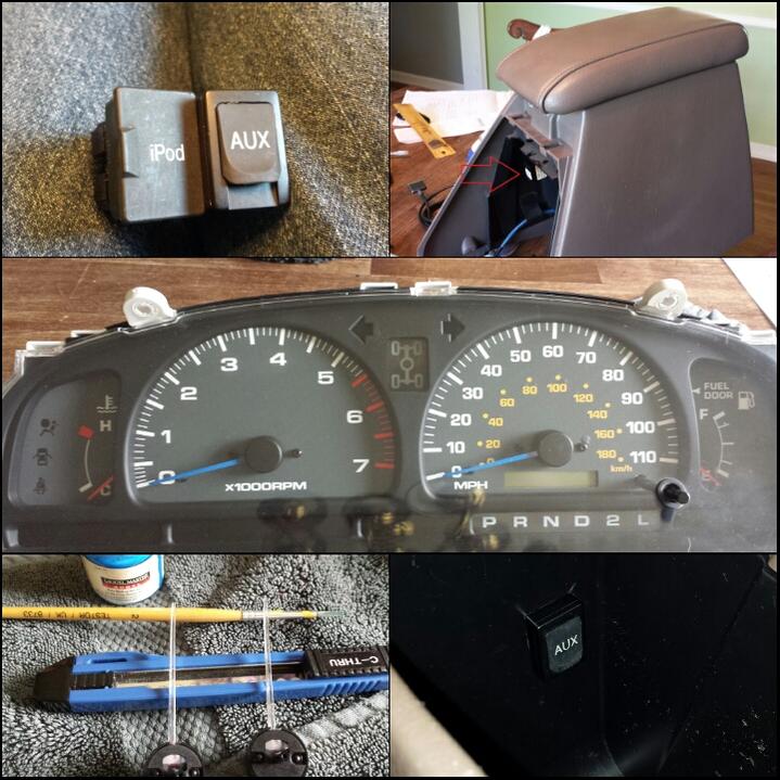

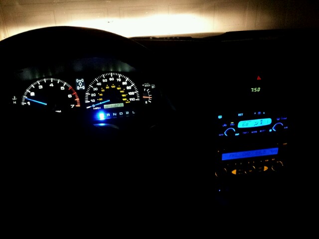

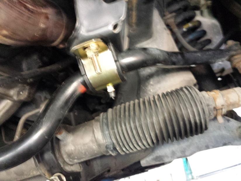

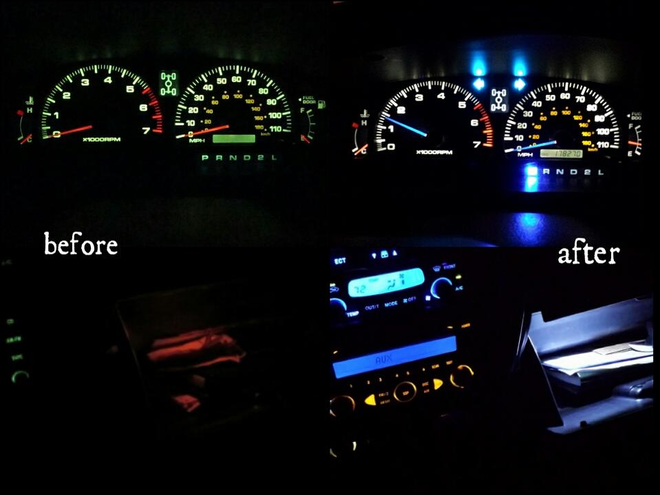

Front sway bar bushings, alignment, gauges and aux port
1. Installed new Energy Suspension front sway bar bushings (only two bolts included :/)
2. Alignment done in prep for impending road trip to California.
3. Installed aux port pulled from Scion xB in center console
4. Completed the interior gauge led swap. White leds for gauge faces, blue leds for turn signals, gear selector, key ring, cig lighter ring (took some modding), blue leds for temp controls and white for gear shifter and glove box.
