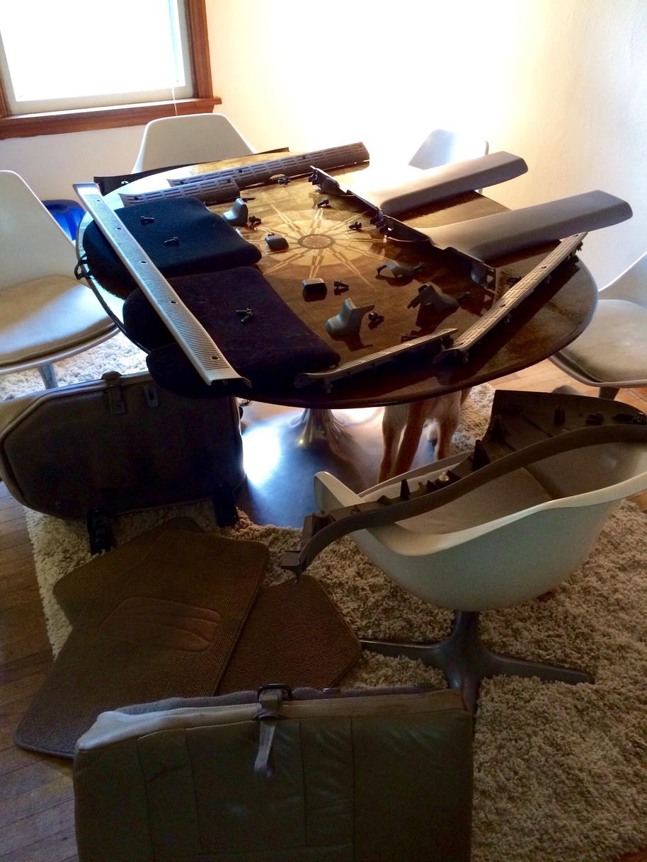

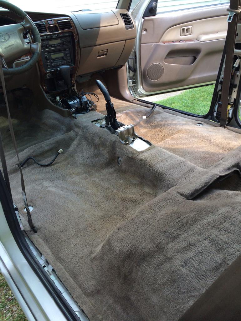

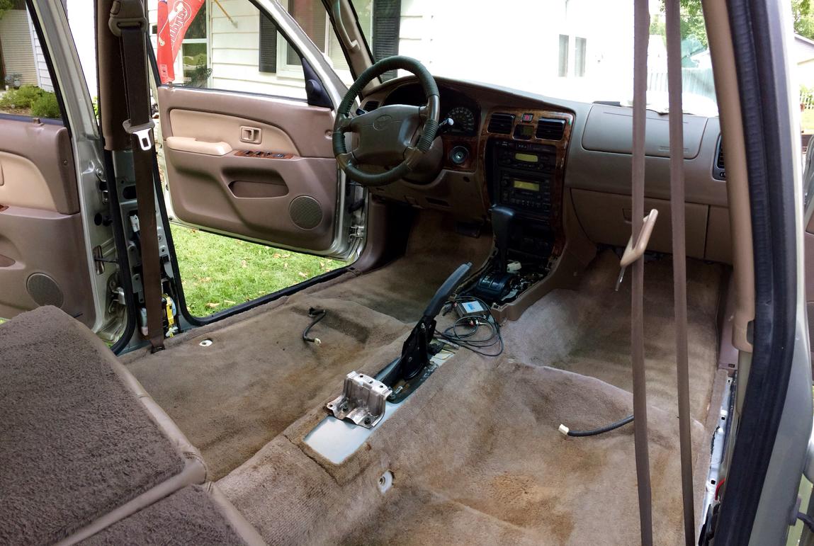

Decided to tear apart most of the interior in order to steam clean the carpets. While I had all the trim pieces off I took the opportunity to clean everything, right down to scrubbing the nuts and bolts in the sink with a scrub brush (the previous owner had spilled a not inconsiderable amount of coffee/soda... 100,000+ miles ago).
The before shot:
Sorry for the multiple posts; not sure how to upload multiple photos at the same time.

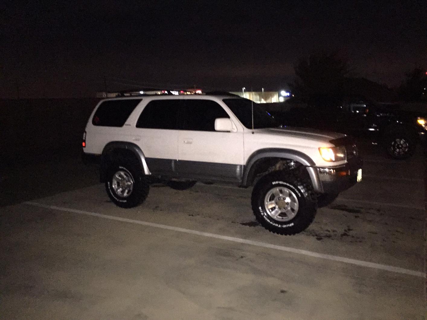

I put my lift on today too!
I struggled with the rear too. Getting those long springs in there was a pain. I got 3.5-4" from my new LC coils too. Then the bushings on the lower shock mount fought me until I figured out a decent way to put them on and the panhard bar was a pain to reattach. I really hope to never have to use a ratchet strap like that again.

I brought the passenger side down to 1" of threads showing from 1.25" and plan to do the same to the driver side in the morning as well as install my diff drop. I've got an appointment at firestone for an alignment at noon, I can't wait to drive this thing! It's amazing how good it looks and how much of difference a ~3" lift makes!
