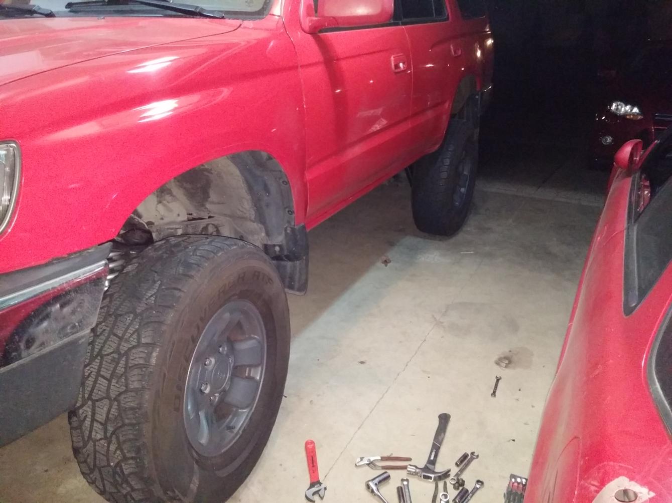

Getting the springs in wasnt that bad. I had it at full droop and got a big pipe and pry the springs into place.
Both shock nuts where rusted on, had to cut them. Started to cross thread the left side. Scary part was how easily it went on, for some reason I decided to stop and look at it

I had to leave halfway through the rear axle to go buy 6 ton jackstands because I couldn't articulate the axle enough with my 3 ton ones. I didn't have to deal with rusted shocks thankfully, my truck has no rust and the shocks were replaced with stock equivalents about 40k miles ago.

Haha I had some trailer stands that were a little taller than my 3ton. A block of 2x4 gave me enough lift. I have to redo my passenger front it is hitting at full droop. I am using the compresssorless method it was a pain with toytec coils.
I had the fully assembled Boss coilovers so it wasn't bad. I loosened the upper A arm to get it to droop more and then put my bottle jack on the upper ball joint nut and inner fender. Got everything to line up pretty quickly that way.
