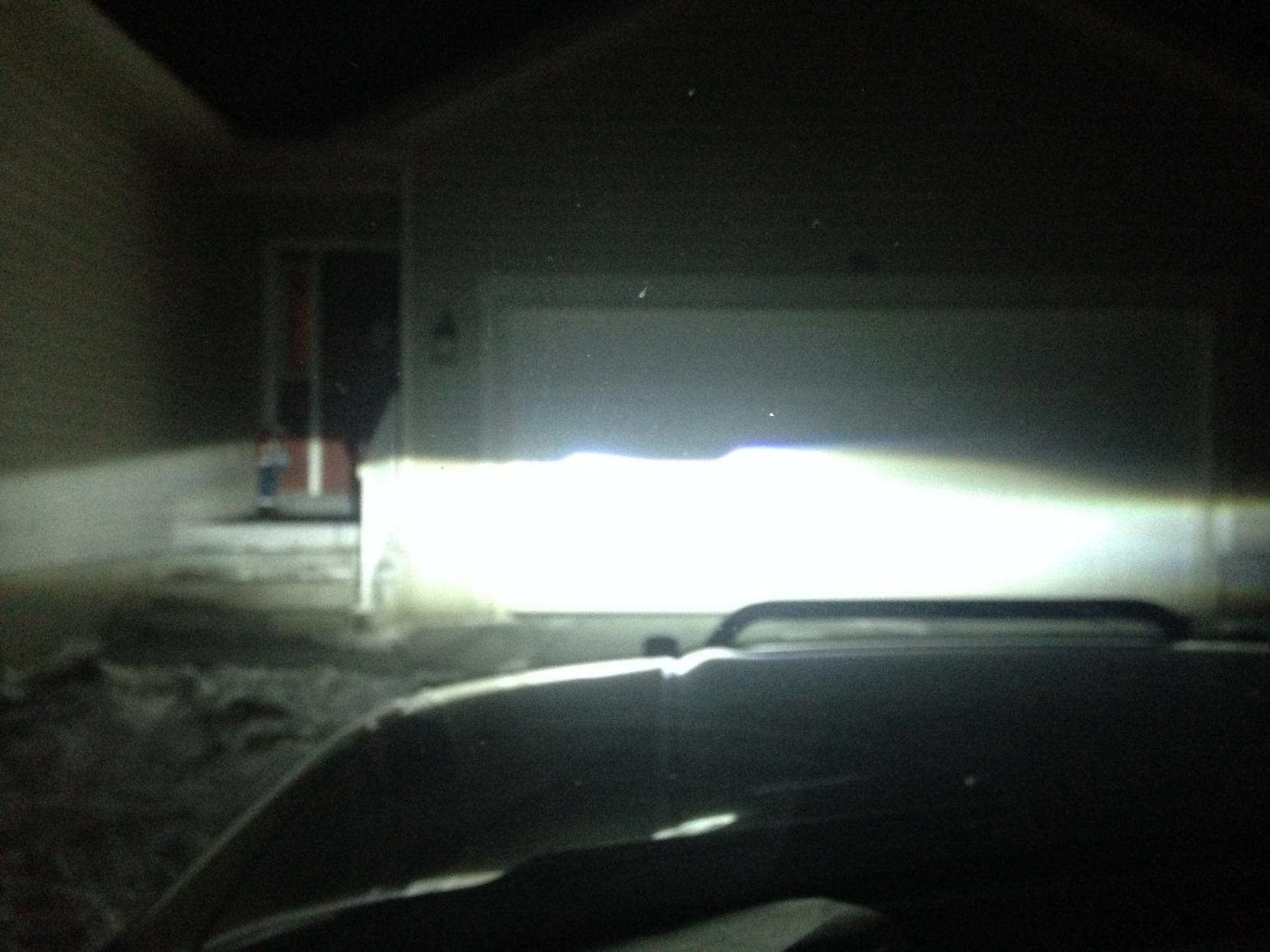

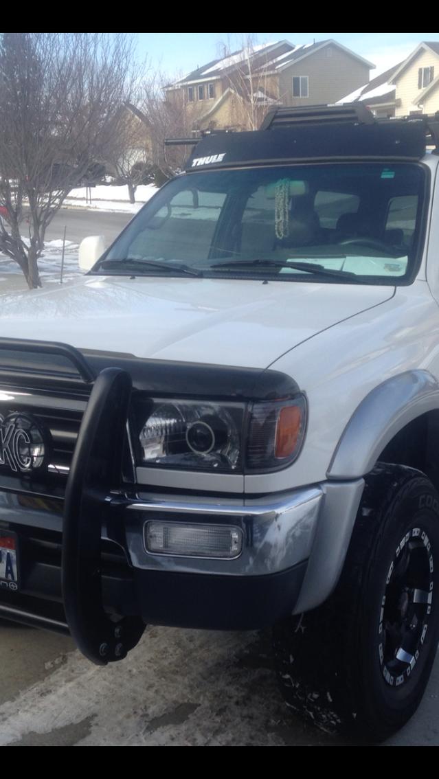

New Projectors with Halos, added driving lights and a rack this week. It's amazing I haven't gotten in a wreck yet the old lights where so dimm.

Ptojectors
Which projectors are those...? The output looks less than ideal, albeit much better than stock.
Your passenger side needs to come down to where the top of the cutoff is level with the top of the driver side cutoff.
To easily aim them pull as close to a wall as you can on a flat surface and put a piece of tape on the hotspot each headlight makes on the wall. Now measure 2" below that hotspot and put another piece of tape.
Back STRAIGHT up 25' and aim the top corner of the "step" on each projector cutoff to that lower piece of tape.
By doing this your headlights will be aimed straight (assuming that you backed straight up) and they'll drop the 2" over 25' as required by many state laws (assuming you did this on level ground).
