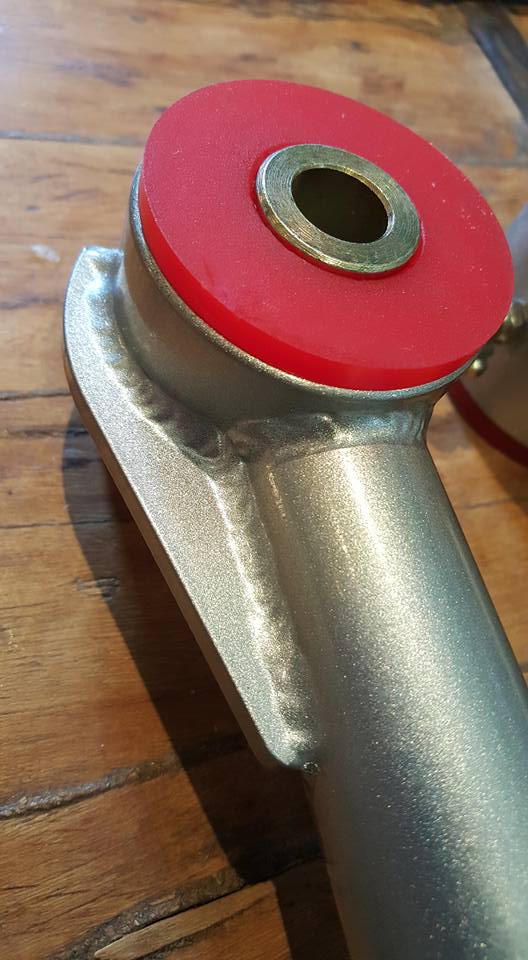

They literally arrived this morning, and I'll probably not fit them for a couple of weeks as I still need to build up my axle and rear breaks, and get the diffs built up.
First impressions are that they feel solidly build, quite heavy, very thick walled tube, and the welds look good.
Finish is an almost metal flake grained metallic silver, but they did arrive with a few scratches.

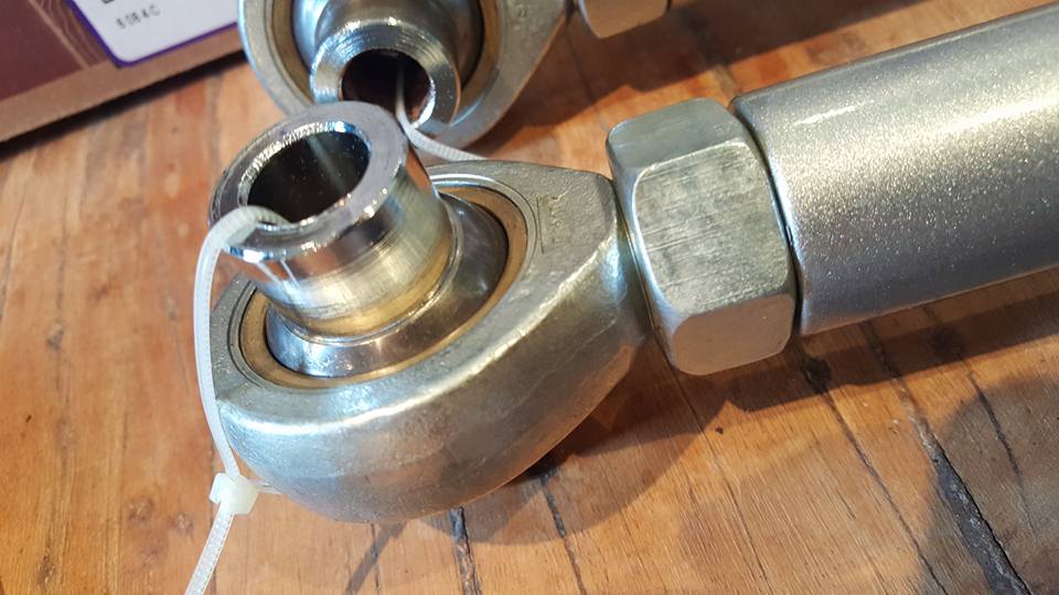

The bushes feel really hard, harder than my supra pro poly bushes (from memory, I've not compared side by side) the heims look ok, but they don't look like they are made of the highest grade metal. I guess if they wear they are easy to replace.
What I've learnt so far from one guy that had them: (second hand information not verified by me yet!)
  • The heims are metric come replacement time... (This is actually good for me as I'm in the UK.)
  • The ABS wire clips on the top arms don't fit the factory clips (no biggie, many aftermarkets don't even have those!)
