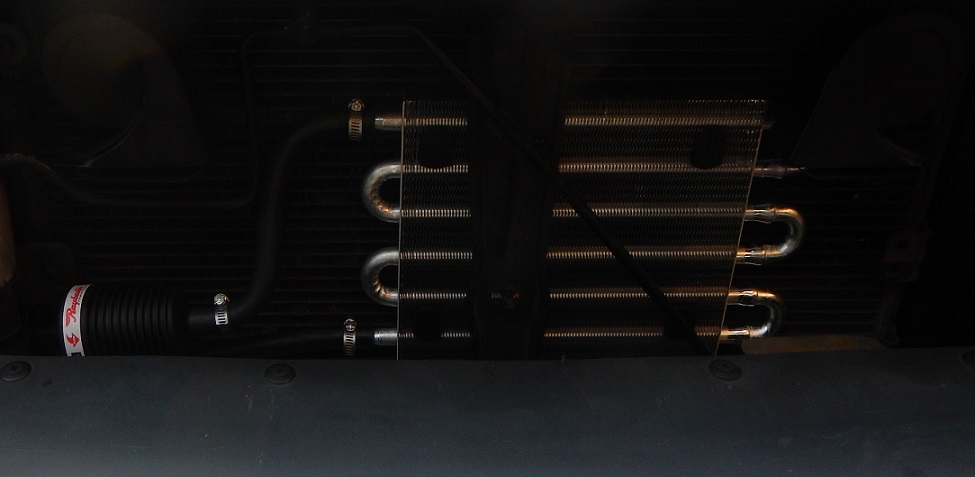

Replaced and relocated trans cooler and added an inline filter. The previous owner had already done the trans cooler and even installed it between the rad and condenser but had only secured it at the bottom end of the cooler. The top end was loose and swinging, smacking my rad and condenser causing potential damage. Pulled it and installed this new one on the front. I know, it's not the B & M, but I already had this on my extra parts shelf in the garage. The install was super easy. After I took this pic I shortened the hose between cooler and filter to reduce the angles of the bends and ensure good flow. Also moved the hose clamp closer to the filter.

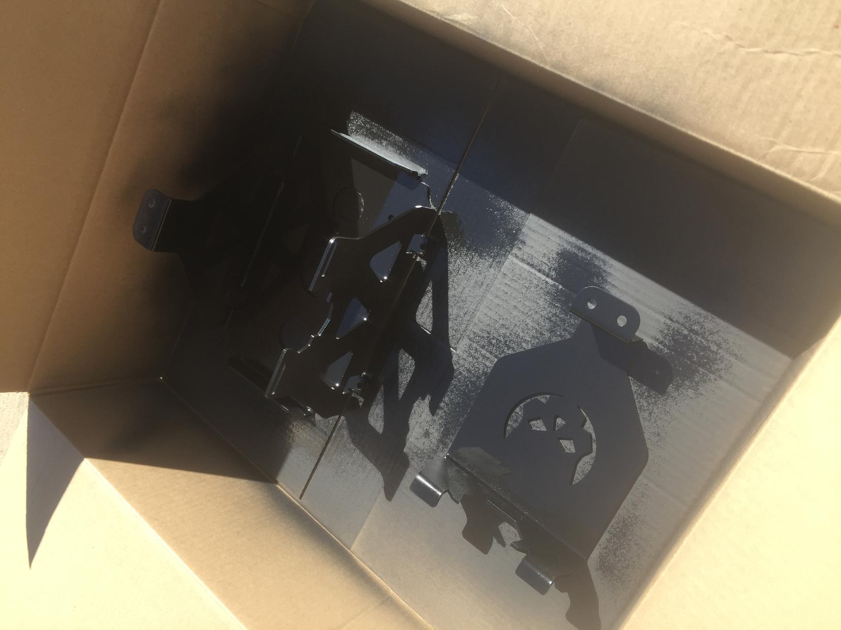

Got 85% through my TBU, ran into some issues. Got the parts on order. Painted my new battery box.

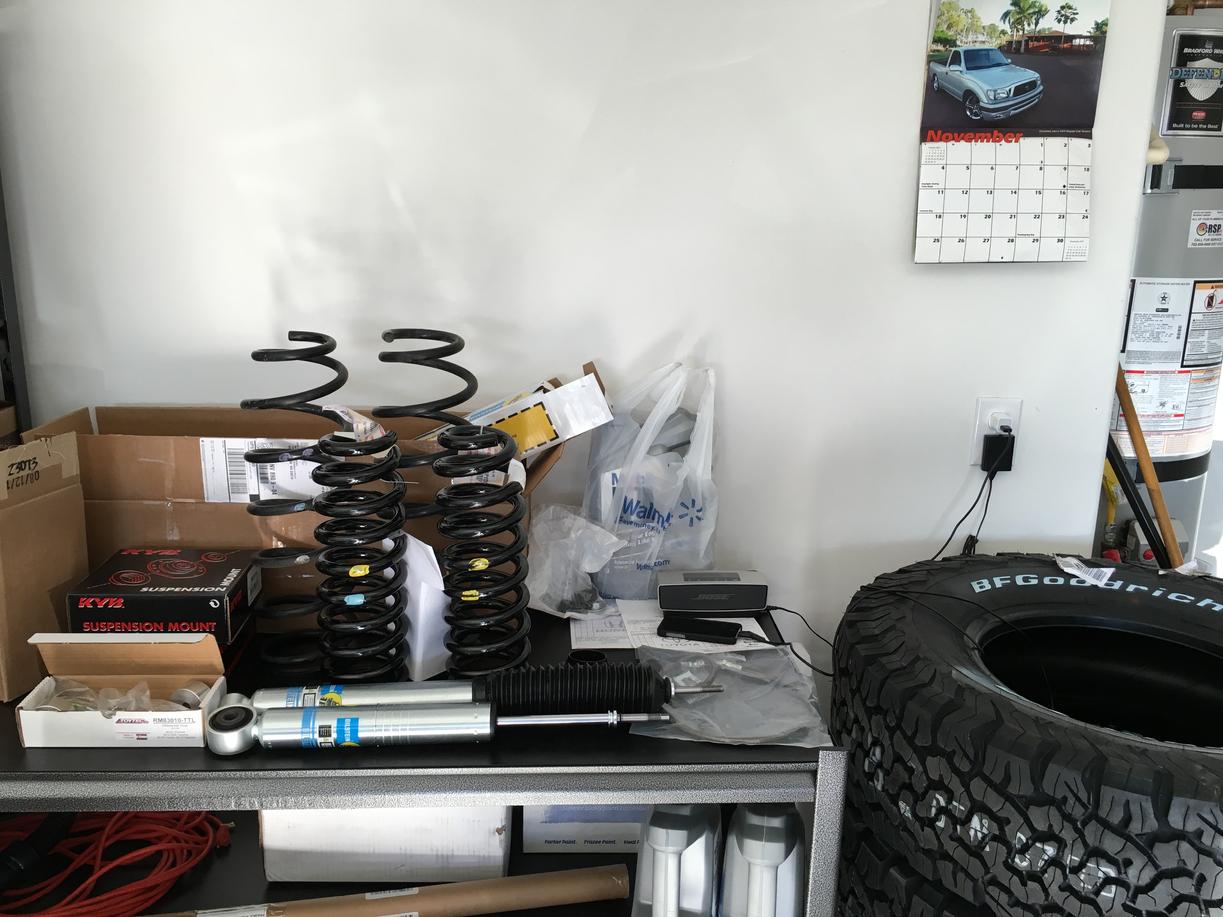

Thursday I started my bumper build. New tires and spare rim came in last week too.

Those are the AT3's right? I almost got a set of those. Ended up going with the ST Maxx, but might get the AT3's next time. Looks great man, can't wait to see them on the truck!

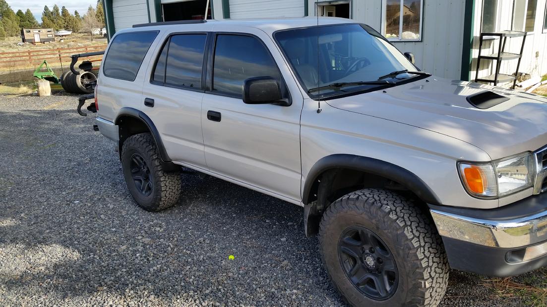

Began sanding for paint. Windows are now up :p all trim taped, and both sides sanded. Need to yank rear tail lights, headlights and corner lights, and the roof rack channels (some sort of torx that I probably have, somewhere). Then I can finish sanding, do a little hand sanding right around the trim, fix some rust under windshield gasket, and paint.
AKA I have a long way to go.
Painting flat single stage desert tan from my 30 gal compressor that I've used all of once since purchasing 6 months ago. Will refresh all my SR5 cladding crap in satin black and respray my bumper too.

Shoved some rope under the windshield gasket to elevate it. This isn't gonna be an easy fix and I'd prefer have the windshield pulled for the occasion but screw it. Pretty sure I can't make it any worse.

You've got bigger tennis balls then I do! LOL But good job, can't wait to see how it comes out.
