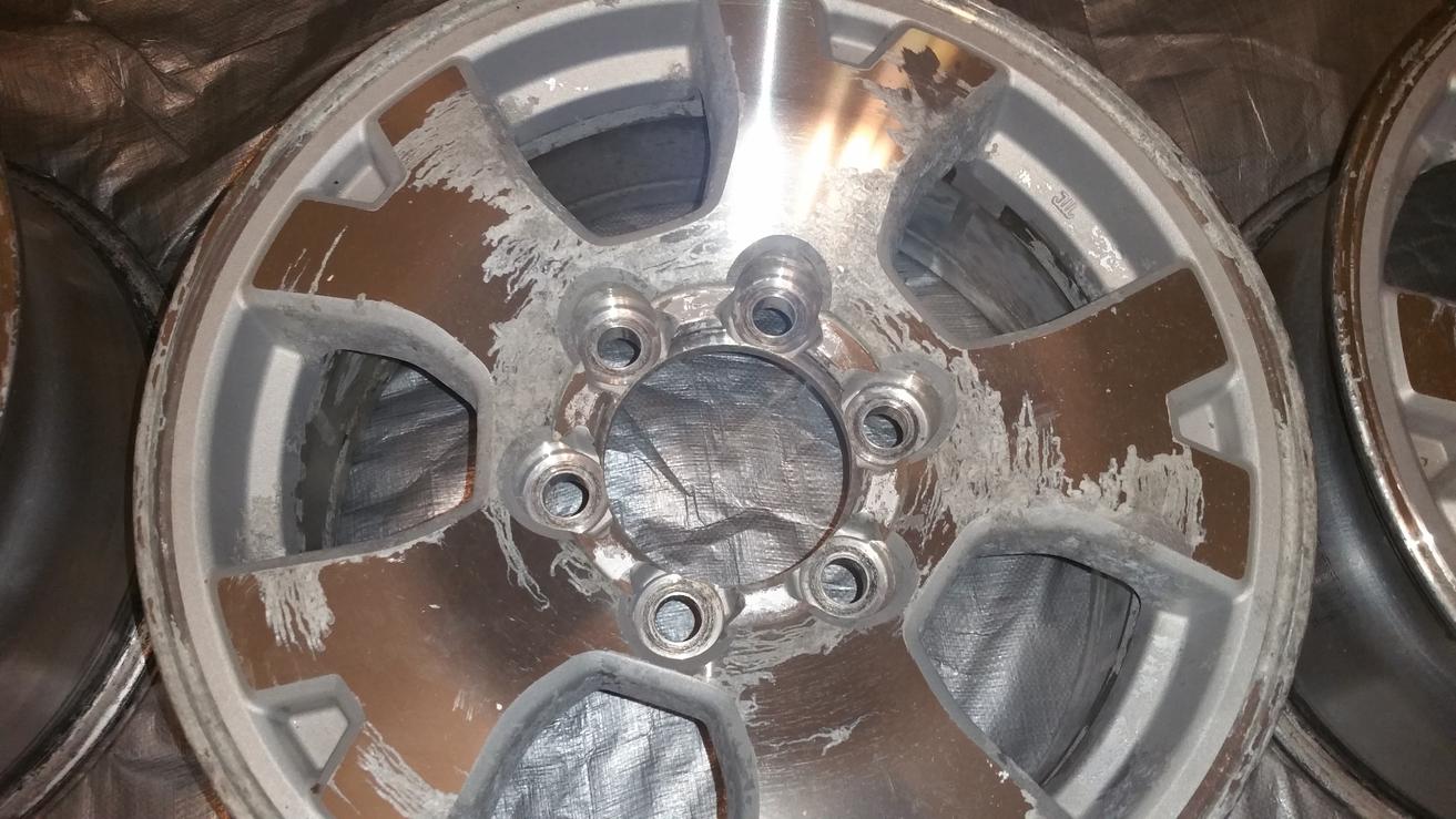

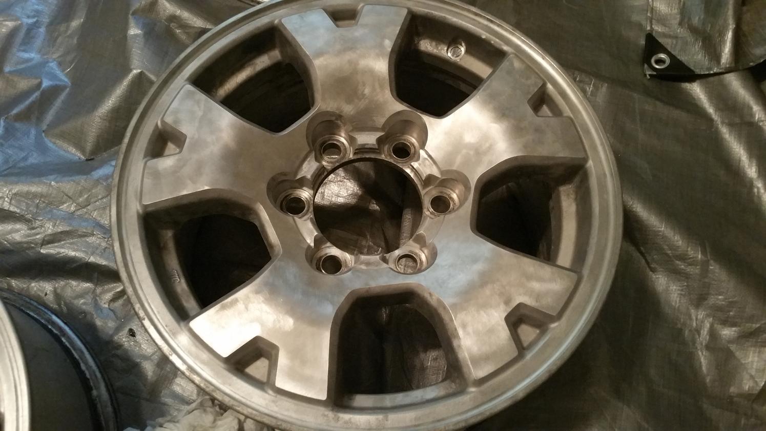

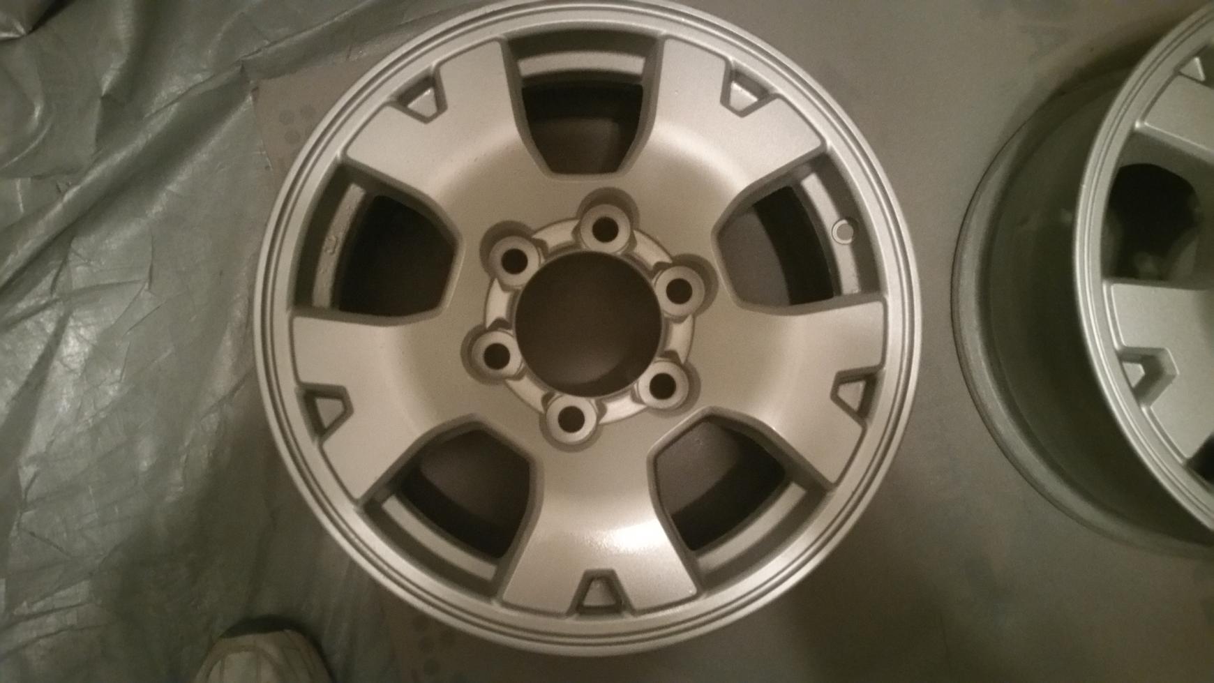

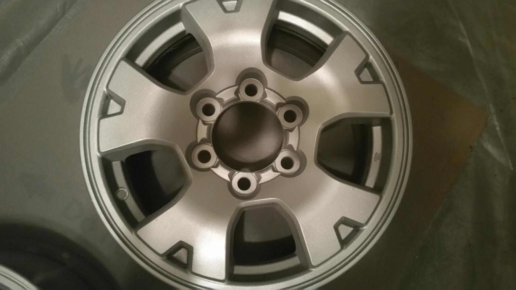

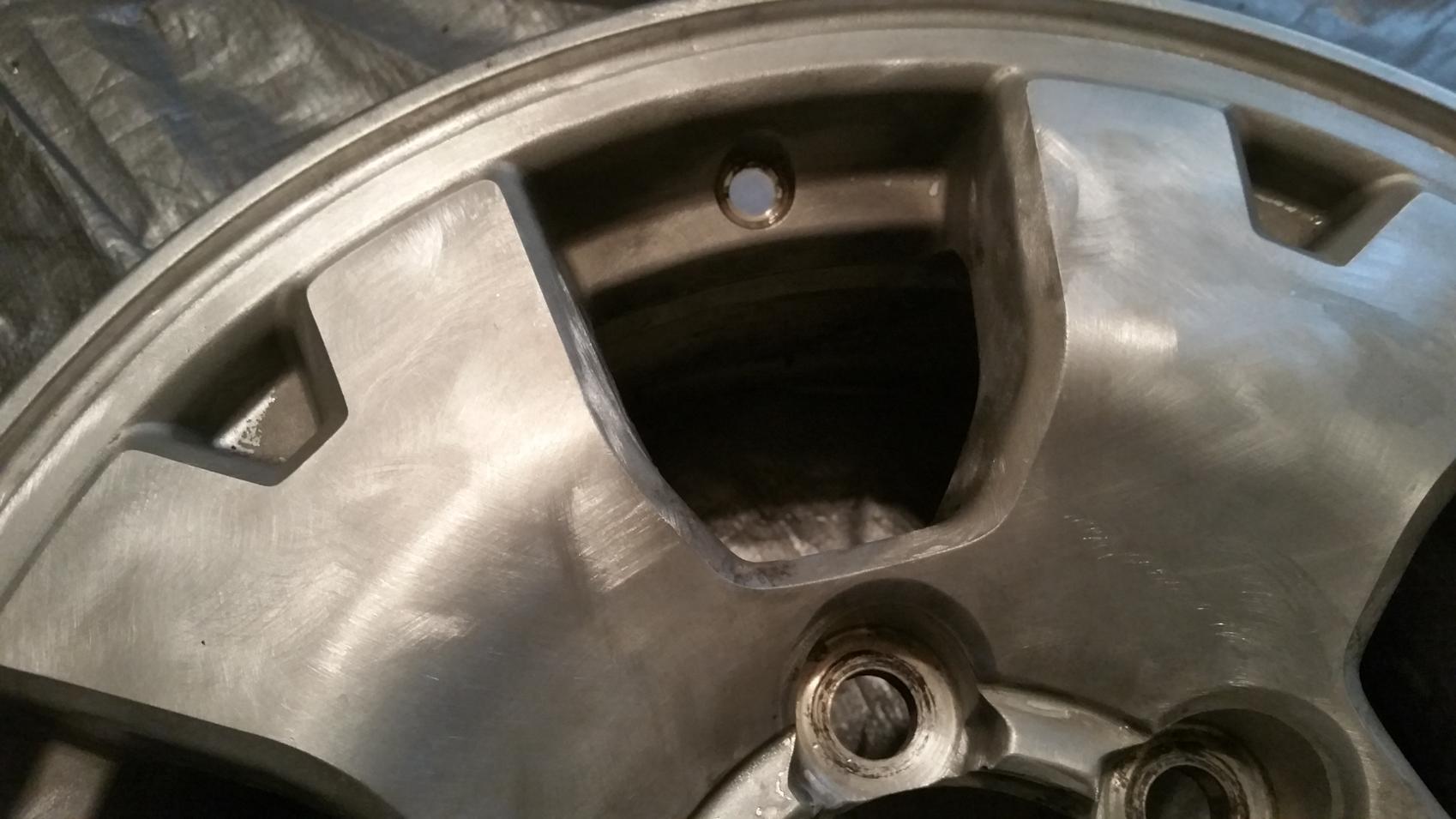

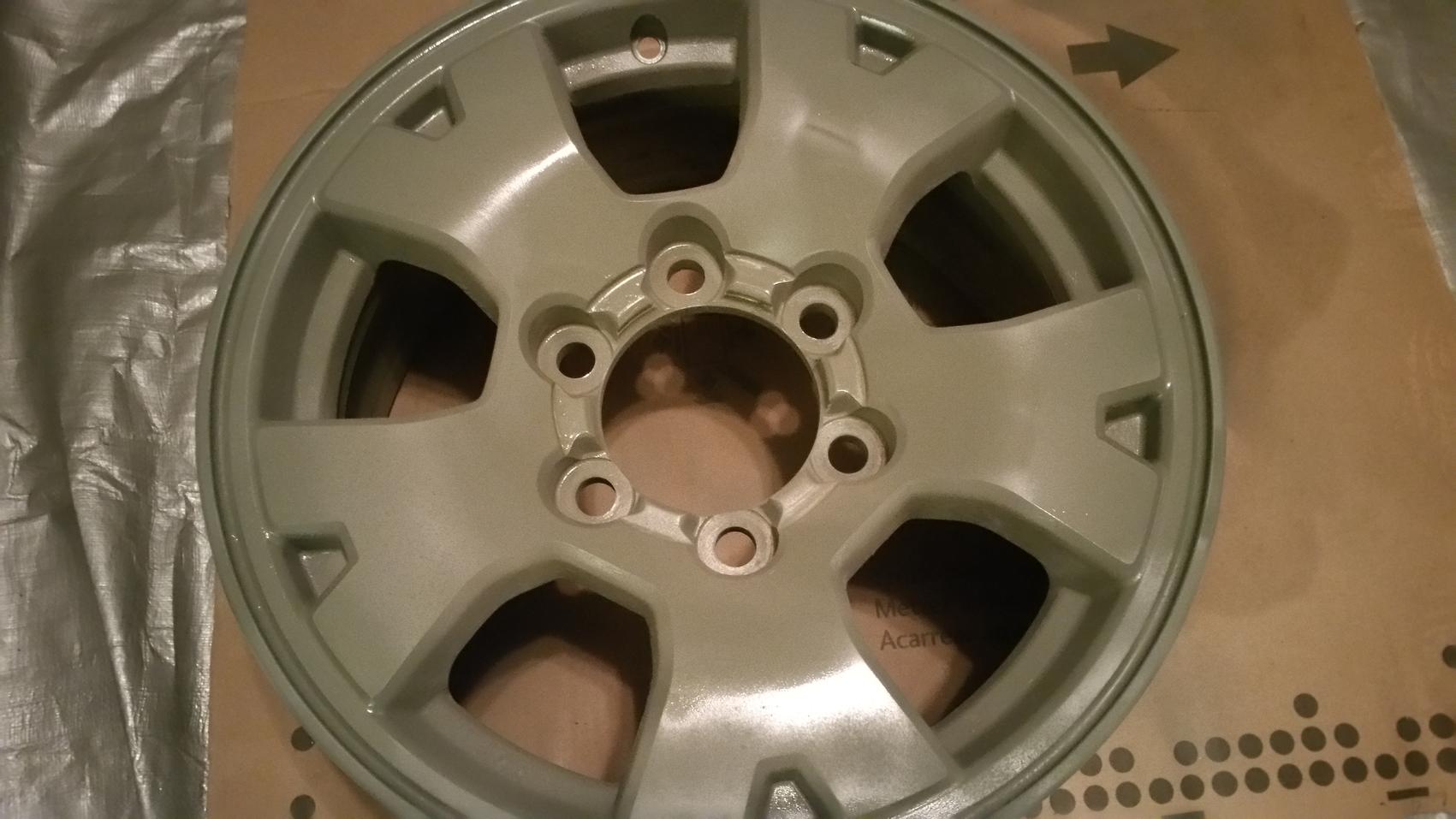

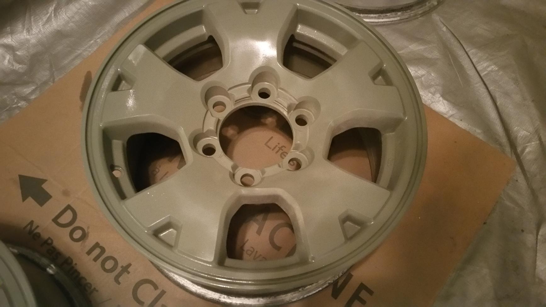

Cleaned and prep 2 wheels
I started on 2 wheels while it was raining outside.
Color is rust-oleum high performance wheel steel color. Not a hyper silver or bright. And it matches the factory wheel covers pretty good.

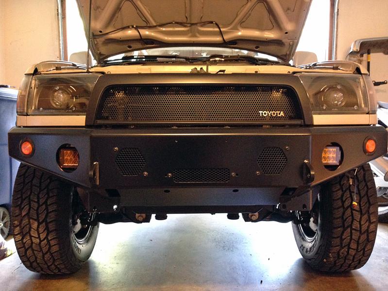

Finally got my bumper on, after much procrastination followed by some crafty use of a floor jack:
4xInnovation fronts and rears, with some custom grilles (to screen the access ports until I decide to add a winch) and Rigid D2's with amber covers for winter nighttime assist.
Super happy with the bumpers, only regret is not getting the tire carrier on the rear--the spare won't fit underneath, which is a bummer but entirely my fault (I measured the tire width with the vehicle's weight on it, so it came in just under the 30" limit... of course, without the weight, it's just slightly too large. Damn.) So, no spare in the meantime, and likely a carrier later this year.

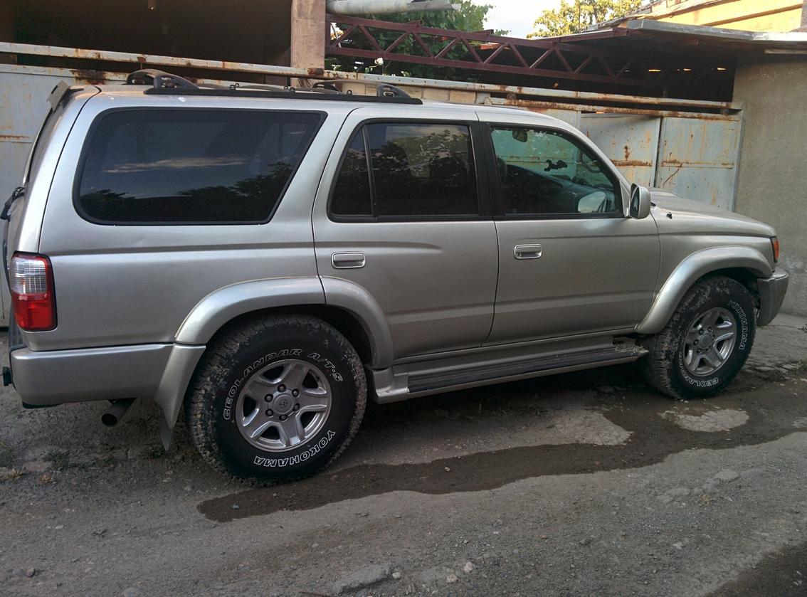

Yokohama Geolandar AT-S
Put new tires, Yokohama Geolandar AT-S, 265/75R16, rubbing on full turn while moving, with stock suspension, seems like this tires are pretty big compared to other 265/75, specs say 31.9".IMG_20160529_194534.jpg
