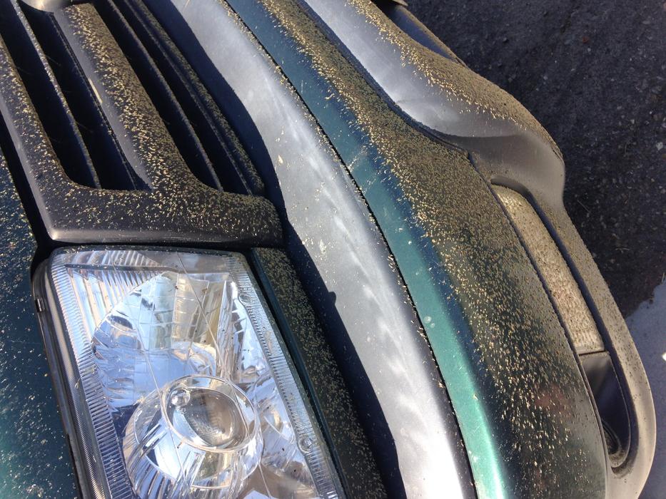

Installed new black housing headlights today. I was surprised when they came in and found they were made with actual glass and not plastic. I took the filler pieces out from under the headlights and thinking about getting amber LED bars to put in the void for turn signals.
Do you have a link to those?
