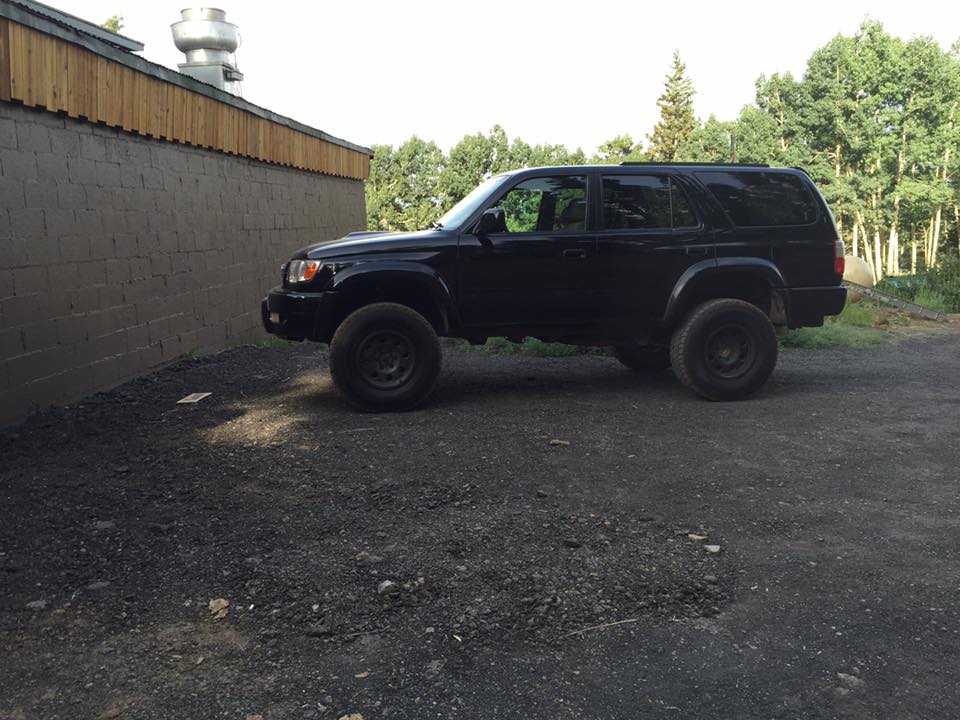

Got new (to me) wheels & tires for a steal, 285/75/16 Discoverer ATP's mounted on ATX Mojave Teflon wheels.
I think I'm gonna keep the tires but ditch the wheels for my factory Sport wheels. I'm just concerned I'll rub the UCA with no spacers...

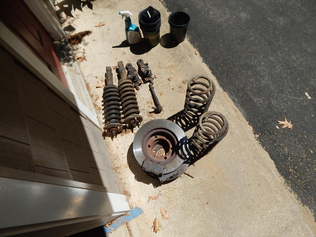

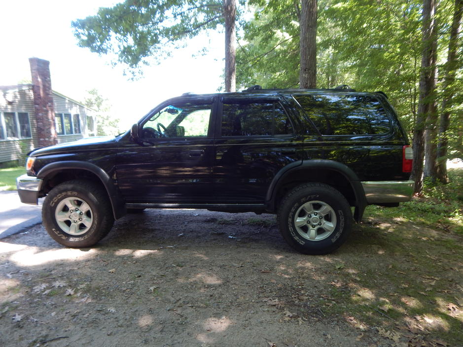

Took the pictures today. Over the last few days installed new oem lbj's with new bolts, brembro rotors with stock pads, outer tie rod, ome 906's, tundra trd coils, and tundra Bilstein 5100's all around. Never done anything like this before. Had Wheeler's Offroad assemble the struts, so I didn't have to compress the springs. Many thanks to this site--especially Speedy's and mtbtim for their videos. Notice that the rear shocks aren't pictured--had to cut those bad boys off. Cheers
