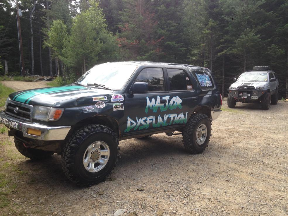

[MENTION=141557]TeamLord[/MENTION] ...what kind of tires are those and what size? those look gnarly...
and because of south park, now all i can think about when looking at your SN is LORDE.
Hahaha!! Thanks [MENTION=102606]infamousRNR[/MENTION]
Our tires are Super Swamper TSL Special Service 9/34x16 and they are VERY gnarly. Helped us claim over 70 trophies in less than 3 years! :wow:

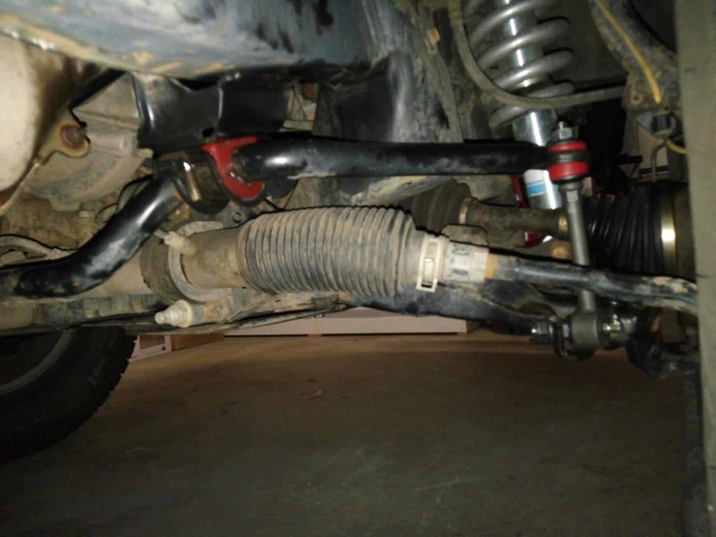

My original sway bar link bushings were toast and one link joint was busted after 14 years of fun. So, I replaced both links and installed new Prothane bushings that I ordered from Amazon. A relatively easy installation following T4R owner recommendations.
