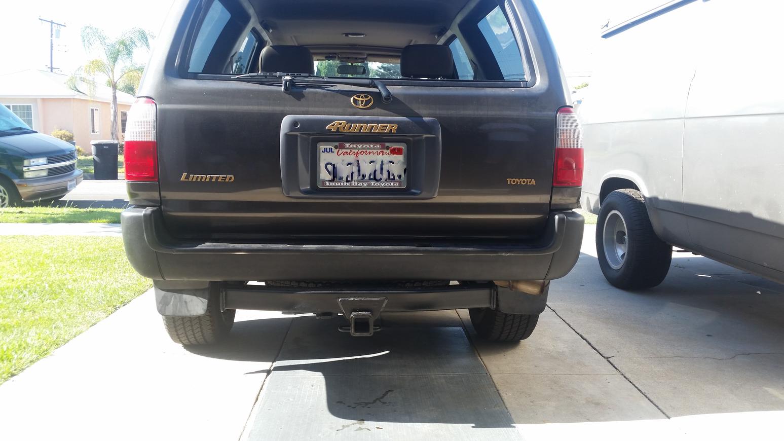

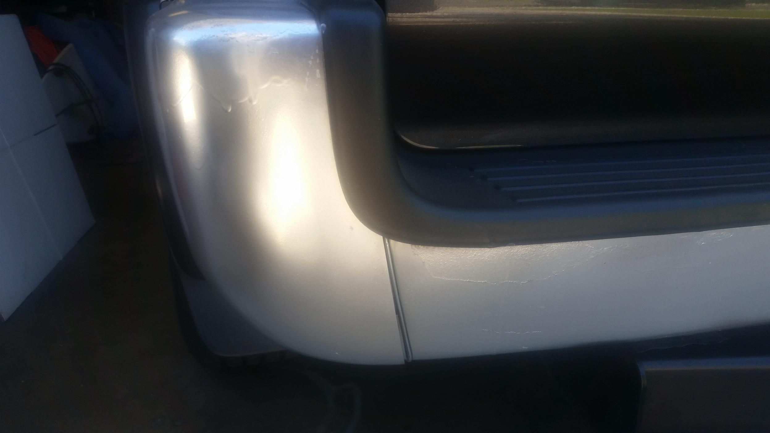

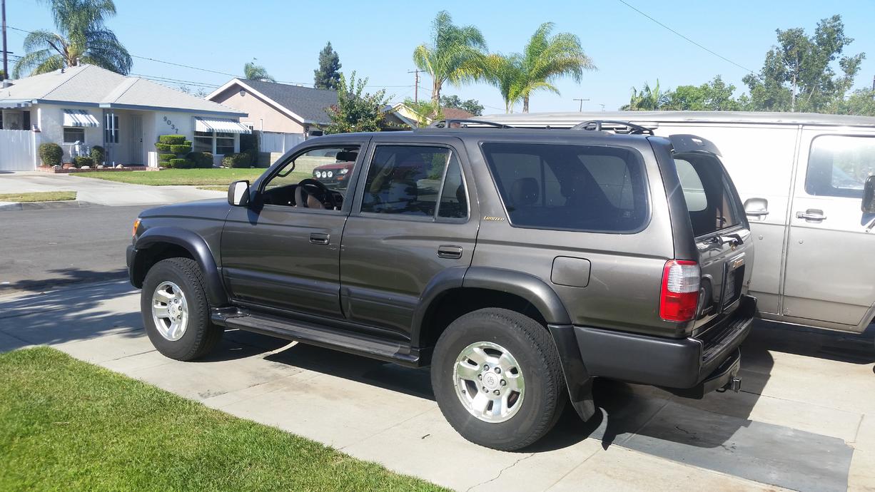

Today I decided it was time to plasti-dip the grill, front and rear bumpers. My first reason for doing this is I really don't like chrome on trucks, and the previous owner did a terrible half ass respray on the rear bumper with chrome spray paint.
Before
After
MUCH better

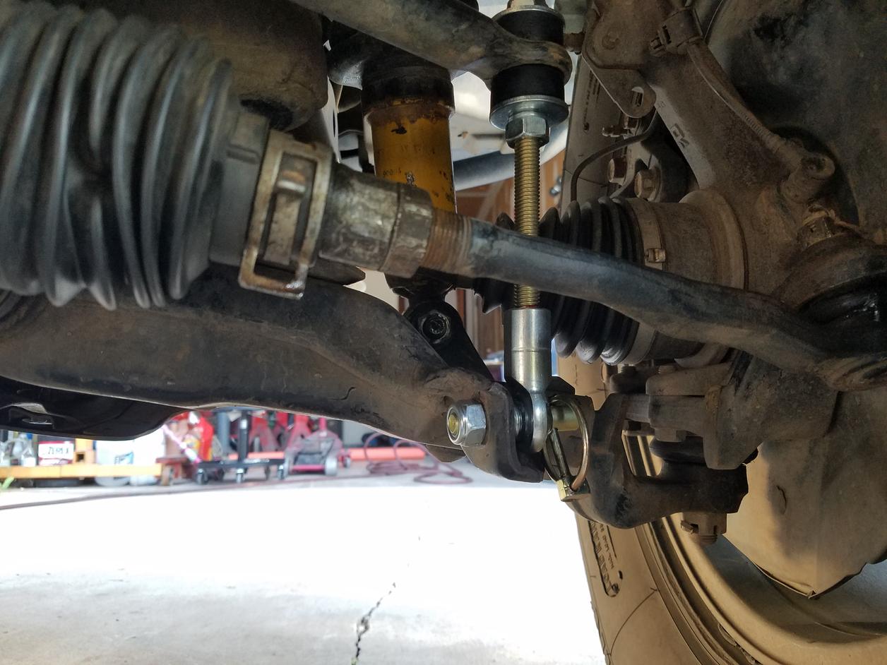

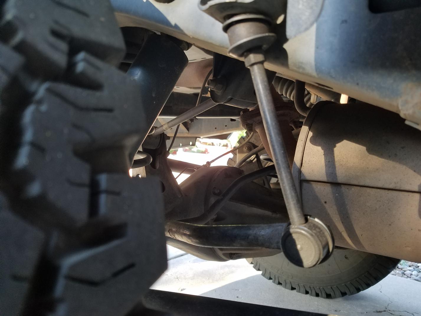

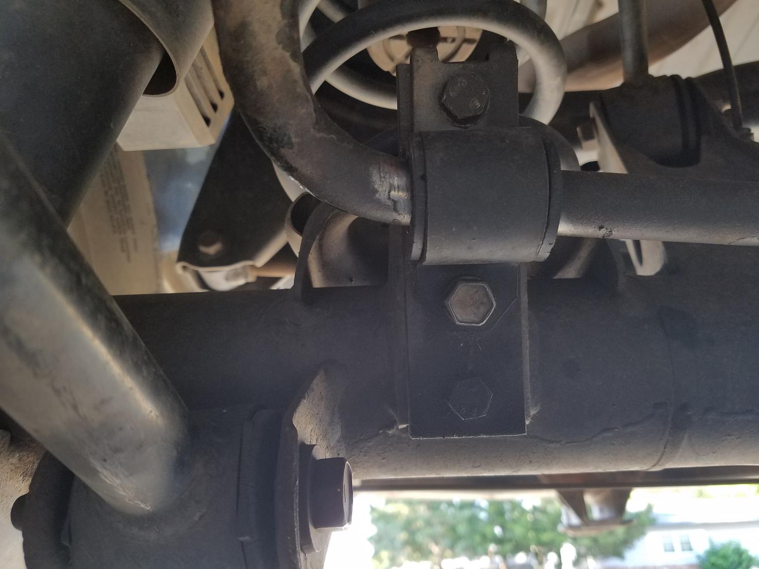

Finally got my front and rear sway bars installed and it's definitely night and day difference. Bought parts store junk links that broke on the trail first day. When installing poly bushings I sheared a bolt off. Had to recap it.
I was waiting for mstudt to make me a set of links but has been in hiatus. I have a trip to grand canyon in a week and could not wait any longer.
So tapped the broken bolt on the SS sway bar lift brackets. Poly bushings. Bought the expensive 2nd gen Moog rear links. Hoping the extra length helps them from breaking. Installed some wabfab front disconnects.
Now my rig feels complete with the sway bars connected and adjustable panhard bar installed. SPC arm's at setting G and aligned I have eliminated pinch weld rub. Life is good again.
