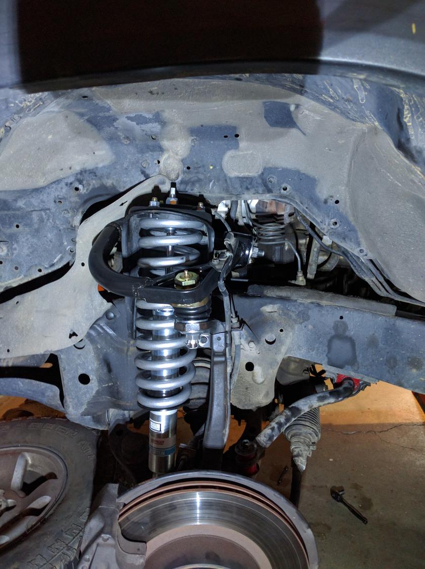

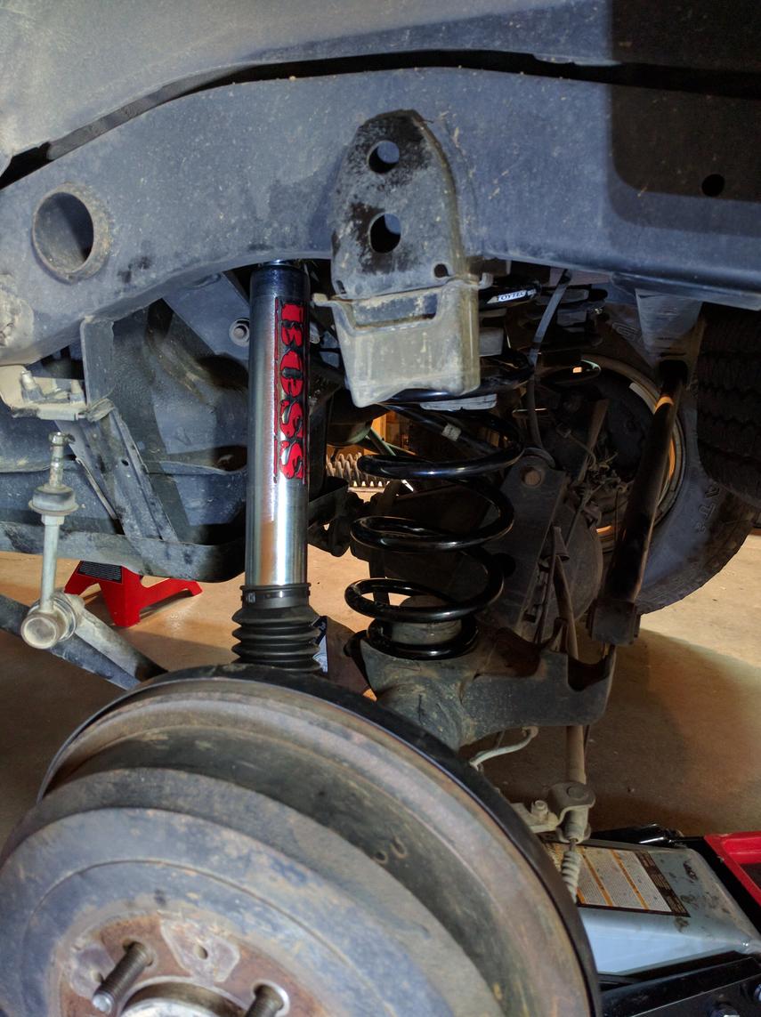

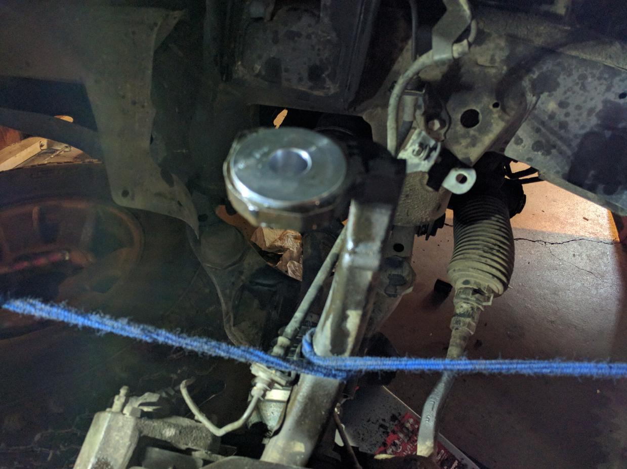

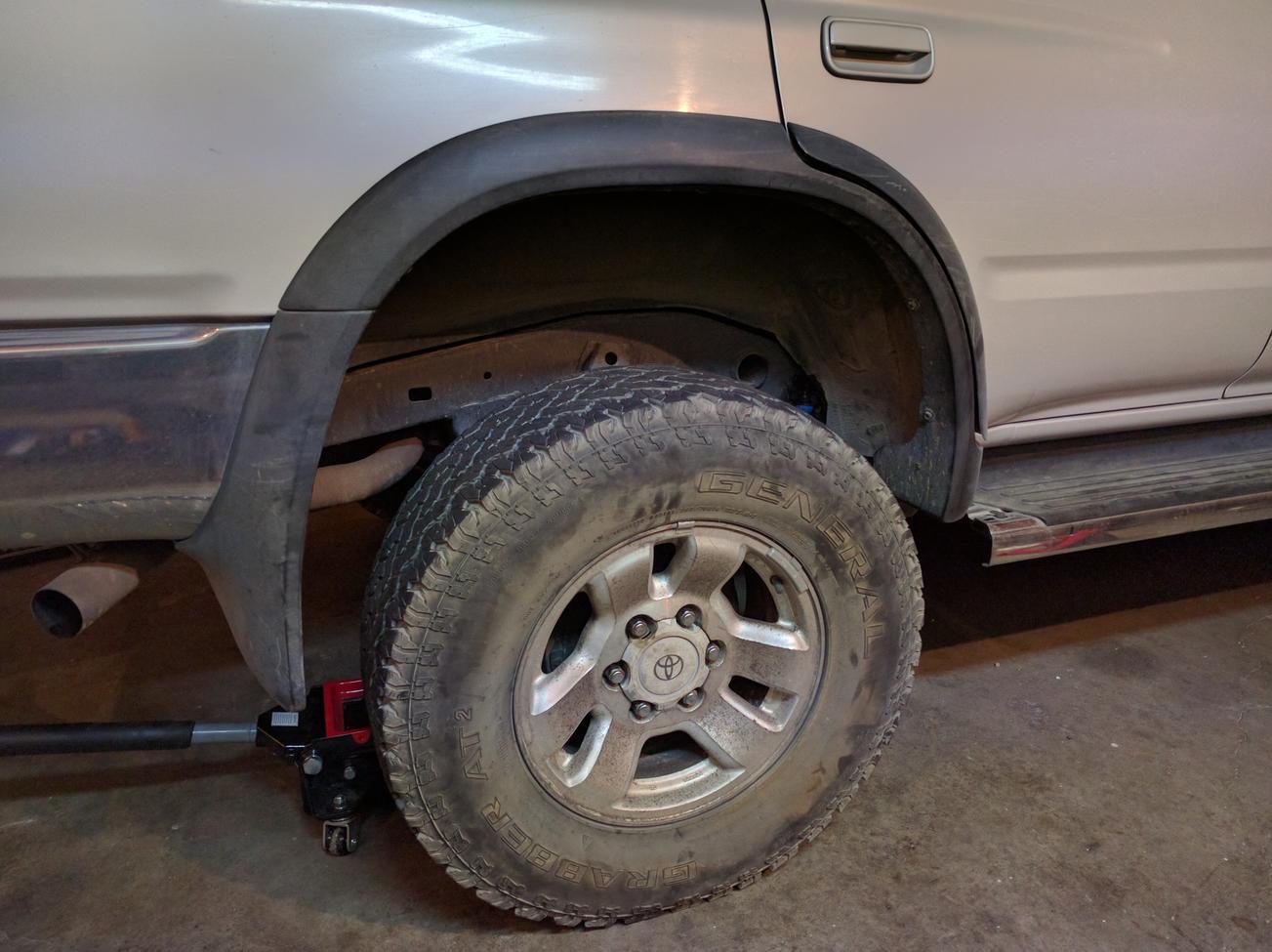

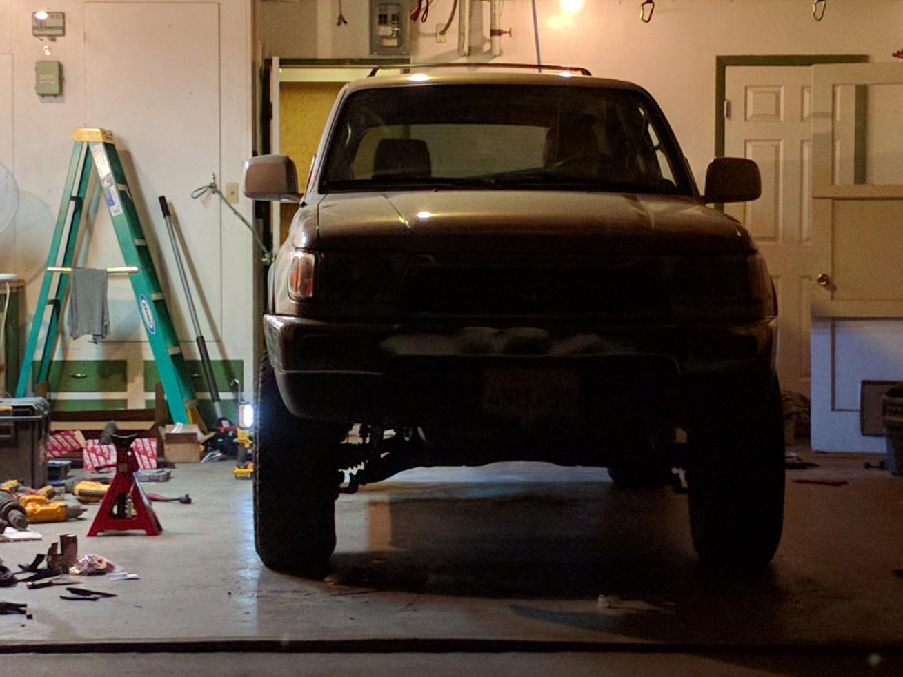

Put a lift on it last night. Also put on SPC upper control arms and sway bar bushings all the way around. It's this toytec lift. All in all it was about ten hours of my time with some of that making coffee and posting cool shit on the interwebs. I took it on the highway to test it out and it still cruises straight at 80MPH. Then I took it down some well known dirt roads and it felt super smooth. The ass end didn't wash out once. Pre lift height was 20.5" all the way around. Post lift it's sitting at 24". I'm sure it'll settle out a bit but I'm happy with it so far.
The hardest parts where getting that damn upper bolt on the rear shock off. In the end a sawzall made it pretty painless. The smell of cutting through the bushing alone was worth it. Just glad the wife wasn't home. The other thing that I sort of forgot I had to do was press the old UBJ out of the spindle and press the new bushing for the SPC arms back in. A quick trip to Oreilley's and I had a free ball joint press kit. Of course it didn't have all the parts to make it perfect but after cutting a piece of 1.5" black iron pipe to size it worked out great.
Here's some of the fun.

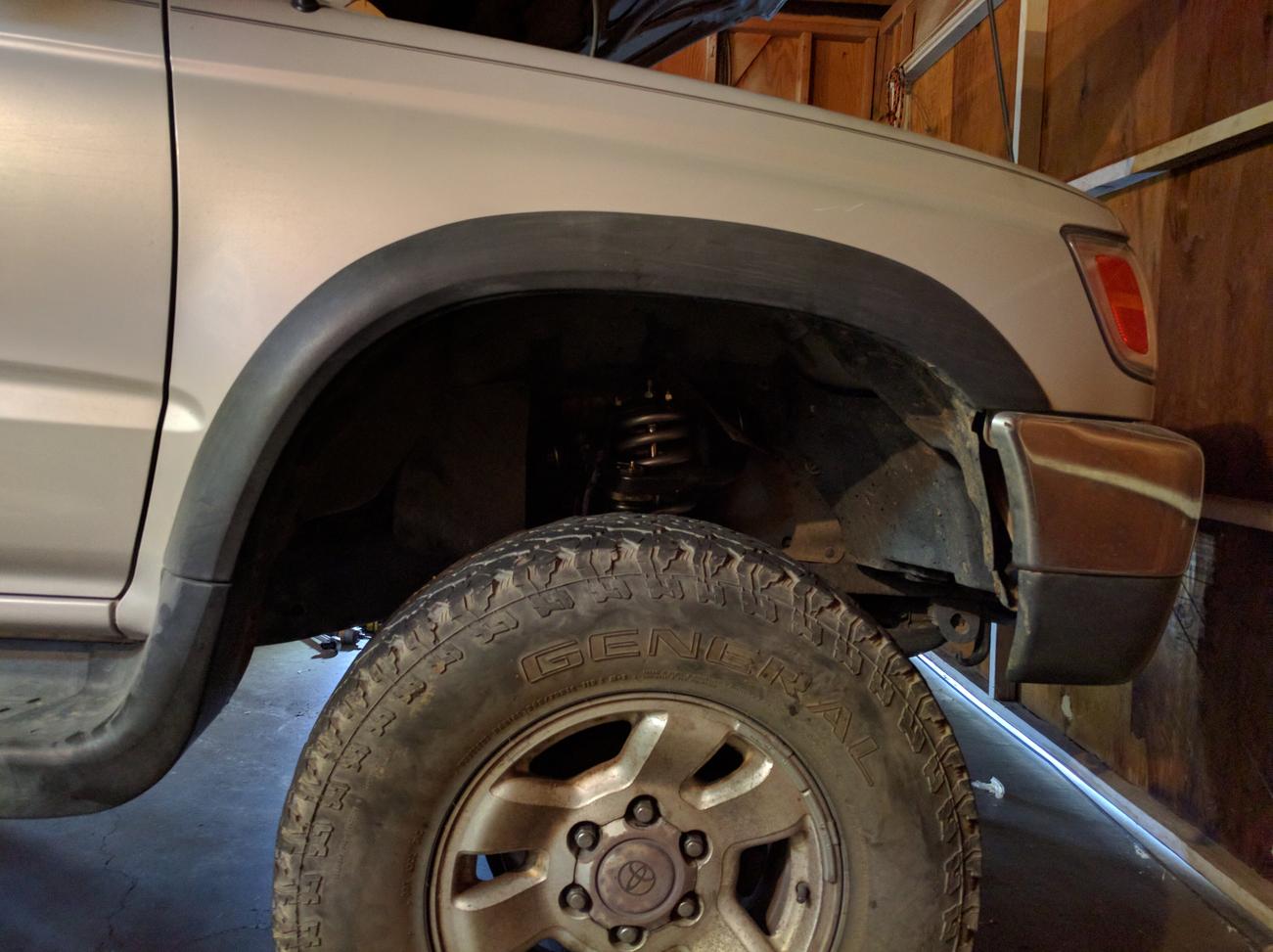

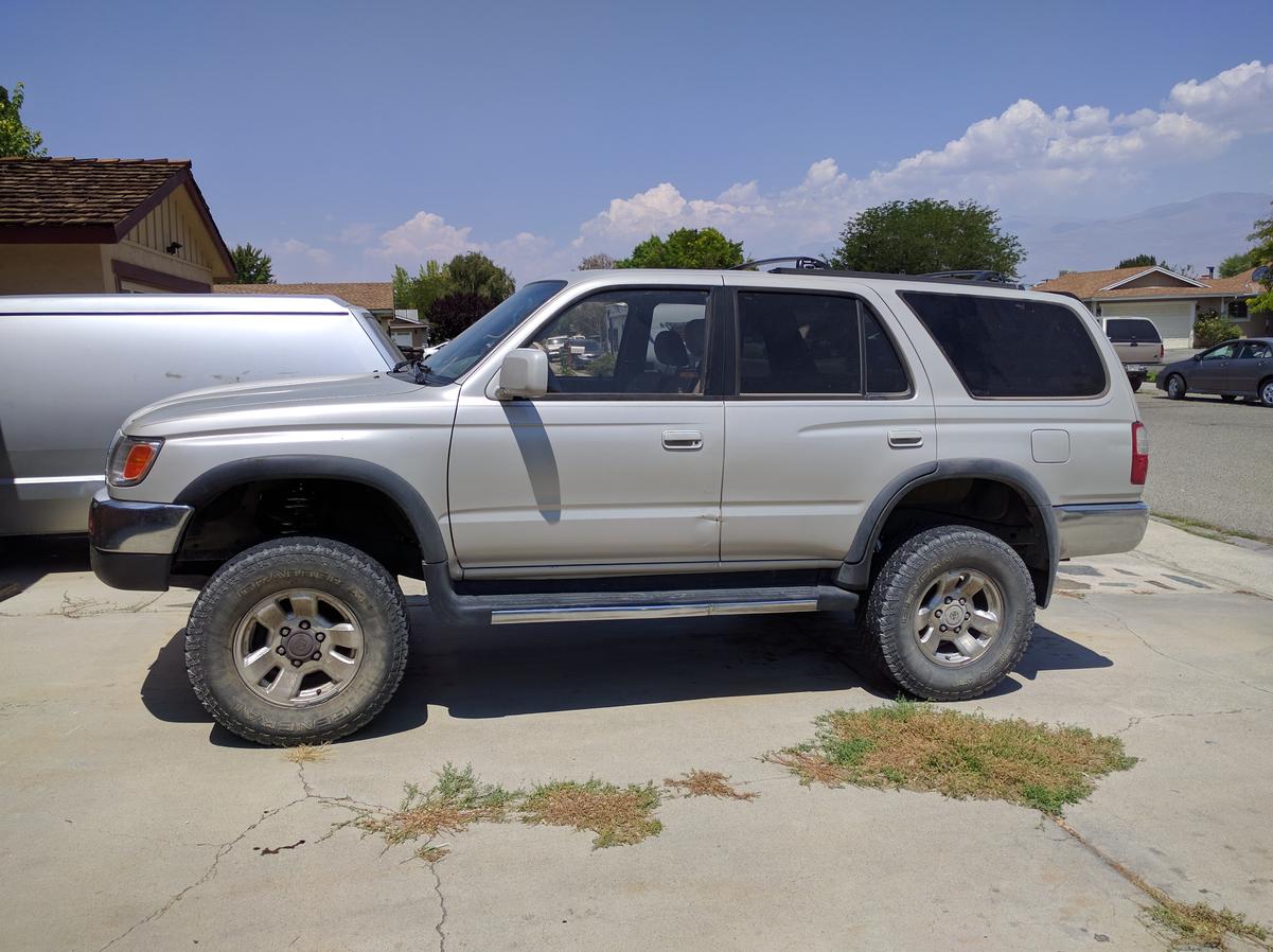

Front looks a little high. I would crank the front down an 1".
Sure. Send me some adjustable coilovers and I'd be happy too. lol
The measurements from center of hub to fender are the same all the way around with a 1/2 a tank. Could be the incline it's parked on is throwing your eye off?
That could be it. I guess no rake looks unnatural. From looks like it has 5" of lift.
It's more lift then I expected for sure. About 3.5 inches from where it was before. I'm hoping it settle out a bit in the next month or two. At full flex the rear brake line is really tight. I might add the extended. It's also still got the stock 265's on it for now. I'll have to live with that for the next 10,000 miles at least. If I dump any more money into it now the wife will not be happy. She's also the reason the factory running boards are still on it. lol We purchased this to replace her astro van and it's slowly morphing into my weekend rig.
Next in line would be a front bumper and sliders. Then the brake upgrade. Then tires and possibly new rims. I plan on painting the stock bumper black and having a local welded weld some hi lift points up. Then maybe black out the lower rocker panels and doors. First I have to remodel our kitchen though. Once that's out of the way I'm hoping to have carte blanche on the 4runner.
