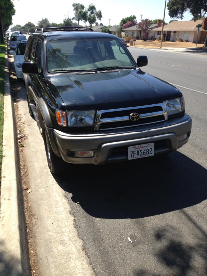

what I did today!
Purchased a 1999 2wd Limited with 180,000 on her. So excited to start cleaning her up. Today I locked the battery down, replaced wiper blades. Goes to Toyota tomorrow for a once over and fluid change. The TO DO list so far...
1. shift selector handle replacement. It comes of and the O/D has been disconnected.
2. The fog and front running lights do not work and needs to be investigated. Hoping for bulbs but it seems strange that the whole front lighting system does not come on.
3. Remount the Hazard light switch as well as the unit that holds the rear window button. They both push back into the dash
4.Get rid of the feet smell!!! :toilet3:
Any advice or suggestions would be great! Thanks all!!:bluejump: :bigok::playball:

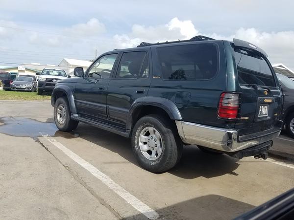

I havent done anything per se, but I did go to my local island stealership (which not only steals your money but never has the parts you need....ever), and I saw this in the parking lot.
This is literally the nicest looking 4runner on this entire island. I can count on 1 hand how many 4runners I've actually seen here and this is by far the best looking one. No rust holes visible, no dents, Original windows and its a limited :naughty:
