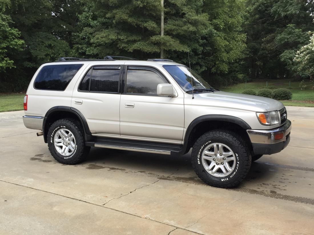

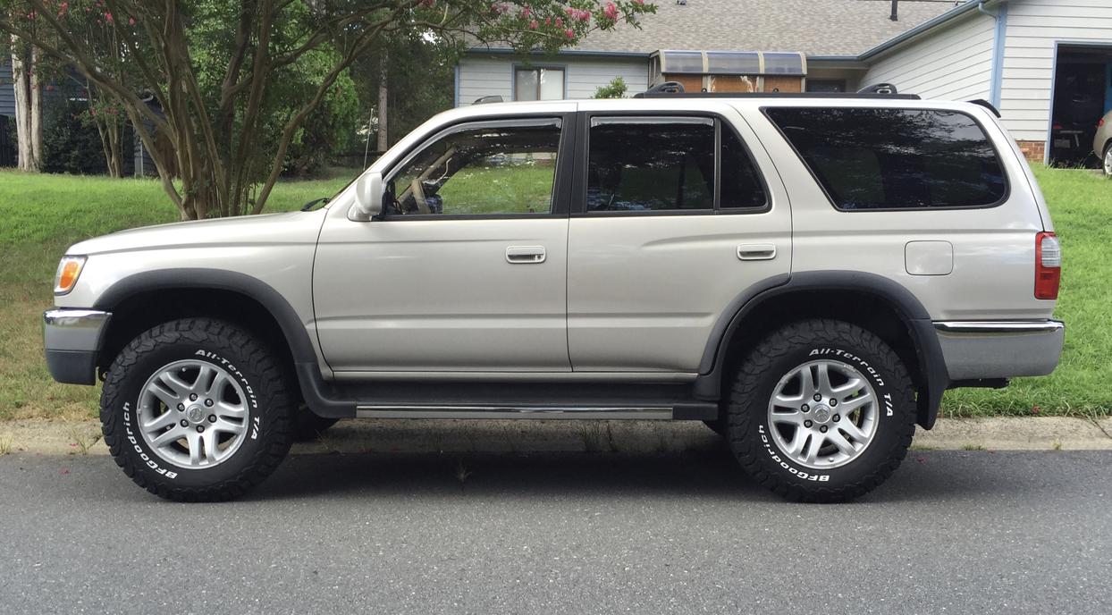

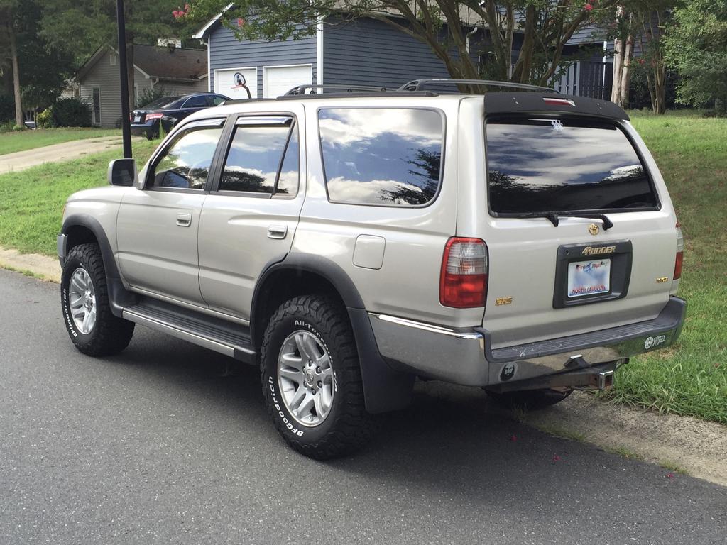

265/70/17 KO2's
My new to me '98 SR5 2wd 4Runner. I just rolled 200K miles.
Tundra 5100's front [24-188265 or old #F4-BE5-6929] and rear [24-100144] using old stock 2wd springs up front, new rear 2wd springs (old Toyota recall was still open for my 4R).
Tundra 5100's on second from top (4th from bottom) snap ring setting, (measured roughly 2" lift) and a Daystar 1.5" rear spacer lift [KT09107] on top of the new 2wd springs. Resulted in about 21.0" Front; and 21.5" Rear; measured hub center to fender. This is with a full tank of gas.
With the 265/70/17 BFG A/T KO2's (31.6" tall according to BFGoodrich) mounted, there is 5.5" fender gap Front; and 6" fender gap Rear. Again, with a full tank of gas.
It's a very subtle lift, and just looks leveled which is exactly what I was hoping for.

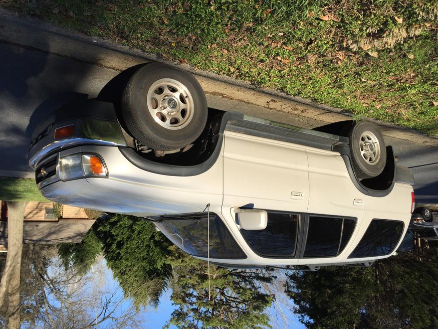

I have no idea why the last pic is upside down. The last one is how I brought it home. 15" Enkei factory option with 225's.

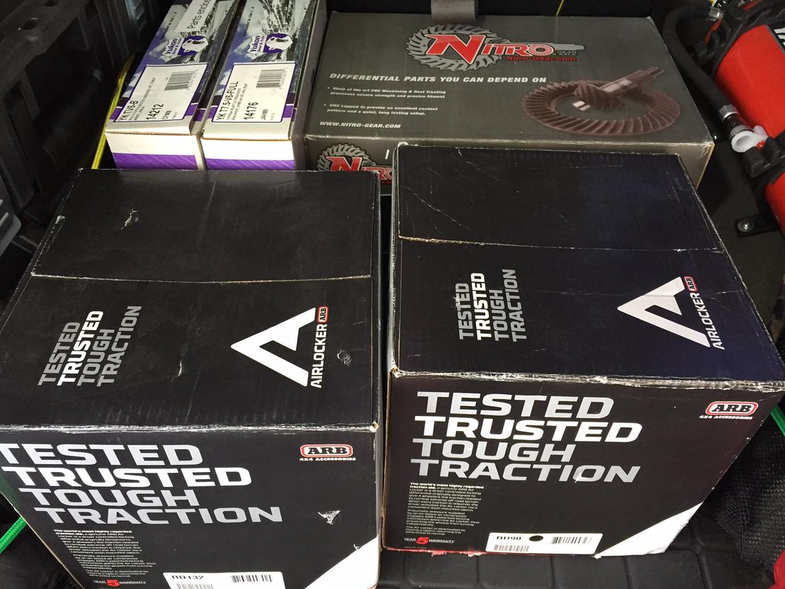

About to get Real!
Well these just arrived. It is about to be fun. Thanks to ECGS for the Fast service and shipping.
