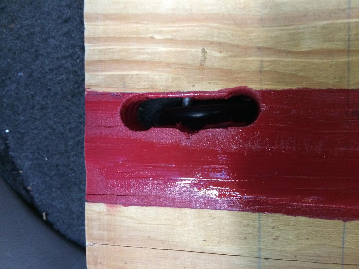

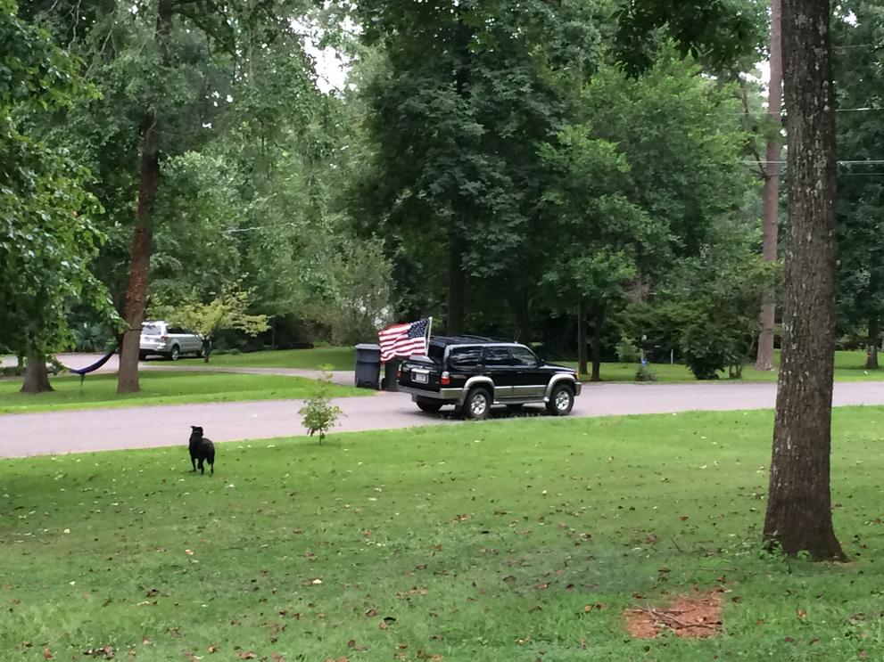

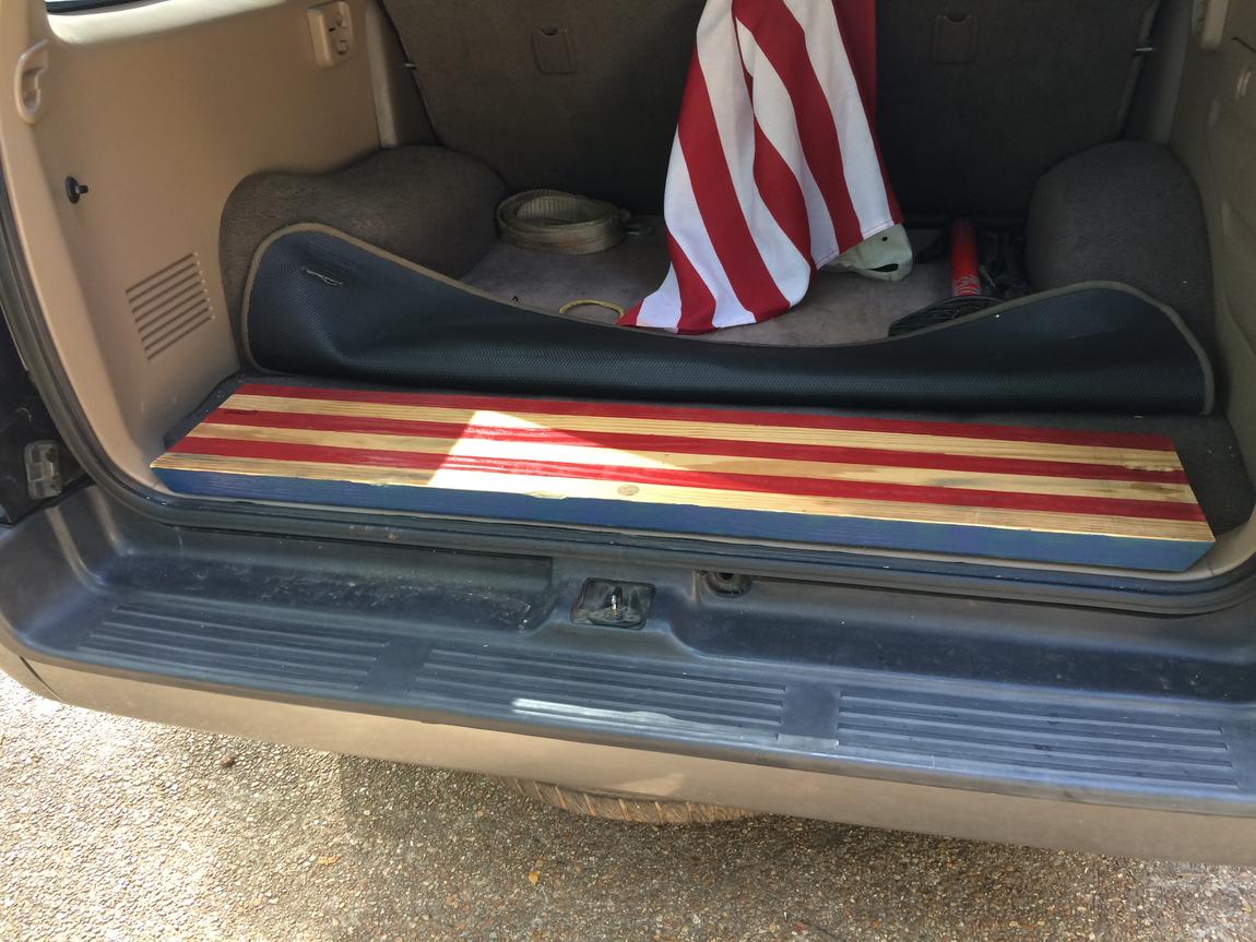

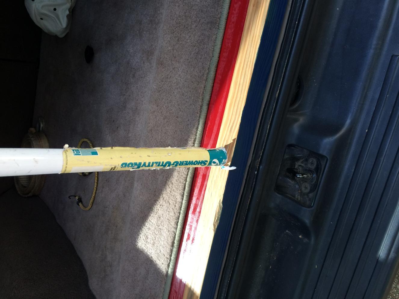

A little project to finally solve the issue of flying a flag behind the 4R. Not sure why the second to last pic is sideways...
You can see where I had drilled two holes where the tie-down hooks are. Then I drilled another smaller hole where I can run a pin into the wood and through the hook to keep it from bouncing around.
1in hole in the front to hold the pole and Im done!

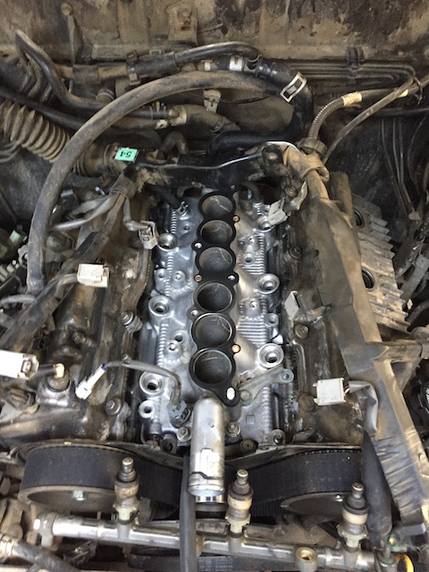

My valve covers still look like trash. I have no idea how to get those things clean. I got the lower intake clean by spraying about a 1/4 can of Gunk Engine Degreaser on it, then waited the prescribed 15 minutes scrubbed with a stiff bristle brush, then washed off with the garden hose.
After that I spot sprayed with the green can of brakekleen and brushed a little more.
I had to do something while I waited for 1 lower intake gasket to arrive. I thought I had 2, but could only find 1 in the garage. :(
That thing is so clean it almost hurts to look at. Parts washer? All I want to know is how is there still what looks to be the entire stinky plastic wiring cover? How is that even possible?
All I can say is that 30% of it is black electrical tape and the other 30 percent fell apart when I attempted to re-attach it. I was just going to ask if someone sells an aftermarket wiring harness holder.
