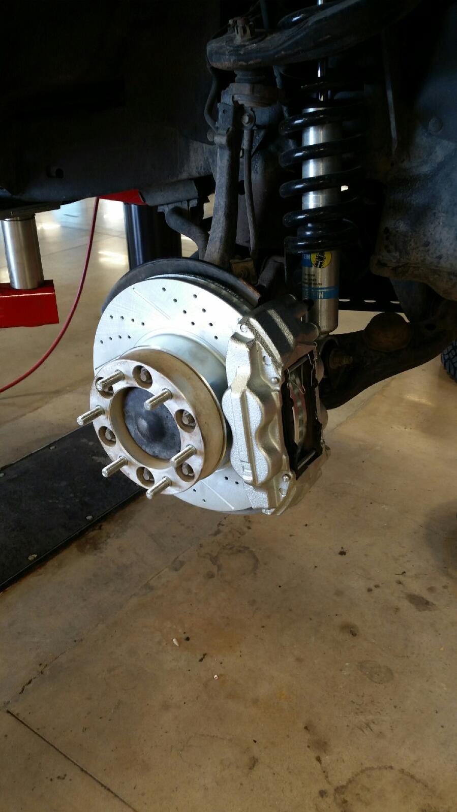

Tundra Brake Upgrade
I finally decided to pull the trigger on bigger brakes. 231mm 13WL Tundra Brake Upgrade !!!
