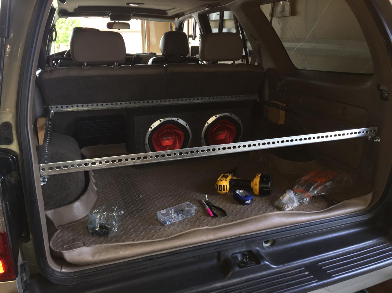

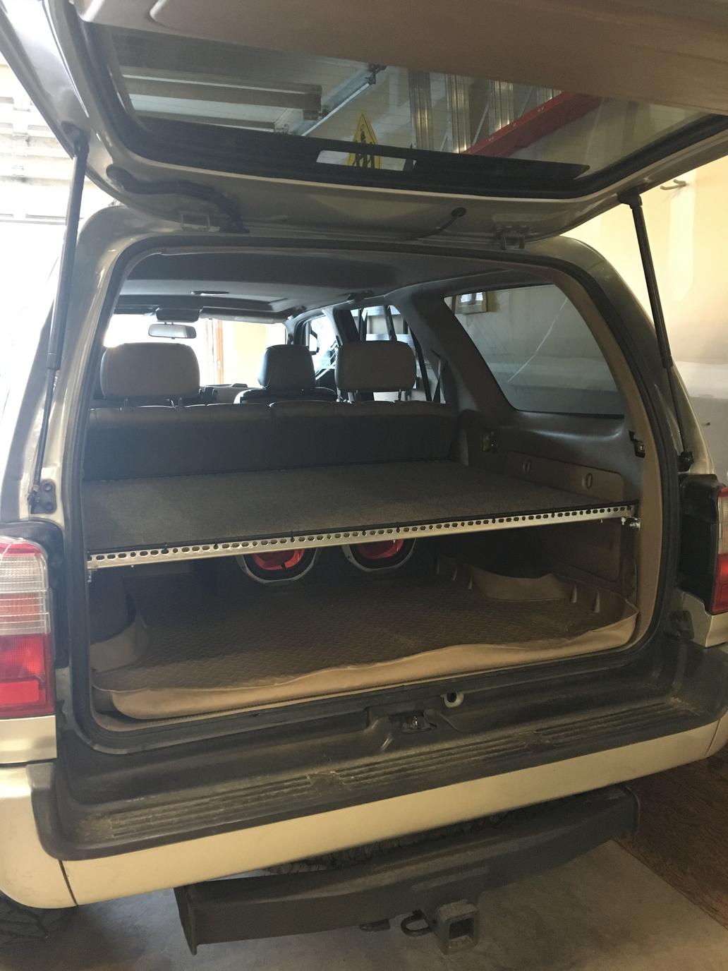

Rear shelf
Built a rear shelf this weekend.
Not as pretty as some I've seen on here but pretty functional and under $30 or so.
Used pre-drilled angle iron so I'd have something to hook bungees to to secure stuff. I covered the exposed "edges" in wire loom for looks and to protect from that semi-sharp edge. Overall it covered the subwoofer box and I put high enough to get some specific size containers I have above and below. Built it so I can still get into my storage compartment and can take it all off with a few bolts. So much better for space. I can get all my wheeling gear underneath including my air tank, and still have the upper part for family luggage, ski gear and whatever.
This is pretty cool. Are the rear portion bolts (next to the lift gate) embedded in plastic only? Or did you find some metal to bolt onto?
Ya just the plastic it was easy to access behind there by just pulling that panel a bit. I used some big washers on both sides to give it support but between the large diameter (but short length) bolts and the big washers on both sides clamping the plastic, it's VERY stout overall.
I thought about putting some "legs" in the corners instead of going through the plastic but it didn't seem to gain me much as this is so stout and I don't plan to carry much more than 50-80 lbs on it though I think it could support a lot more. Even the little wood "legs" I have on the wheel wells aren't really needed. The angle iron is stout and I used 3/16" plywood covered in carpet which is more than adequate for the weights I'm planning. I didn't even have to put in a center ridge. But again, all the heavy stuff like my CO2 tank, recovery gear, tire chains, etc. and all go underneath.
I did think about drilled aluminum sheeting for the actual platform instead of the wood but wow is that stuff expensive. So carpet covered wood it is. I did take the time to round the corners on the wood and sand all the edges etc. first.

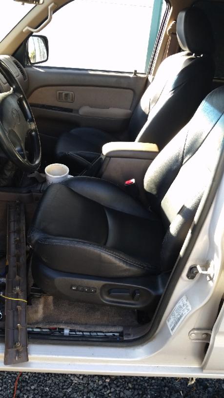

Finally got my comfy seats in
Next will be to figure out hooking up the seat heaters.
